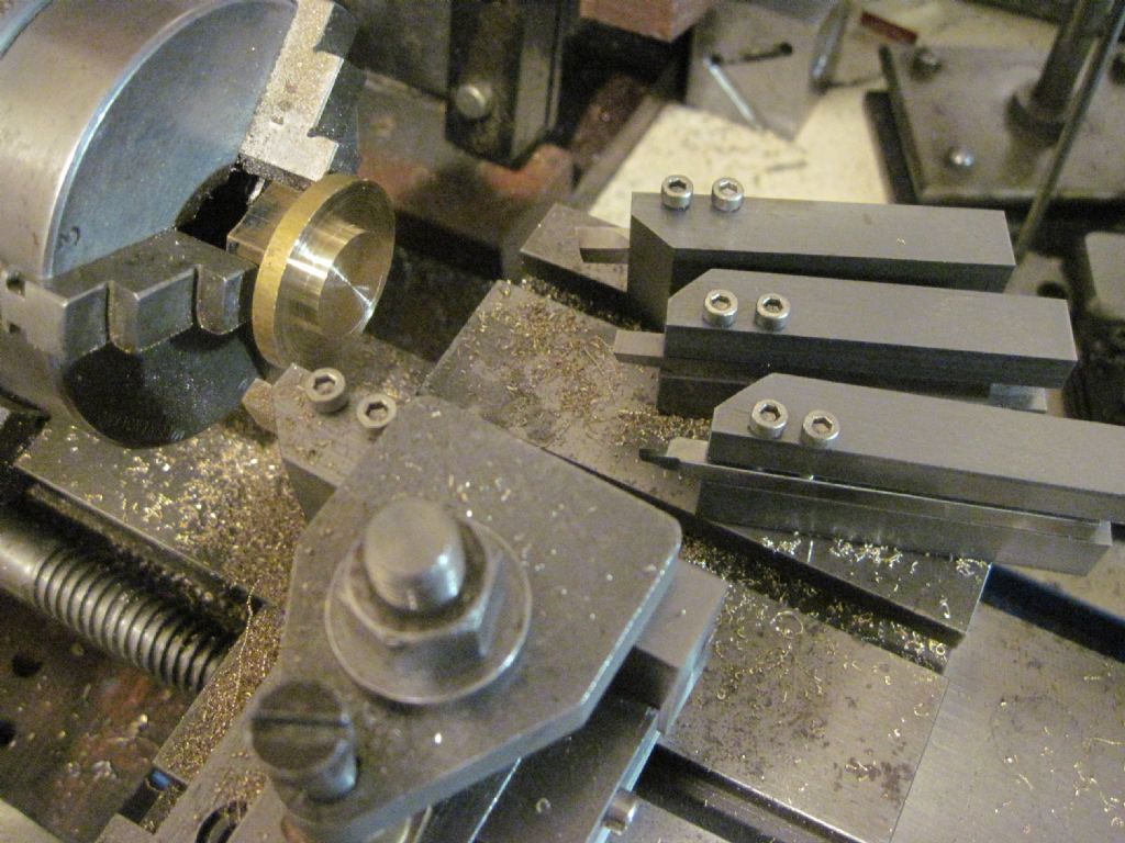

                          Well, on the Myford a Diamond tool holder does a great deal of my day to day work, the main reason being that it's very simple to keep the tool sharp.
                          On my small EW I use 'Rose' blocks generally and (like yourself) decided that 3/16th HSS was quite robust enough for that lathe. One thing I do not bother with however is back rake. I have tools for both steel and brass. The former have side and top rake, the later just side rake. The first grind is such that I keep the cutting edge level with the top surface of the tool – obviously easy with the brass tools as they have no top rake but a bit more care required for the steel cutting ones.
                          Once you have this then the tool is simply sharpened (in it's holder) on the front face, the wheels' curve giving front clearance. It's quicker to do than even a 'diamond' tool and cutting height is not effected. The only variable is how much angle to put on the front face and usually I put very little on (just enough for clearance) as this gives a stronger cutting edge. They are lightly stoned to round the front leading edge.
                          It may not be too obvious in the photo below but the top (furthest away) block has a l/h steel tool and the middle block a r/h brass tool (so the side clearance is on the camera side). The bottom tool was used to trim plastic btw. I do grind special tools but these 3/16th ones work well for most jobs on the EW. So not what the books say but it works for me. A quick and convenient way to keep tools sharp.
                          Regards,
                          IanT
                          Rose Blocks

                              Nice job Ian, those holders look very smart. wink

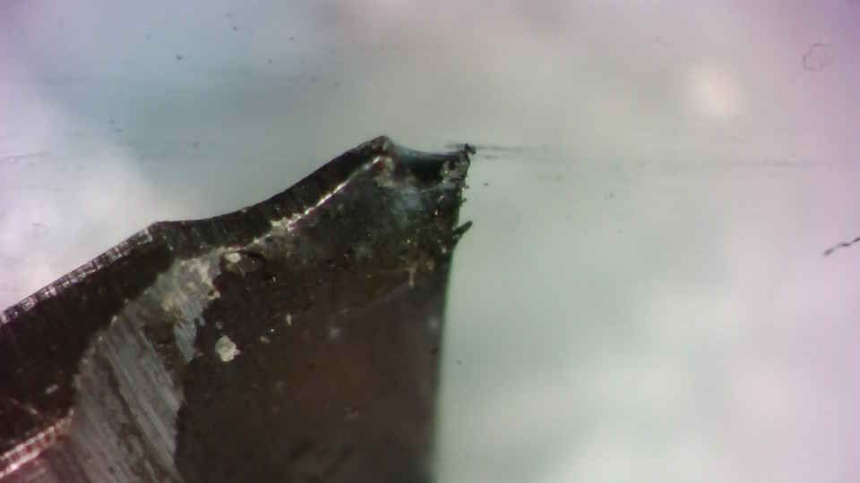

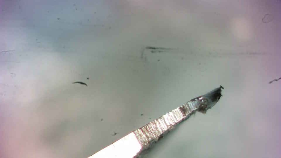

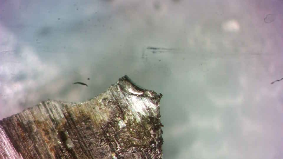

                                                As an example of my issues, here are some pictures of a very fine tipped toll I ground, put to work to cut 3 grooves.
                                                Sadly I don't have any before pictures, but the profile was reasonably square from the top and of course there was a point from the side. The end flat was originally about 0.35mm – the images are considerably enlarged!
                                                In this case this end is the opposite end from the pointy end of a parting off blade which I'm reasonably sure was sourced from ARC and thus should be of decent quality.
                                                All three cuts were in stainless. The first in 304 the last (when I noticed the quality is of uncertain consistency.
                                                I expect that the tip got to blue temperature at some point in the grinding process.
                                                Any idea what I can do to fix this?
                                                Many thanks
                                                Iain
                                                #632278
                                                  Posted by Dave S on 06/02/2023 15:08:37:
                                                  I have heard the micro crack theory, but not seen it happen. Dunking a piece of red hot silver steel to harden it doesn't tend to cause issues, so I don't see why a much cooler piece of tougher steel would fail.
                                                  I suspect that the micro crack 'myth' (going to call it a myth for now) propagates from the cemented carbide world – where certainly older carbides were prone to premature failure if the coolant supply was intermittent.
                                                  Difficult to see microcracks because they're too small. The effect they have is rapid wear, not catastrophic failure. Plenty of cracking to be seen on TV's Forged In Fire programme.
                                                  Not so sure overheating whilst grinding is a myth either. Although the body of an HSS blank is unlikely to get red hot, the point, edges and surfaces in contact with the grinder have much less volume and could easily get much hotter. Notice any sparks? The fine fragments of HSS cut off by a grinding wheel can get hot enough to catch fire.
                                                  Overheating and microcracking probably only damage HSS near the edge at the hot end, so gently removing a couple of millimetres should get back to safe metal.
