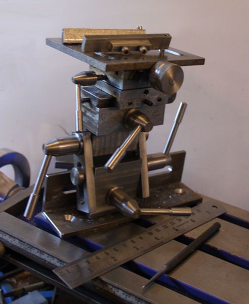

                    Hi Wolfie,
                    HSS is an excellent choice for lathe tools. It is cheap, easy to grind to shape, rarely breaks or chips, can run hot and cuts beautifully. I have gone back to good old HSS after a few months using indexable carbide tools. Some swear by them but HSS (and high carbon tool steel such as silver steel) has been used for many years by some of the best. Once you have the basic shape and angles ground they are very easy to touch up with a small oilstone (slipstone) from time to time, even still mounted in the toolpost. A simple grinding rest is adequate but Harold Halls is very good but you will need to fit a cupwheel to one end of your grinder. I managed without any modification, just remove the guards and wheel from one end.
                    Also as Russell says, carbide tools are harder but not tougher than HSS and as he says are very easily chipped.  Remember toughness is not the same as hardness, carbide is like glass, very hard but brittle, HSS may not keep it's edge as long as carbide but as I said, is very easily touched up by honing with a slipstone in situ.
                    As for shapes and angles, Sparey in 'The Amateurs Lathe' shows the three basic shapes needed. Here is a copy of part of his sketch:
                    A) is a right hand knife tool
                    B) is a 'corner tool'
                    C) is a round nose tool and
                    D) is an example of a knife tool used for brass, you should have a round nosed and corner tool as well for brass (and CI)with the same reduced top rake.
                    The angles are not critical but it doesn't hurt to get as close to the theoretical ones as possible. I would add a LH knife tool as well.
                    There are others but these shapes will manage for 90% of any work you do. Here is my version of the HH grinding rest before it was damaged in my garage fire:
                    Grinding rest
                    I have since managed to resurrect the poor thing
                    Best regards
                    Terry
                    Edited By Terryd on 16/07/2012 15:53:46
