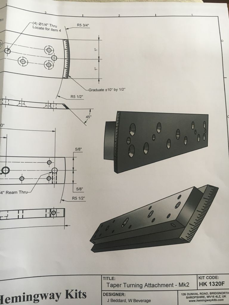

      I have the Hemingway Taper Turning Attachment (not the one that offsets the tailstock). However, the instructions give little advice on how to put the ‘coarse’ graduations on the end of the guide bar. These graduations have to be made at a 45deg angle on the end of a bar around 11.5” long at a radius of 5.75”, engraving from large to small radius, as shown in the drawing below.
      I’d be really interested to know whether this can be achieved with a small milling machine (Sieg SX3) and rotary table (I don’t yet have one, but intend to purchase a 6in one).
      Any advice gratefully received.
      Many thanks,
      Mike

          I must say that given the difficulty of making this, which would seem to need a way to hold a dividing head at a 45* angle, I think the design is not very well though out. I'd be inclined to machine the arc vertically on the end of the bar and put the scale on the top surface with a small block for the fiducial mark.
          But actually, is the scale likely to be very useful?  You could always use a protractor to set the angle.

            Thanks for posting the picture, Mike
            I nearly made a suggestion when you asked the question on the other thread … but it is now evident that I had mis-interpreted your text.
            I am definitely with John on this
            As drawn, it is a very poor piece of ‘design for production’

              I'm with John Haine and MichaelG on this, but if you are determined to follow the original design, as a temporary measure, you could print the lines on clear decal printing paper sheet and cut it out to apply it to the surface. I did this when I made my simple indexer, for the 10° marks on the "vernier" wheel. Here's how it turned out:
              Numbers stamped-printed
              The lines were put on with an engraving tool in the mill – it's the numbers that are printed. In you case it would involve a bit of jiggery-pokery in CAD to get the wrap-around shape, but it is doable.

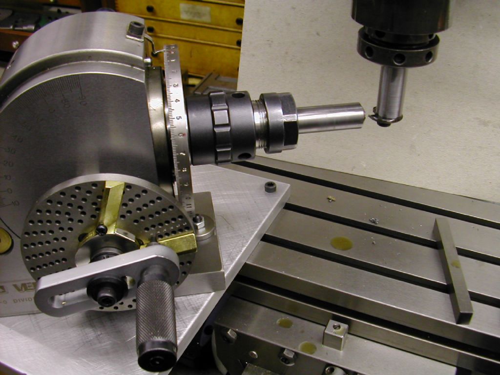

                  Whilst I agree this is not the best of design from a manufacture point of view if the rotary table can be mounted vertically as some can or against an angle plate (as I do for similar instances) then it should be easy enough to do if the mounting of the RT can be swung across the table at the desired angle. A rotating single point cutter should do the job as long as everything is set on the RT centre line.

                    Mmmm.. ..oo.. ..er.. I see the SX3 has a tilting head.. ..so can you mount the workpiece flat on a R/T and side-mill the ends, then lock the spindle and use the quill feed to 'plane' the divisions with a single point tool whilst still in the same setup..?
                    ..it'll be a bit iffy, also you might need to do a dry run and see if you have room…
                    ..maybe a tooling plate / inventive supports to firm it all up..
                    EDIT – looking at the drawing, maybe you could use the upper 'beam' as a support for the machining by temp. re-attaching it below.. ..or something..

                      Using the tilted head would be another option – I don't have that luxury on my Linley. Were I to do it the RT would be mounted vertically and set to one axis of the mill at the required angle to match the angle on the part.
                      The workpiece – plate – is set horizontal on the C/L of the R/T with the radius and angle pre machined and set such that the radius matches the arc of rotation. The cutter is set dead on centre height and the grooving done as if cutting a gear by moving the relevant axis, depth of cut provided by the other axis. If the spindle can be locked (not usual I agree) then the cutter can just scribe the work.
                      Not an ideal set up I agree too but something that can be done.
                      Tug
                      PS just found this – similar to this set up for cutting bevel gears
                      Div Head set a an angle to axis as suggested – as you can see a sub plate was required in order to enable this to be achieved
                      Edited By Ramon Wilson on 07/11/2022 13:56:01

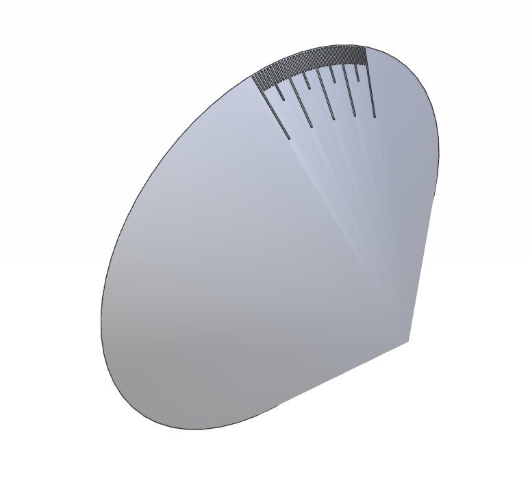

                                  Like a dog with a bone, I'm back! I created a pattern of graduations on a 45° cone in Alibre Atom:
                                  conical graduations
                                  And there it stumped me. There is an add-on in Alibre Expert which will convert that 3D shape to sheet metal – i.e. "flatten it out" – but this is not available for Atom. I tried exporting it as a STEP file to Fusion 360, but – guess what? – you have to upgrade to get the sheet metal conversion function. So it can be done, but other, better, solutions have already been postulated. This was just an exercise for the grey matter from my point of view.
                                  Edited By John Hinkley on 08/11/2022 10:44:47

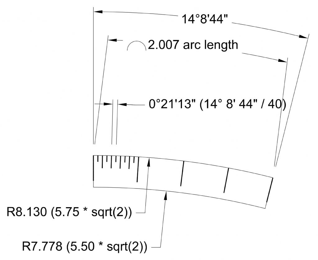

                                    As an alternative to 3D CAD that you have to pay to upgrade, please consider this low-tech method:
                                    O-level technical drawing with a sheet of paper, a graduated straightedge and pair of compasses would get you a development of the cone. A bit of trigonometry would tell you the included angle of this development. This included angle represents the circumference of the cone base.
                                    You can then work out the chord length for 1 (or 5 or 10) degree(s) around it and step off with dividers. This is the only fiddly bit of the process and where simple and free 2D CAD would assist. Join each of your pricks to the vertex for the lines.

                                        As the atom-ic sledgehammer has not cracked this nut, please see below for development of cone, which would allow the scale to be engraved on the flat:
                                        Note that the 2" width on the drawing is very slightly over 20 degrees included angle, so the outer graduations will not coincide with the edge of the metal.
