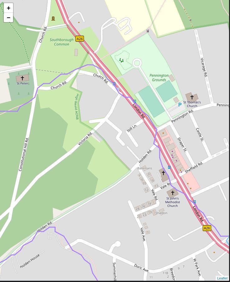

                                                    A few years ago I built a GPS device using a UBlox NEO-6M receiver because I'm hopeless at remembering to write down my work hours. The device used an accelerometer to wake up when moved and record it's position every 10 seconds. I can then enter the data it saved into a Python program which displays it overlaid on an OpenStreetMap map and identify the time I went home.
                                                    Now, its important to bear in mind that the NEO-6M is quite old now, and I was using the (probably very cheapo) antenna which came with it, but looking at a track recorded when walking (during Lockdown 1 last year) you can see the track jitters about quite noticeably:
                                                    Surprisingly, I can walk in a straighter line than that.
                                                    I think with this amount of randomness, a momentary reading of speed is not going to work, though the more data points you can average, the better its going to be (I used a reading every 10 seconds, the largest time interval the NEO-6M allows, to reduce power consumption, and prevent the track file size becoming ridiculously large). The track above is drawn from the raw data points, with no smoothing.
                                                    Incidentally, I also tried taking it with me on flying lessons a couple of times – it recorded the track alright (interesting to see how close, or not, the track of one circuit is with another), but it was hopeless with altitude – I believe you need a GPS unit specifically designed for it to do that.
