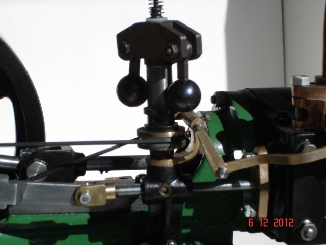

        I am having problems finding a belt that will spin the governor, all the things I've tried just slip, the worst being a belt used on the Mamod models. The governor spins ok as its got a ball bearing in the base so no tight spots.
        I've tried nylon sting with a small knot at different tensions, a rubber band seems to work but judders. Dental floss is about the best I've come up with but that gives up after 30 seconds.
        Any help please will be appreciated Bob.

          Could you post a photo of the belt in place please? The way belts run & relative size of pulleys can both make a difference. ( I guess the belt sits on the horizontal flywheel and crosses over to drive the vertical governor, in which case the ratio is probably the problem. )

              Drive comes from the small pully that can just be seen from behind the flywheel, probably about 2:1
              The Mamod belts run in round bottomed grooves as do the larger but similar spring type found on Stuart engines.

                      I see the pulley now Jason's pointed it out. 2:1 is OK. How about the angle though? Perhaps it's the photo but the governor pulley looks high to me, perhaps putting the belt at an awkward angle.

                        I've up loaded two more photos on my album on Mill engine governor for angles of the belt Dave. I've not finished the valve part yet, it mite work. I've made two of these and got them to run of a nebuliser, another good source of air power for small engines. Also the Mamod belt moves ok on the drive but not the governor.

                          Might I suggest dropping the governor pulley height, looks a tad high to me and the edge of the pulley is forcing the belt off also put a matching groove in the drive pulley.

                            Yes, the governor pulley is too high, the belt is wasting energy trying to force the pulley downwards to level the drive line.
                            If the pulley cannot be lowered then consider making some idler pulleys to raise the drive line.

                              The pictures tell the story The alignment needs to be addressed as Brian and George point out. The belt on the top of the crankshaft pulley needs to be parallel with the centre line of the engine and parallel to the horizontal center line of the engine.
                              Photos Two and Three in you Album explain the anomaly in the alignment.

                                      I made a new pulley for the governor with a rounded groove and it now works well on the Mamod belt. The drive has still got the flat groove but as it works I wont make a new one. Another bonus is that it has not added any more resistance so it will run on the nebuliser.
                                      Again thanks for the replies, Bob.
