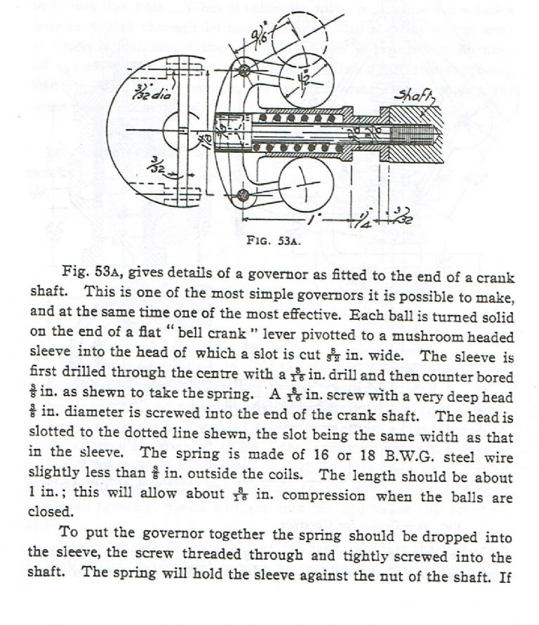

        I am to make a small Governor the Muncaster type, I found the drawing under steam model 8, discussing governor and control gear. What I don't understand is the drawing of the governor lower sliding yoke which is attached to the leaver, It shows the lower yoke attached to the leaver by a spigot, if that is so then how will the spinning action work then raise the leaver. I've looked on the internet for a detailed drawing which would explain this but cant find any.

            Bob, I assume you are looking at the Westbury series of articles about teh Muncaster engines. If so his drawing does not show the governor as it is in Muncasters book, the two right angled levers push against the head of the spindle and move the whole thing away from the end of the shaft that the spindle is screwed into. Will post a pic for you later.
            #352670
              Here is the better drawing from Muncasteres original book which is still available from Tee Publishing for about six quid.
              Hopefully you can see that the screwed in spindle has a larger flat head that the two governor arms push against. This will cause the whole sleeve/spool to move up the spindle away from the shaft that it is screwed into. If still not clear let me know and I'll see if I can do a 3D one.

                The drawing I was looking at is on Brian Sweetings link on page 779. The lever on the lower yoke on a spigot, its more than likely me not understanding the drawing.

                  OK its the other governor. The lever pivots on the central boss, the rod on the right hand end goes to teh steam valve. As the spool (part with the groove and lower ball arm fixing) moves upwards that moves the left end of teh arm.
                  There are a few ways the arm locates in the spools groove. If you look at the previous page there is a ring with a cut out making it into a "C" shape, this slots into the groove and the two small spigots either side go into holes in the left end of the lever.
                  Another way is to have a forked end to the lever with two pins that face inwards and locate into the groove.
                  Or the other way is to h ave the lever off to one side of the vertical governor shaft and a single block that runs in the spools shaft, stuart governors are like this.
                  Edited By JasonB on 03/05/2018 16:34:48

                    I've got it now, going to make one of those.
