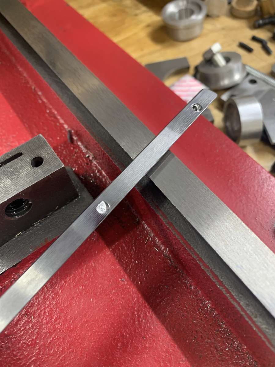

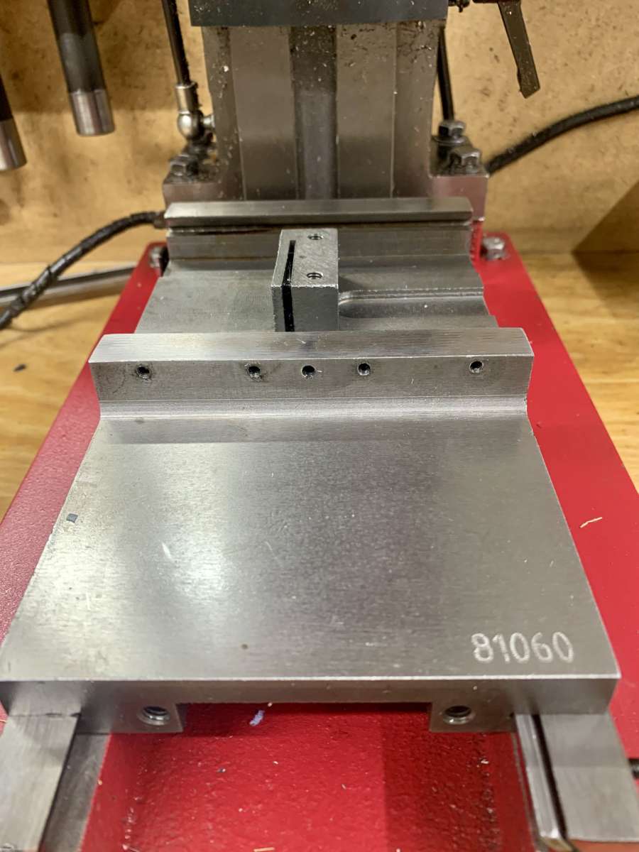

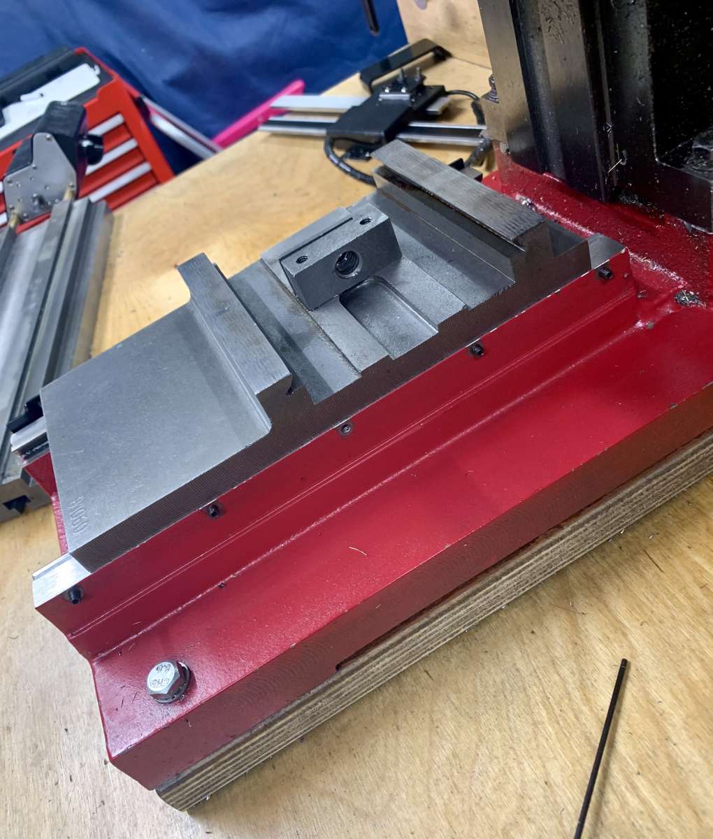

              Dr_GMJN
                @dr_gmjn
                Thanks all. Plenty to re-read tonight.
                This evening I succumbed to the inevitable and stripped the tables and cleaned everything down.
                I’ll de-burr all the ragged edges just to make handling the castings less dangerous, then decide what to do.
                I experimented by putting the domed screws in the Y-axis and temporarily assembling and adjusting the slider. Pushing it back and forth by hand resulted in random, quite severe binding. Not sure what it would be like with the original cylindrical ended screws. I’ll try the tomorrow.
                Does anyone know why the x-axis has domed screws, and the y-axis had cylindrical screws? Neither axis has the divots machined well enough for it to have any obvious effect when interfaces with the screw ends.
                Anyway, I ordered a 3mm ball mill, so I guess I’ll end up sticking with plan A which was to clean up the divots in the pillar drill, in conjunction with a printed angled jig. Is the dovetail angle standard or should I measure it?
                I’ll use the end cap method for laterally locating the gibs. I might add small grub screws and lock nuts for fine adjustment.

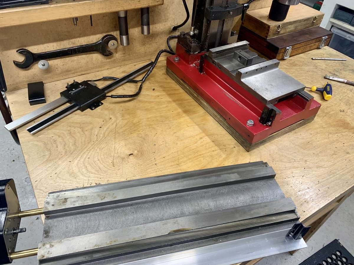

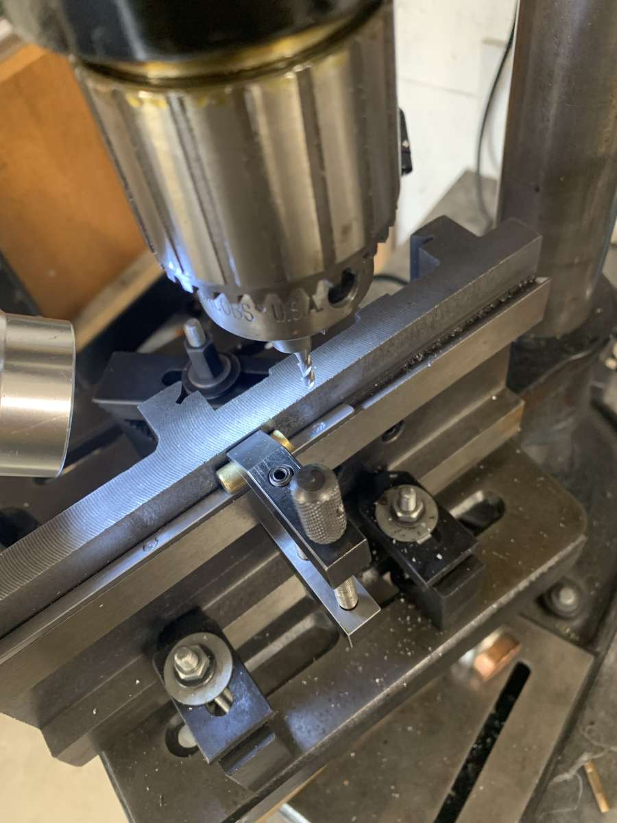

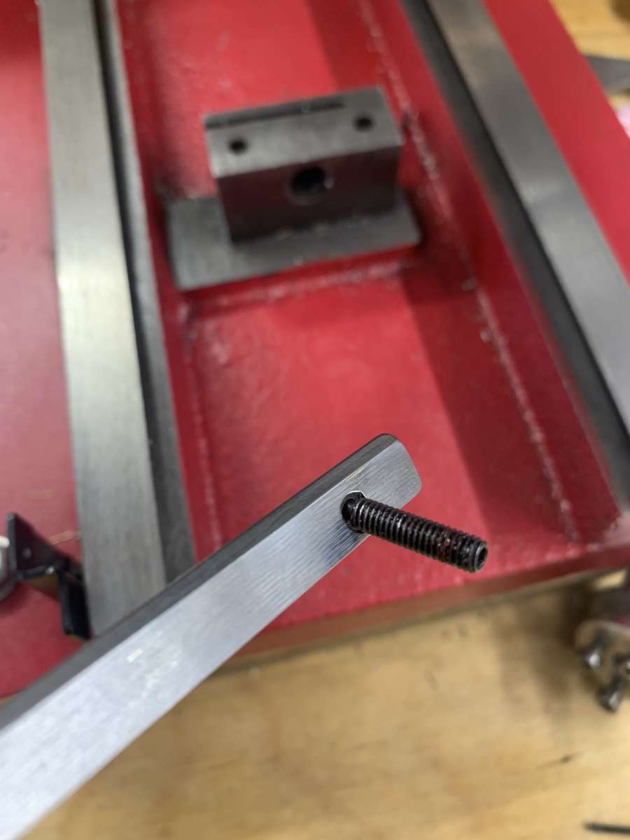

                                    I didn’t bother waiting for the ball mill to arrive, I opted to mill flats on the gibs and be done with it. I turned a point on an M4 grub screw and screwed it into all the gib holes in turn to mark them.
                                    I used the x/y table thing as a jig, and milled the flats in the pillar drill:
                                    IMG_7354
                                    IMG_7355
                                    I drilled a step in the ends of each gib to locate the stepped grub screws rather than mess about with end stops:
                                    IMG_7356

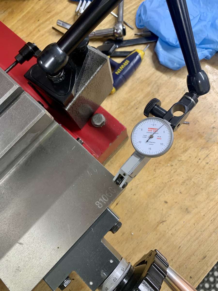

                                    That’s the short version, the flats ended up slightly misaligned in four positions so some re-work was needed.
                                    I rebuilt everything and the best compromise between wheel stiffness and play (which is still a very poor one) is about 0.003”. I guess it should be less, but it is what it is.
                                    IMG_7359
                                    While doing this I wondered (not for the first time) why the y-axis has to be extended outwards by about 1/3 of its travel before the spindle is over the centre of the x-axis? Seems a bizarre design.
                                    Anyway, sliding the axes back and forth by hand doesn’t now seem to give any stick-slip, However adjusting the gibs for minimal play and fitting the hand wheels puts me almost right back where I started in terms of feel. I would say by the time I’ve re-fitted the DROs, the feel of the wheels will be back to the same horrible sticky mush it was previously, so basically it’s been a bit of a futile exercise.
                                    Suppose it could be something to do with the lead screws, but I’m not getting into that, I’m done with it.

                                          I’ll be re-building it tomorrow.
                                          what play should I be aiming for in the two axes, and how should it be measured?
                                          Subjectively how much load should I be applying (and where) when checking for play?
                                          I suppose in practice load is never applied in the way that rocking the x-axis with it fully extended would?
