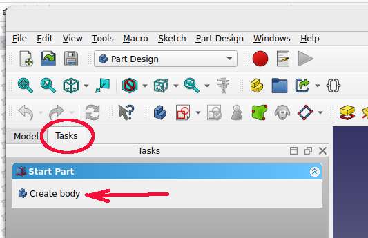

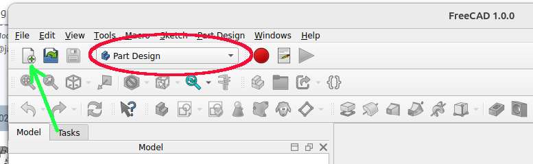

                                  Try this:
                                  Open FreeCAD, select Part Design (Red ring), and click “New Document” (Green Arrow):
                                  frrecad1

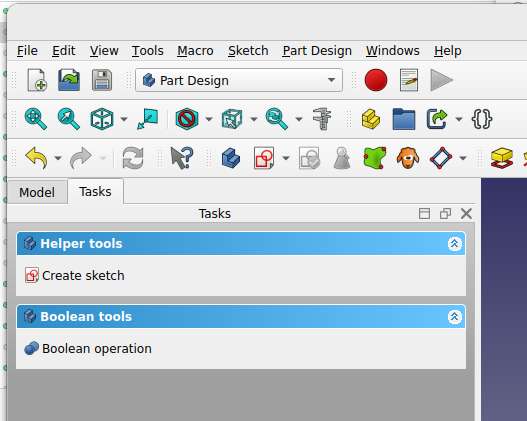

                                  If not already selected click the Tasks tab (red ring). It should list a “Create Body” task (red arrow), click it.  Note: behind the scenes all 3D CAD packages depend on a “body”:  it’s the foundation on which the model is built.
                                  freecad2

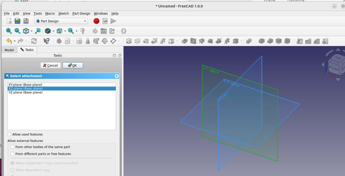

                                  After the body is created, the Task panel lists “Create Sketch”, click it.
                                  freecad3
                                  The Tasks panel changes to “Select Attachment”, one of the three XYZ planes.  I’ve selected XZ.  (Before a sketch will pad or anything else 3D,  it has to be attached to a plane or a surface.  Advanced users are allowed to create sketches in isolation and attach them later; this may be Michael’s mistake.
                                  freecad4

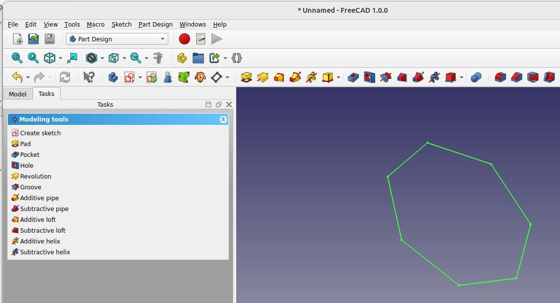

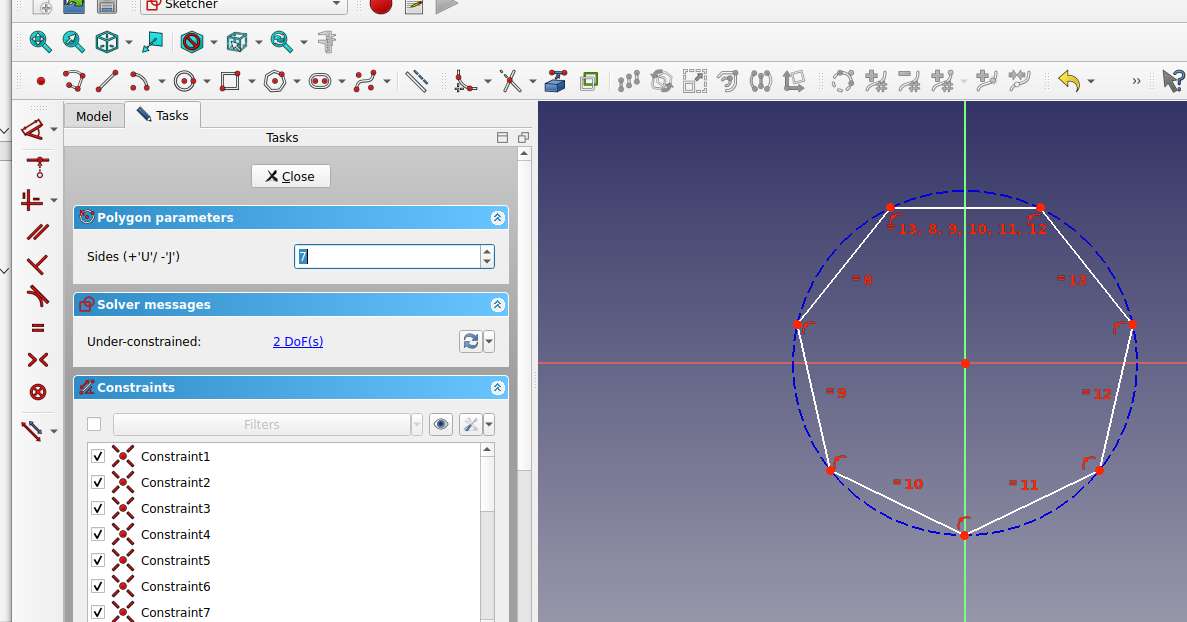

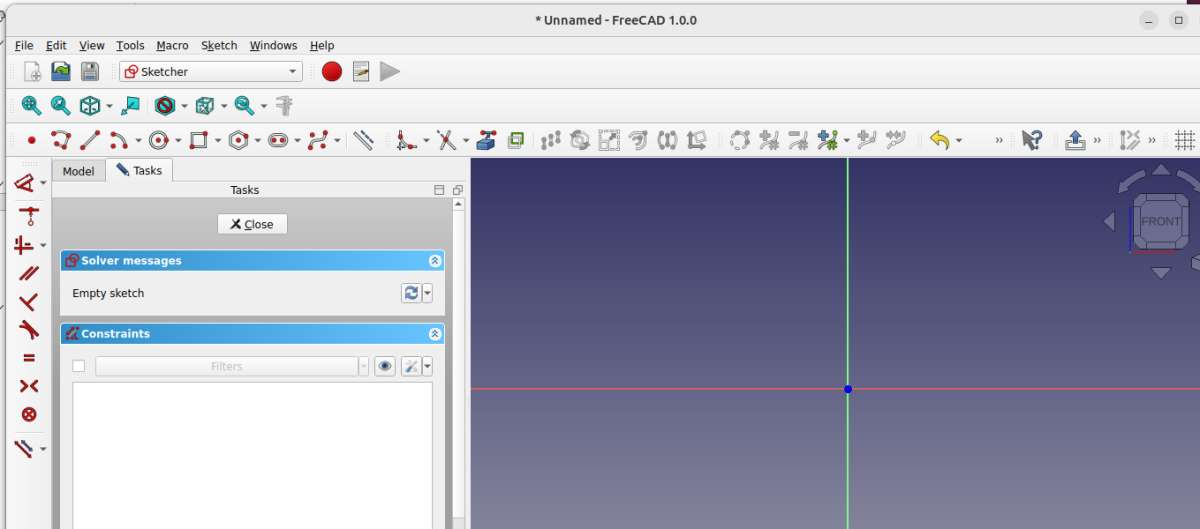

                                  I sketched a heptagon with the “Create Regular Polygon” button.  The Tasks panel now has lots of new information relating to the sketch; constraints, and a warning that it’s under-constrained in 2-degrees of freedom, i.e. the position or dimensions of the sketch are incomplete, not fully constrained.  Worth fixing in a real model because floating bits can cause trouble later.  I’m not going to bother!
                                  freecad6

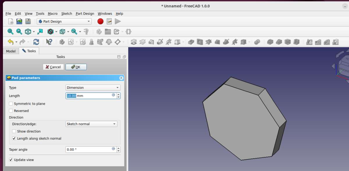

                                  Closing the sketch alters the Task panel again; the tools that operate on sketches appear, including Pad:
                                  freecad7
                                  Clicking Pad produces the expected result, with a dialogue allowing attributes like depth to be changed:
                                  freecad8
                                  The 3D heptagon has 9 faces on which further sketches can be attached, allowing the draughtsman to create objects of arbitrary complexity.
                                  The sequence may seem complicated but it only takes a few seconds to apply in practice.

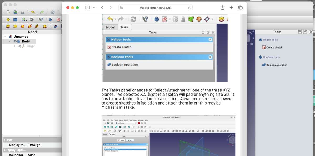

                                      freecad3

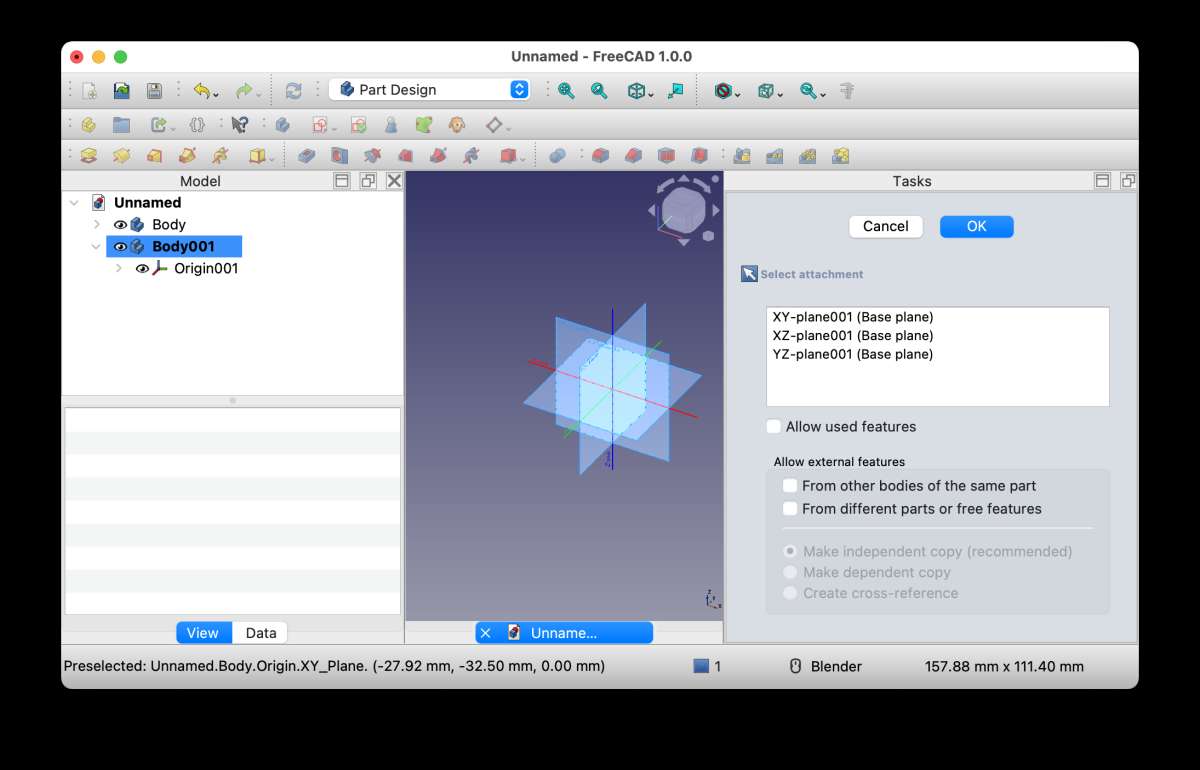

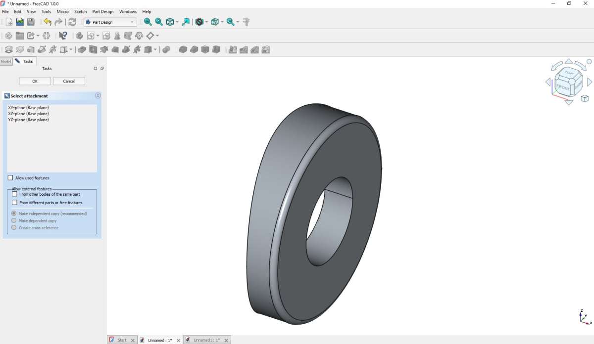

                                      That appears to be the step at which things start going wrong, Dave
                                      … it doesn’t do that ^^^
                                      Screenshot 2025-05-08 at 14.52.37

                                        Must admit when I tried it for the first time this morning I did not do any of Dave’s first three steps. Just clicked the sketch tool, chose the plane and then the circle tool, etc
                                        #796922

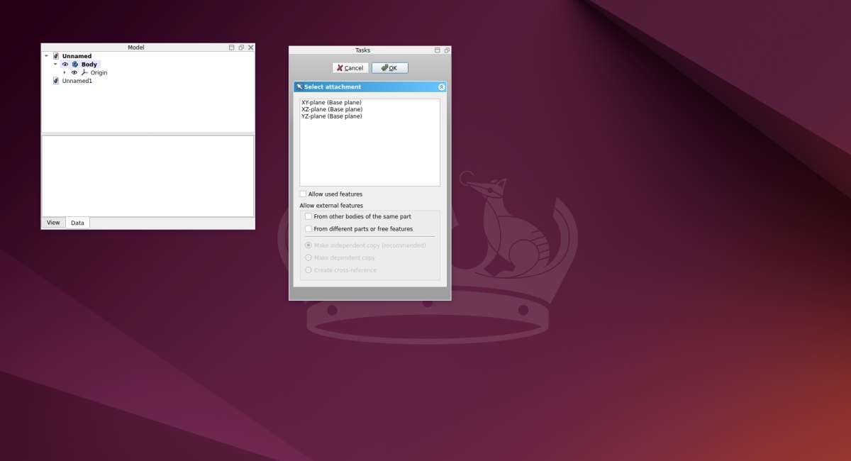

                                          What it does is this …
                                          Screenshot 2025-05-08 at 15.40.28
                                          [display area reduced to avoid posting big images]
                                          So perhaps we’re getting somewhere.
                                                So from that you need to select which of the three planes you want to sketch on.
                                                You can either click one from the list or click one from the image ( my preference) and then hit the OK button.

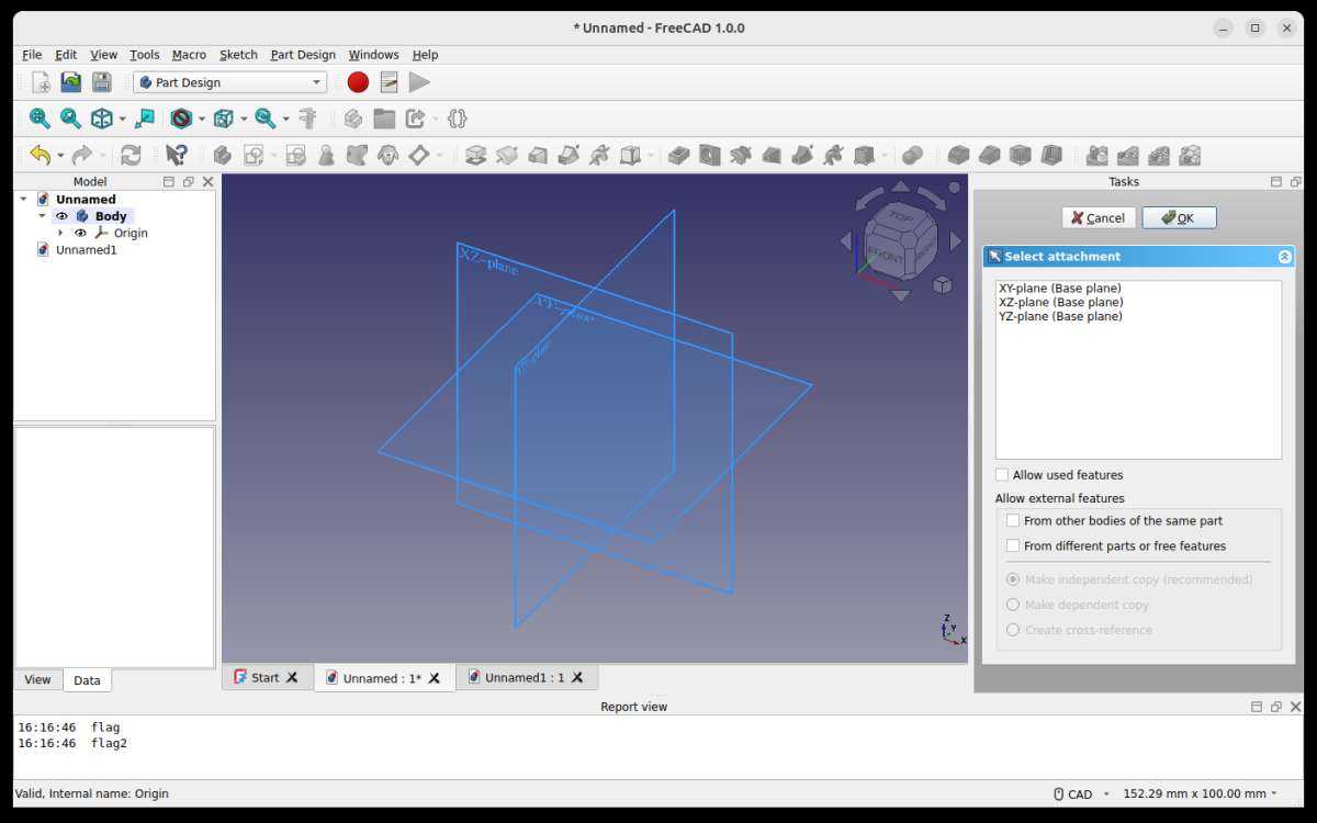

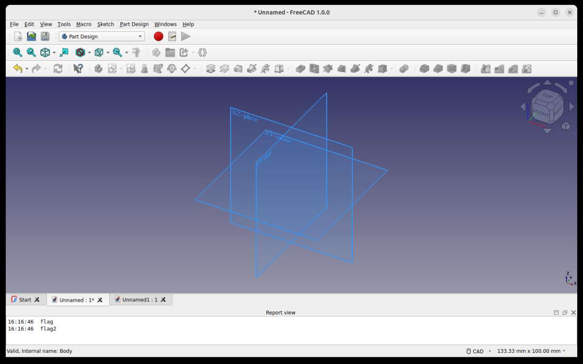

                                                  OK, the Task Panel has been located on the right of the main window, rather than in the default position.   Users can drag and drop panels to suit their preferences, the problem being the layout is unlikely to match any tutorial!  Instant confusion!
                                                  I changed my FreeCAD to look like Michael’s:
                                                  Screenshot from 2025-05-08 16-20-56
                                                  The difference is presentational:  though the task panel is on the right it still works as I describe.  Click on XZ-plane and then the OK button.
                                                  The advantage of moving panel is the user can see the Model Tree and Tasks at the same time.   The disadvantage is it eats screen space.  The facility works best with two screens or more screens, where panels can be moved to reduce clutter.  Here, one screen is used for the 3D display
                                                  screenone
                                                  Whilst the Model and Task panels are both on Screen 2.   Now I have loads of room on the main screen, but have to remember  where the panels are.
                                                  screen2
                                                  Reconfiguring the display is liable to confuse beginners! Advanced users can change it if they want.     Possibly the mac version is tweaked on delivery because the packager likes it that way, and didn’t realise the layout might disconcert beginners following a tutorial.    Getting a reconfigurable display back to default can be tricky too…
                                                  #796931
                                                    Having engaged ‘infinite monkeys mode’ for a while …
                                                    I have at last demonstrated that it can be done:
                                                    Screenshot 2025-05-08 at 16.36.45
                                                    < phew >

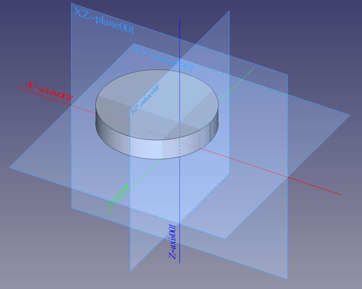

                                                      How I did that concave washer of yours.
                                                      First sketch done by selecting the plane from the list, second just clicking the plane on screen
