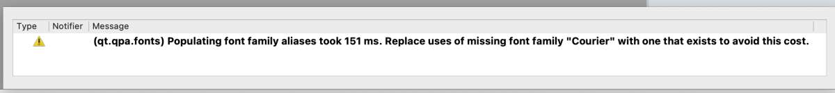

            A first interesting grab, for Dave
            This notification appears every time that FreeCAD is opened on the Mac
            Screenshot 2025-05-08 at 14.37.40
            It’s a known issue, and of course the lost milliseconds will vary according to the spec of the machine.
            … I have no intention of dabbling with Font substitutions !!

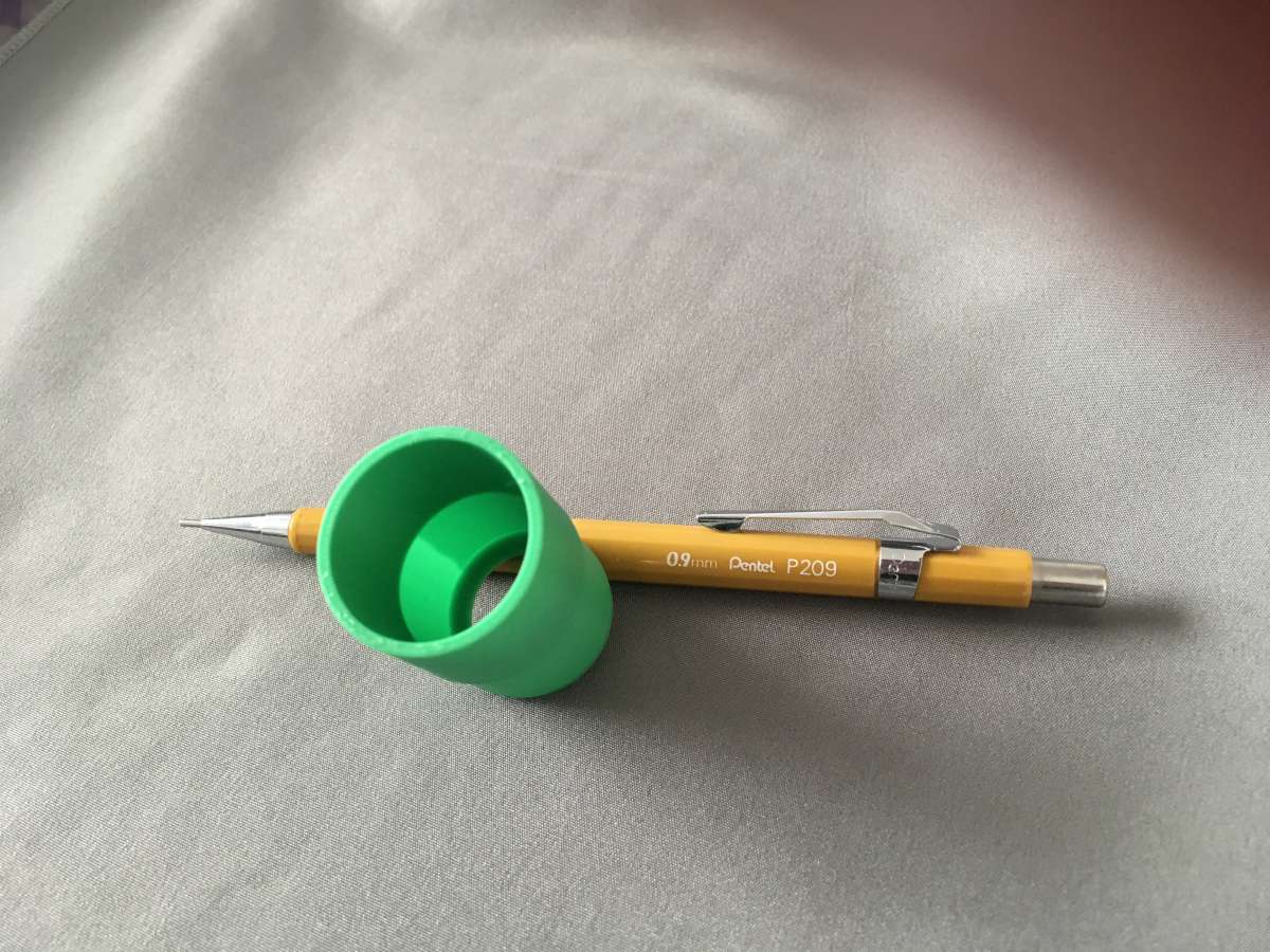

                          As proof of learning !
                          IMG_0764
                          The perspective is rather misleading, but this stepped tube has a constant diameter almost to the bottom, where the iris aperture is formed by the [virtual] 118° tip of the drill.
                          An enormously expensive little bit of plastic tube, thus far … but I’m on the way
                          Drawn in FreeCAD, Imported into Bambu Studio, printed on the P1S

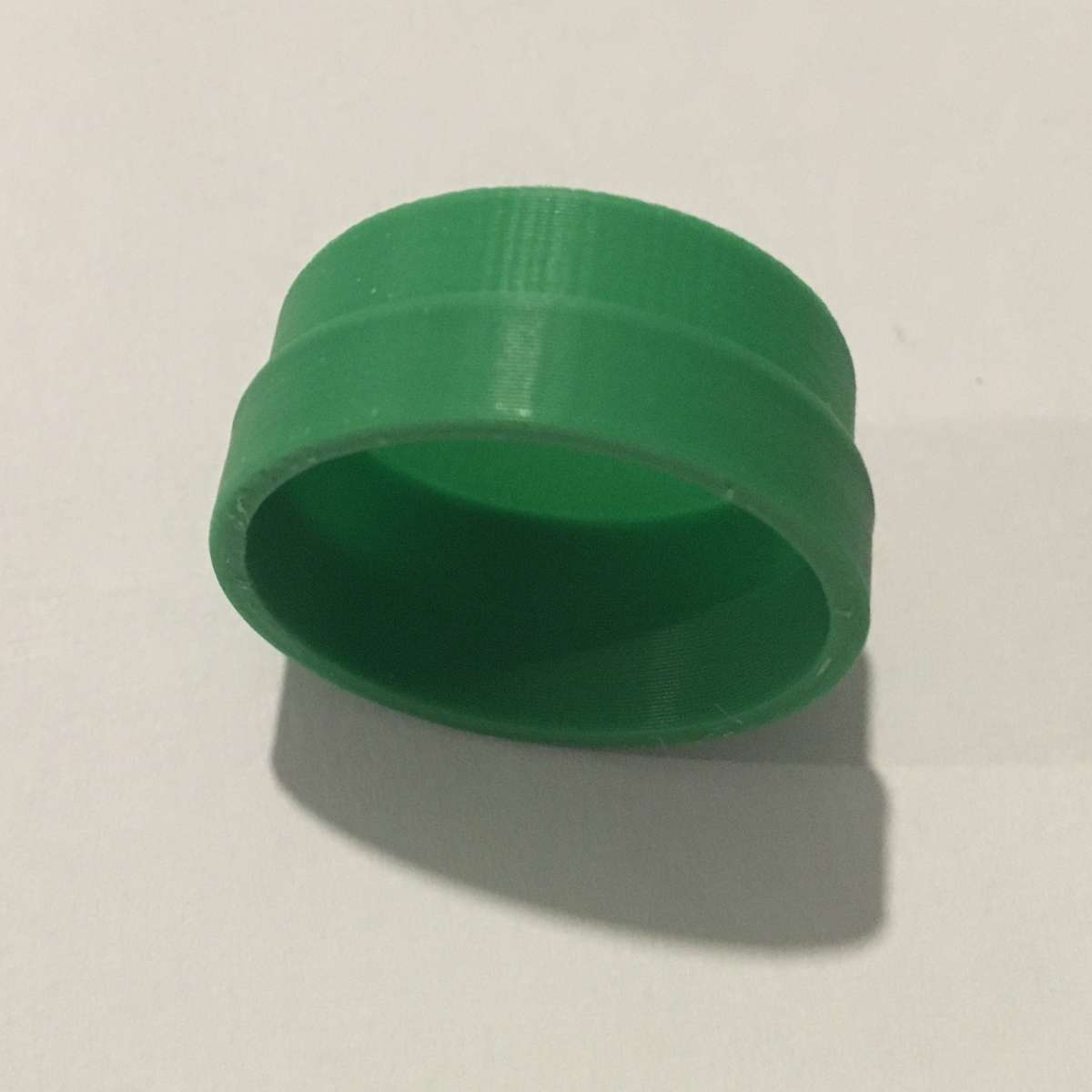

                            This little thing is the result  of a lot of work, a lot of mistakes, and a lot of lessons learned today:
                            IMG_0771
                            Nominal dimensions are:
                            Major OD= 27.1mm … Length =6mm
                            Minor OD =25.1mm … Length =6mm
                            Bore = 24.1mm … Length =11.6mm
                            This leaves a thin diaphragm on the end, as a good base for printing, which will be removed manually.
                            In case it’s not obvious ; it’s a simple adapter to mount a small camera.
                            The general principle will serve me well, now I know how to model it !
                            Per Ardua ad Astra

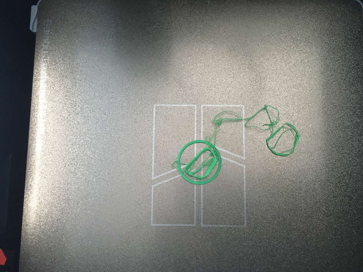

                                The adapter is looking like good progress. If you didn’t want to put the support diaphragm in the CAD model you can add it in the slicer (BambuStudio). Under the “Others” tab change there is a setting called Brim Type which controls the addition of a single layer around the part to act as a base. It’s probably set to “auto”, but I like to explicitly set it as needed.
                                Doing it in the slicer keeps the CAD model the same as the final part and a single layer brim is easier to peel off.

                                  … I did try adding a Brim, but obviously did something very wrong and produced this unholy mess:
                                  IMG_0766
                                  Thank heavens for the monitoring camera !

                                    Not easy to diagnose from a photo, but the outer ring appears to be still attached to the bed and the rest has lifted.
                                    Is the outer ring actually a brim or is it a skirt? (Skirts don’t attach to the model but simply lay down filament on the bed around the model). If it is a brim is the “Brim-object gap” set – if so reduced it to zero and try again. It sets a small gap between the brim and the object – meant to make it easier to remove – but it also tends to lose its grip on the object during printing.
                                    #797521
                                      Aha !  … thanks again Keith … I think it was a Skirt
                                      Must check the terminology more carefully

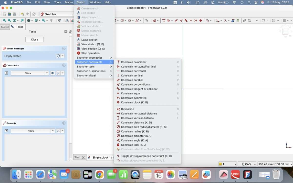

                                          All you clever 3D modellers may well laugh, but this video has probably saved my sanity:
                                          https://youtu.be/RVqxMeVGVlk?feature=shared
                                          I have spent hours today, simply trying to fully Constrain a Rectangle, and at last here’s someone who actually explains and demonstrates the process.

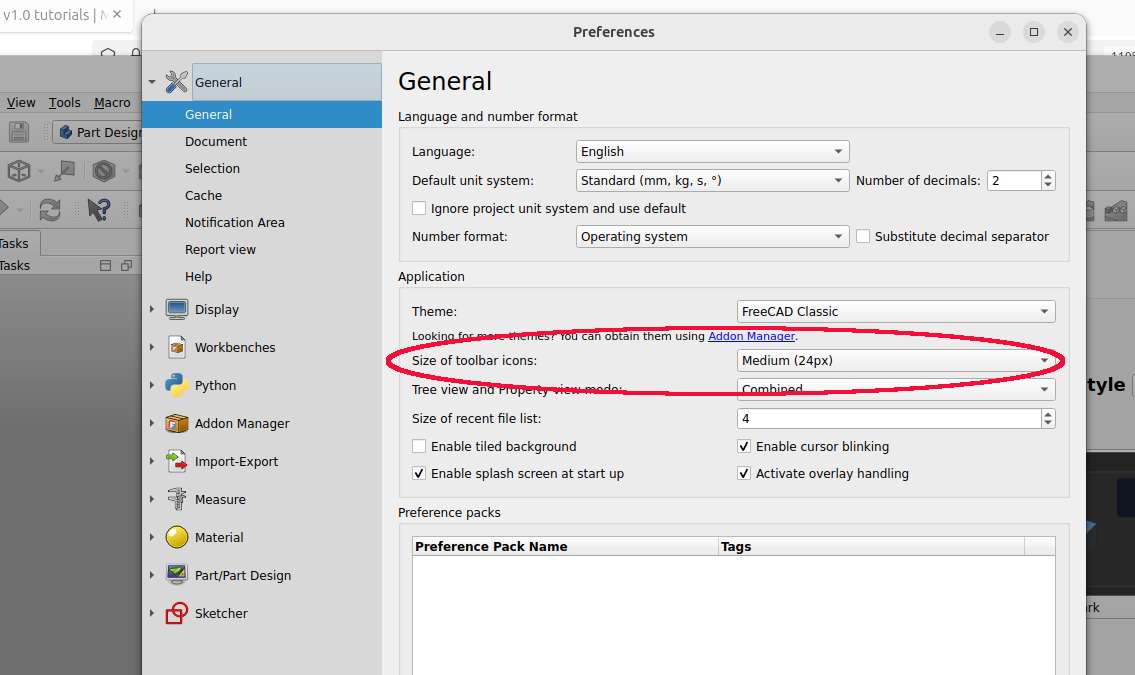

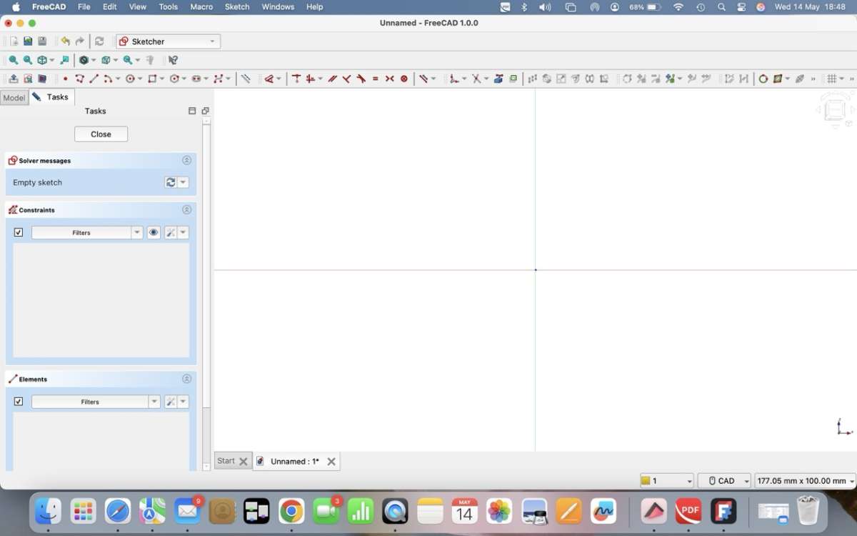

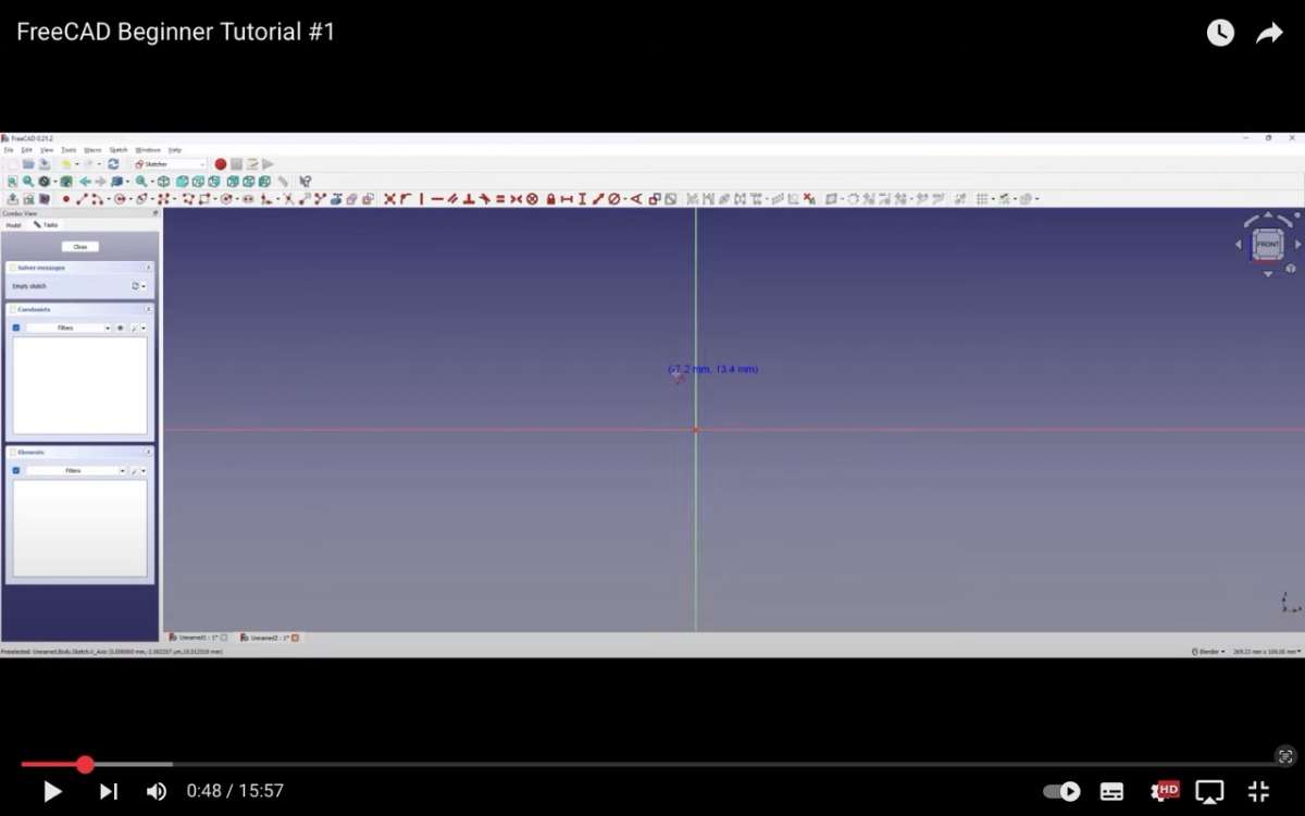

                                            I am running freeCAD on a MacBook AIR, the Tutorial1 has more icons on the toolbar than when I run freeCAD on my laptop. Is this because the laptop screen is smaller than a large display ?

                                            #797941
                                              FreeCAD seems to be so “Customisable” that almost anything is possible !
                                              #797992
                                                That and the Icon size together. Try smaller.  Icon size is changed from Edit->Preferences->General
                                                icons
                                                Michael said that FreeCAD is customisable such that almost anything is possible.  True!  The facility is for advanced users, best avoided by beginners, because configuration is a complex learning curve in itself.  My advice, avoid messing with the display until basic modelling is conquered.
                                                Most CAD programs are highly customisable and it can be painful!  SolidEdge has a nasty habit of turning panes off for no apparent reason.   Not difficult to turn back on when you know how but cost me an afternoon the first time it happened…
                                                Another problem learning FreeCAD is it supports about 30 workbenches, and it’s not obvious which of them support Mechanical Engineering.  FreeCAD 1.0 reduces the fog by coming with a simplified list of workbenches, so not quite so easy to get lost in hyperspace!  But still not clear that almost all Mechanical Engineering is done in “Part Design”, possibly supplemented by Part, Sketcher, Techdraw, Gears and Fasteners.

                                                    Speedy Builder5
                                                      @speedybuilder5
                                                      Thanks for the suggestions re – toolbar icons.  I changed the size to small, but it made no difference. Fortunately, all these icons that are not on the freeCAD toolbar can be found on the Apple toolbar – SKETCH dropdown.
                                                      Bob
                                                      Sketch dropdown
