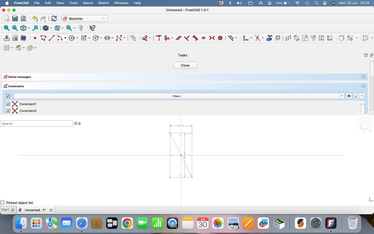

      How can you increase the line width of the GREEN fully constrained sketch.  I am using a 13″ lap top screen and the lines are about a spider’s web thickness.  I tried freeCAD/Preferences/Sketcher/Appearance where you can set the colour but not the line width.
      (Apple MacBook Air)
      Bob  (I suppose I could wear 6x glasses)
      freeCAD Constrained

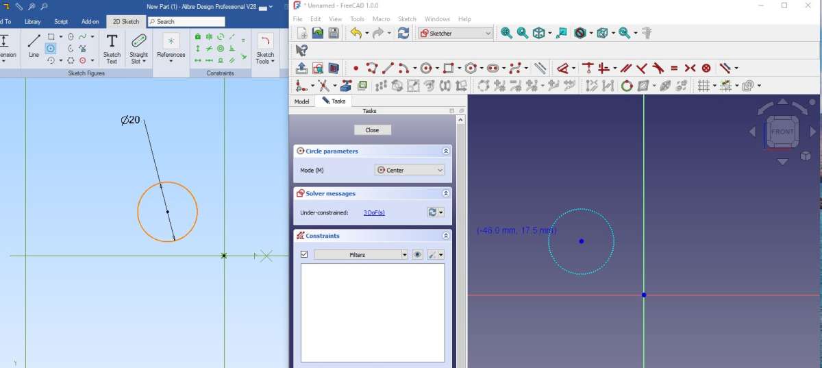

        #805432
          Looks like you need to close FreeCAD and open it up again to see the effect of any changes.
          This was how I had changed it for undefined while seeing what was needed width 2 and dotted. Alibre default on the left for comparison

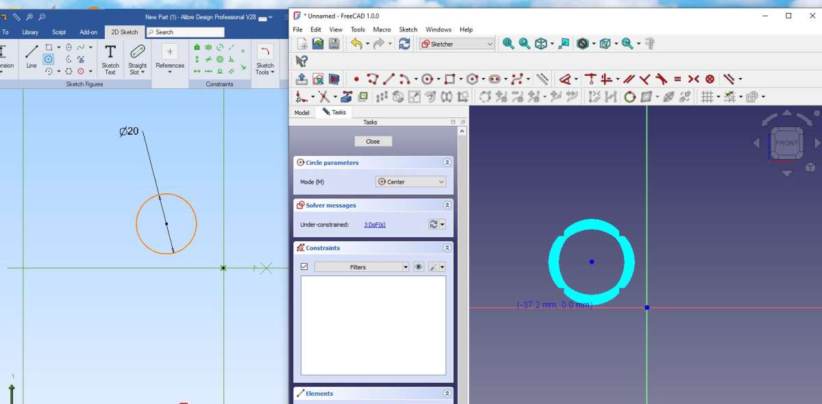

          fc line1
          Went to change the appearance, applied and clicked OK. Added circles and they were the thin dotted ones. Closed FC and opened it up again, this time the circles was like this width 20 and solid
          fc line 2
          #805482
          Speedy Builder5
            @speedybuilder5
            Thanks Michael – simple when you understand the logic of it !
