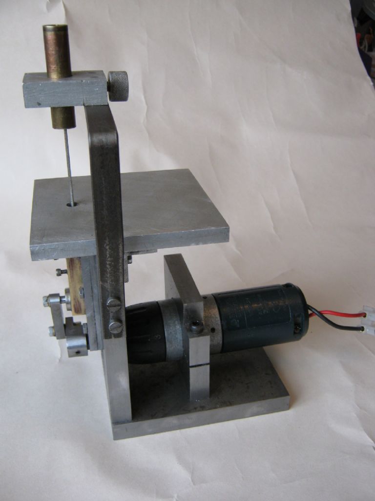

                          #159569
                          michael howarth 1
                            @michaelhowarth1
                            I have just made one of these machines. Whilst pondering over where I might get a suitable motor, I remembered that I have two redundant Black and Decker screwdrivers for which new batteries are so expensive it would be cheaper to buy a new complete unit. I have always been impressed by the torque that these 3.6 volt screwdrivers produce and found that by cutting off the battery compartment and rejigging the wiring contacts it can be made to neatly fit the filing machine. I am temporarily using a 6V battery charger to run it until I can find a more appropriate power source. (The motor in the charger appears to be a Johnson 3 – 12volt). The casing is only warm after 10 minutes running. It runs well and has loads of filing power.
                            I have found though that all of my needle files would need to have their handles shortened to such an extent that it would render them useless for use by hand. I would have no objection to adapting a set of files but before I make an expensive mistake, what are the most appropriate files to use in this sort of machine?

                                        #159740
                                        michael howarth 1
                                          @michaelhowarth1
                                          Neill….photo as requested.
                                          Ian ……yes you can get longer handled files to fit by reducing the thread on the crank pin to about 1/4" and achieving a bit more depth in the block. Even though I did this none of my files, even from different sets would fit without nipping a bit off the handle. I expect that there must be files out there that would fit without modification but I think that I shall take the advice given and modify a set of relatively cheapo diamond grit files.
                                          It may be useful to know that the drive shaft of the cordless screwdriver has a diameter of 11mm and this must be taken account of when making up the crank. The plan called for a 6BA grub to secure the crank to the drive shaft but there was not much depth of metal left on the crank because of the greater diameter of the drive shaft, so I cross drilled and inserted a 3mm roll pin instead. Surprisingly, all other dimensions are as per plan.
                                          The table in the photo is of aluminium and is as yet non adjustable for tilt because that is the material I had at hand. I shall replace it with steel and the tilt brackets next time I order some 1/4" steel.
                                          Mick

                                            #161776
                                            michael howarth 1
                                              @michaelhowarth1
                                              Although I thought I had made the slide block and runners a snug fit with minimal clearance, I have discovered that on my machine there is some "slide slap" as the slide changes direction at the bottom of it's stroke, producing a slight knocking noise. At first I thought it was the slide knocking on the crank but it is definitely caused by a very small amount of excess clearance which can be cured by using grease instead of oil on the slide/runners. Grease is probably not a good idea on a filing machine which brings me to the suggestion that it might be advisable to redesign the slide/runner set up with an adjustable gib strip. I shall do it as and when. It is also a good idea to get the crank pins and connecting rod properly lined up and not as shown on the hastily taken photo I posted earlier!
