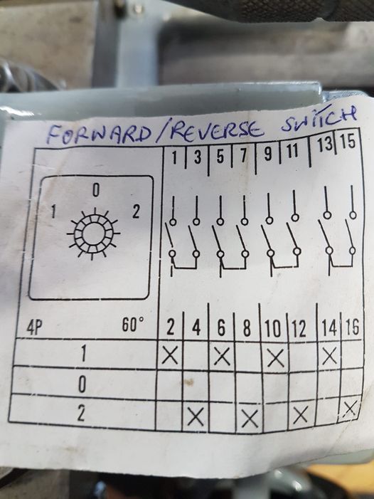

        Wiring diagram deicpher into plain english

          Position 1 Terminal 1 is connected to terminal2
          Position 0 nothing is connected
          Position 2 Terminal 3 is connected to terminal 4
          Terminals 2 and 4 are permanently linked together
          And so on for the other 3 switch sets
          What are you trying to reverse?
          Martin
          #597489
          Norfolk Boy
            @norfolkboy
            I'll give it a go. 4 pole switch,
            Position zero nothing connected
            Position 1:- 1 – 2, 5-6, 9-10, 13-14 are connected, 3-4, 7-8, 11-12, 15-16 are not connected
            position 2 :- 3-4, 7-8, 11-12, 15-16 are connected, 1 – 2, 5-6, 9-10, 13-14 are not connected.
            Alan, Pipped at the post
