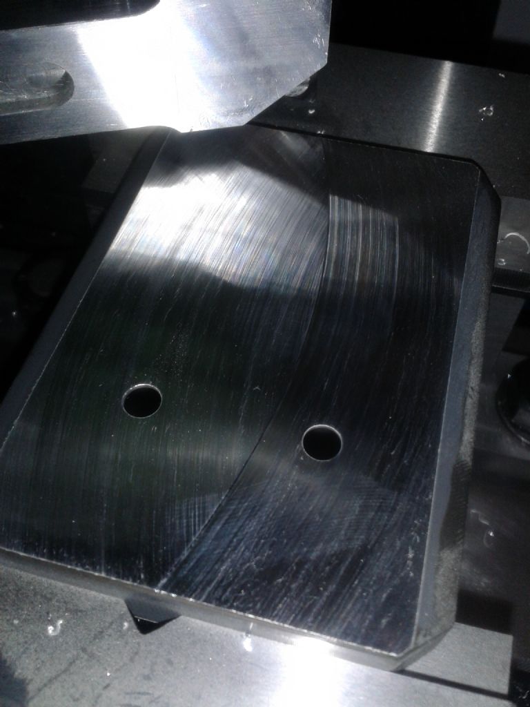

        Hello,
        Need some help flycutters in particular on how to make one cut an acceptable flat surface.
        I built my own cutter based on pictures I saw of a Suburban tools cutter. I had read that the mill head must be precisely adjusted to be able to get a good flat surface so I had a go at it and after what I believe was a sufficiently close adjustment of the head I proceeded with a face cut on a piece of aluminium.
        Unfortunately the result was not what I was expecting…feeding the work right to left, initially the cutter cut the workpiece with the cutter tip travelling towards me, as I continued feeding the workpiece it came to where the cutter is travelling away from me, but it did not touch the work piece.
        Then I tried feeding from left to right, the cutter travelling away from me cut the workpiece a first pass but as I continued feeding the cutter took a second cut (as it was travelling towards me) which I think was quite deep.
        Something must be wrong but I cant figure out what…the mill tilt seems to be in alignment left to right. dont know if the flycutter itself could be the cause, it's just a cutter no? there's no adjustments in it involved right?
        Not sure I'm explaining my self well as it's a bit difficult to explain myself with words – will try to post some pictures

                Because of the large diameter of the cut, nothing is as sensitive to misalignment as flycutting.
                With a sharp tool you only need to be 0.01mm out over the diameter of the cutting circle to see a problem.
                This error would be undetectable with a normal end mill.
                Some people prefer a double cut, always cutting in the direction that gives on, saying it give the best finish.
                To be acceptable the error needs to be tiny so that the surface is still acceptably flat.
                You don't say the radius of you cutter or how far from flat the resulting surface is. I suspect that unless you used an indicator the mill may not be as well aligned as you think.
                If you don't have an indicator, you can use a shim (such as a spark plug feeler gauge – any thin metal of consistent thickness will do) between the end of the flycutter and the mill table.

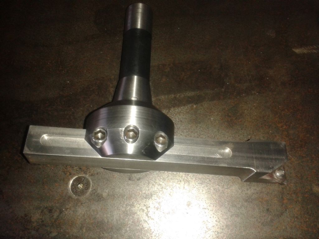

                    Yes I know, should have added more details I'm sorry.
                    So the mill is a WM18, have had it for the past year and a half, with no issues.
                    As for the fly cutter its this pictured below, the head mounts on to an R8 arbor – direct fit into the WM18 spindle,
                    the bar is 7inches long adjustable (I was facing at about 5" swing approx) The insert is a Seco TNMA 160408 CBM050C I want to change this to a different material, but that is what I had at the moment.
                    The insert is angled back 7deg for clearance.

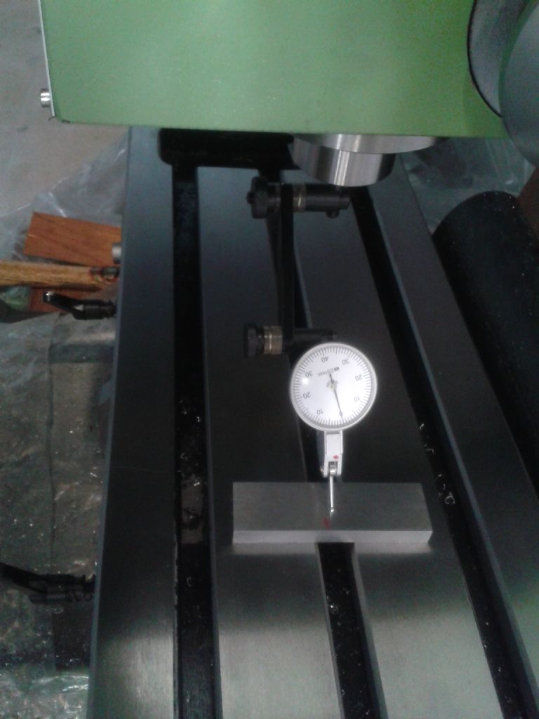

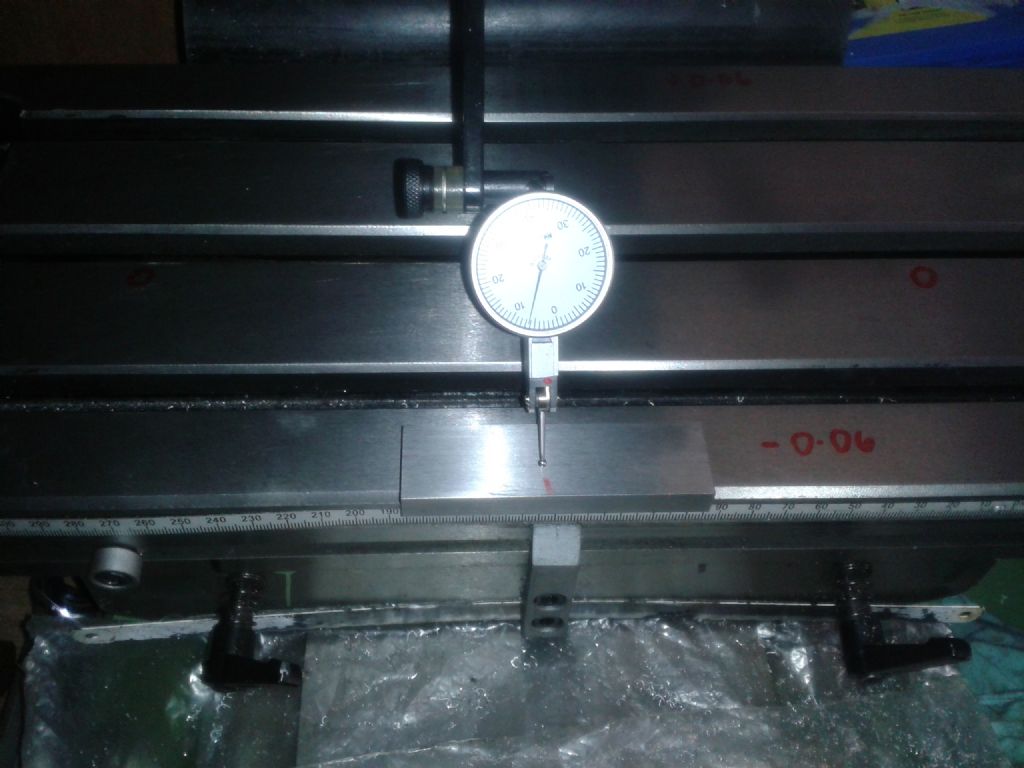

                    This is how I set up for milling, the workpiece held on parallels on a precision vice
                    Checked for head tilt by means of a dti on a 6mm R8 collet directly in the spindle. Left 0mm; right 0mm; fwd -0.06mm; aft +0.06mm
                    Cant adjust the head nod, fwd to aft but dont think it affects the surface being dished or not.

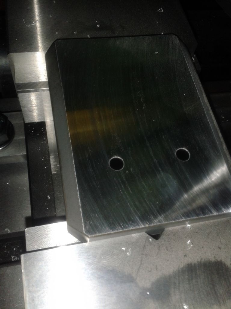

                    Surface finish, feeding right to left – initial face, and continued feeding ….
                    ……continued feeding right to left same pass, second cut (should not have happened I think)
                    I checked again the alignment after facing the workpiece and got exactly the same readings.

                              Posted by ChrisB on 06/06/2018 10:45:36:
                              I set the speed at 250rpm, did not dare to go any faster because it would start vibrating above 300rpm
                              There's a clue there.
                              You don't have a fly cutter there, you have a NASA astronaut centrifuge! **LINK**
                              But seriously, I have a WM18, and it would just feel wrong to put a fly cutter with that swing on it, especially without a way of accurately counterbalancing it. That's a lot of rotational mass flying round in relation to the size of machine.
                              And to get it to cut accurately, with around a 10" swing, is a tall ask too.

                                      Stick the dti on your table and run it along in the x-x direction both without the vice on the table and also with the vice to one end as you have it in your photo.
                                      Could be table is tilting/sagging or not running parallel even though it trams 0-0 with an empty table in the central position.

                                            Another issue is the radius of the tool is too large and requires too much tool pressure. So it flexes everything as it cuts, apart from the issue that the head/ column is not trammed to the run of the spindle. On some machines, it is not the column that needs correcting, but the work head may need shimming to get the run of the spindle true to the table. So if the head runs up and down the column, and the bottle square or you master square shows that it is within 0.02mm over 150mm or so than that is going to be OK. Then you know the error is in the assembly that is holding the spindle. It could be it needs a shim under the Pivot ring on the lower side. Looking at the numbers, it will most likely need a piece of 2 thou shim in this area for a start. It may need a 4 thou shim.

                                                  I see a combination of disadvantages:
                                                  • In my world 250 rpm is 3 or 4 times too fast for fly-cutting a 5" radius.
                                                  • At large extensions that beefy tool (nice job by the way) is likely to be out of balance and the mill isn't heavy enough to fully absorb the vibration
                                                  • The mill is on wheels, which at best reduces it's ability to absorb vibration and at worse may resonate.
                                                  • A large fly radius amplifies the effect of slight tram errors and/or vibration.
                                                  Putting the mill on a solid foundation before reducing speed and cutting diameter might well make everything sweet.
