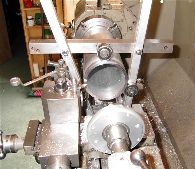

                A few years ago I needed to machine the end faces and bore of some aluminium tube. As the OP noted tube is often not truly circular so its not ideal for being held in a steady.
                I turned a scrap motor end plate so that it was firm fit in the 'oval' end of the tube and used it to support the tailstock end whilst I machined a circular land near the open end. This end was then ran in three ballraces supported by a 30 minute concoction of bits from the scrapbox.
                There are some other pictures in my 'Rock Steady' album that shows the arrangement from the headstock side, also the resulting parts I made using it.
                Ian P

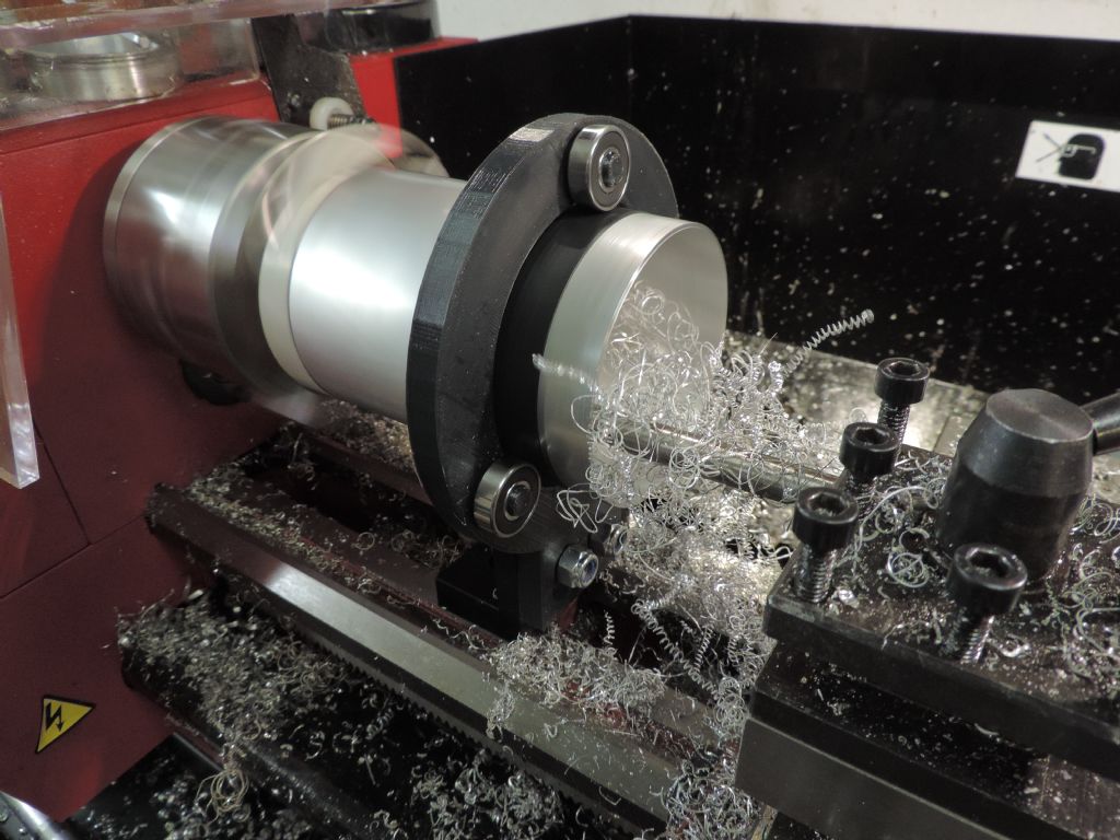

                                      Here's another idea, not adjustable, for a custom purpose:
                                      Note the wrap of insulation tape to take up a tiny bit of slack and protect the tube.
                                      Edit: In case it isn't obvious, the steady is a 3D prnt
