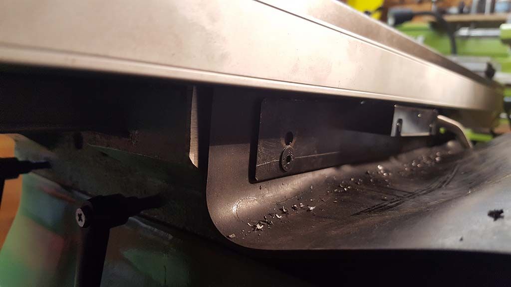

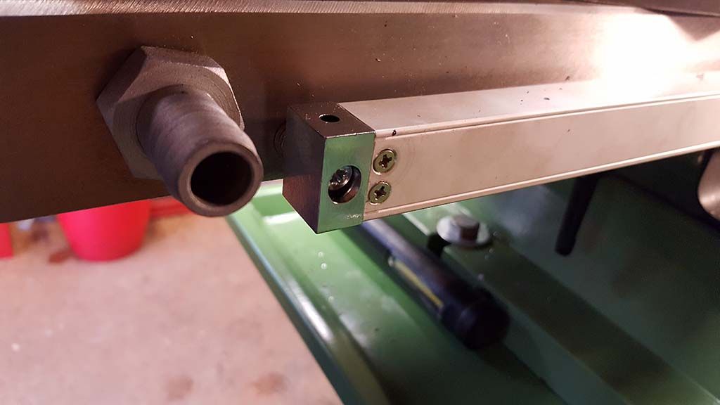

      Hi
      I have just taken delivery of a WM16 and cannot see how to fit the DRO to the table.
      The Table measures 700mm long and at 1 end has the coolant drain fitted
      I have fitted the X axis with home made brackets but can't seem to find where to mount the reader head for the table
      Any ideas please

        petro1head
          @petro1head
          I have taken a couple of photos of my dro fitted to the X axis (WM18). If you need any more photos or measurement just shout

            Tony Marshall
              @tonymarshall12301
              Hi Trevor, see my album "WM16 gets a DRO" for my take on this. I did not use any of the supplied brackets, instead I opted to make a special bracket to carry the Y-axis read head at 68° to the vertical. The x-axis read head has a simpler bracket which is held in place using the fixing screws for the neoprene swarf guard.

              #287125
              Enough!
                @enough
                Am I reading you correctly there, Tony …. that you fitted the X-axis DRO to the rear of the table? I considered doing that because I have a power feed whose limit switches need to attach to the slot on the front side – but as far as I could see, mounting the DRO to the rear would significantly limit travel in the Y-direction.
                So mine is pretty much a copy of what George did although with different (optical) scales …. and the power feed – well it just gets along without limit switches.

                Tony Marshall
                  @tonymarshall12301
                  Correction to my previous post: angle is 58°

                  Tony Marshall
                    @tonymarshall12301
                    Yes, nothing wrong with your reading skills, Bandersnatch. nerd
                    I considered putting the scale, magnetic in my case, on the front but I just didn't want to clutter things up. I reasoned that I could always relocate it if it didn't work out and so far so good. I estimate that the y-axis travel has been reduced by about 25mm but I have not yet measured it.

                                Many thanks to all and thanks to some excellent photo's I now have a fitted and working DRO, never had one before, but then again never had a new Mill before
                                I have used a combination of methods to achieve the maximum travel on both axis and am generally pleased with the result, its only the basic magnetic type but is more than accurate for my needs
