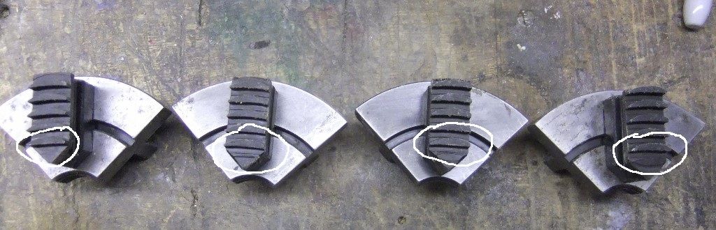

                            Dalboy
                              @dalboy
                              if you have a set of jaws not numbered looking at the thread you will see that the first tooth on each jaw will be in from the centre slightly from the previous one. See ringed tooth on this set of woodturning chuck jaws.
