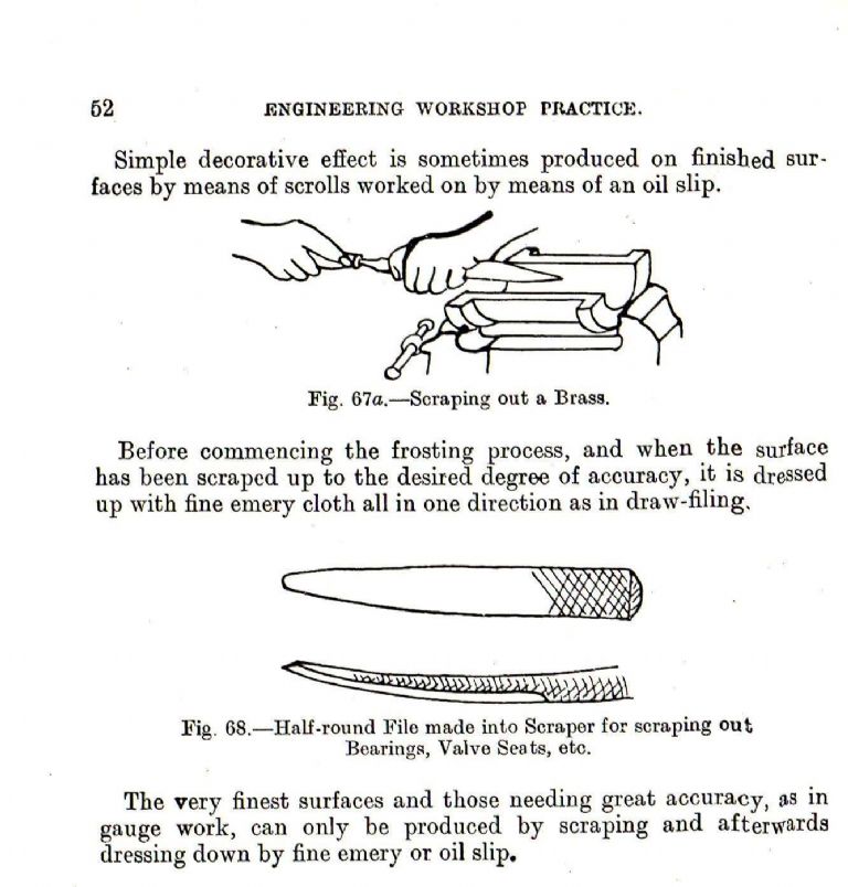

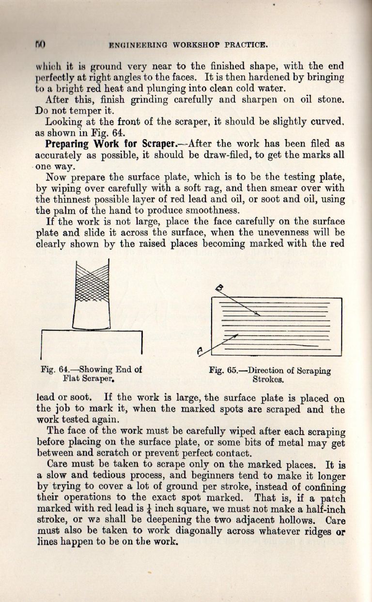

                                          I just dug out an old engineering book that belonged to my father. It was a fifth reprint in 1939, but it gives an interesting insight into the engineering world of the day when stuff was big – really big! Anyway, there was this snippet about scraping and what they called "frosting". Hope it doesn't take up too much space.
                                          page50
                                          page51

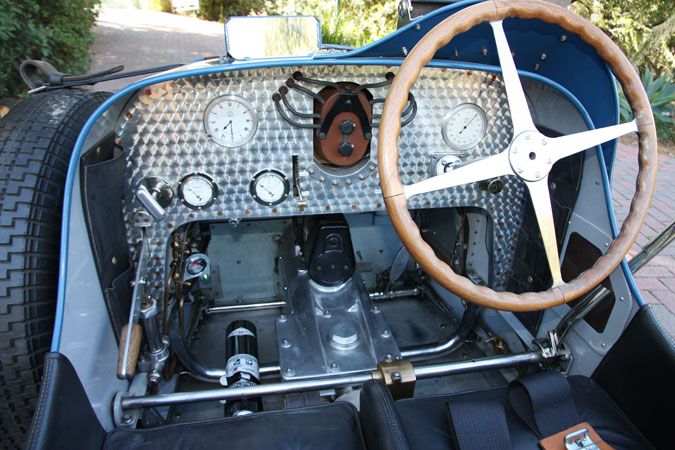

                                              I have never been a fan of engine turning. I think it makes an object look cheap. After seeing photos of the bugatti I may have to reconsider….

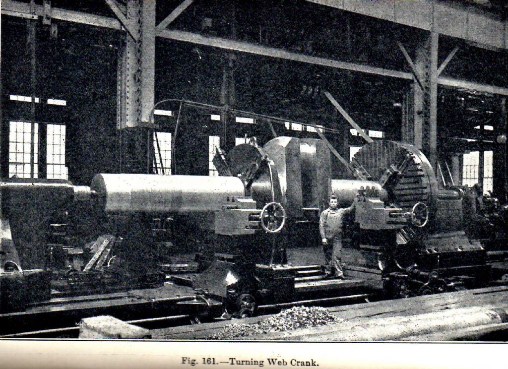

                                                Michael W – to answer your question – "Why did they build that?" – and at the risk of hijacking this thread with lots of photos – presumably to measure something like this ………
                                                large crank
                                                Unless, of course, the factory is located in Middle Earth.

                                                  As apprentices many years ago, we had to make our own scrapers out of old files and once the foreman was happy withe quality of them, we had to learn how to use them. The company made large industrial and marine engines with journals in the 10" to 15" range. We weren't allowed to practice on bearings that were to be fitted at the works but instead we scraped in bearings that were to be supplied as spares.
                                                  These were scraped in to a mandrel with a thin film of red lead and when to size we had to scrape a criss cross pattern that, we were told, would retain enough oil for initial starting. This criss cross pattern had to look really good as this was what the customer saw on receipt.
