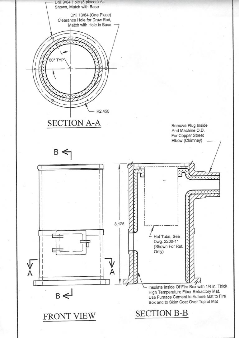

      Q1.
      I need to line the cast aluminium firebox of a hot air engine. I have some welder's ceramic blanket. What is the best way to secure this inside the 'box? The 20th cent. building notes suggest using furnace cement, but I was wondering whether there was a different suggestion for the 21st cent. Would beads of JB Weld around the top/bottom and joints be up to the task?

              Just follow the instructions on the drawing that you have shown , the lining
              will hold fast ,the engine that i made for a friend the lining is still holding in
              after nearly ten years ,looks very similar to the Rider Ericsson engine
              that i made as you can see here.Some other photo's in album.

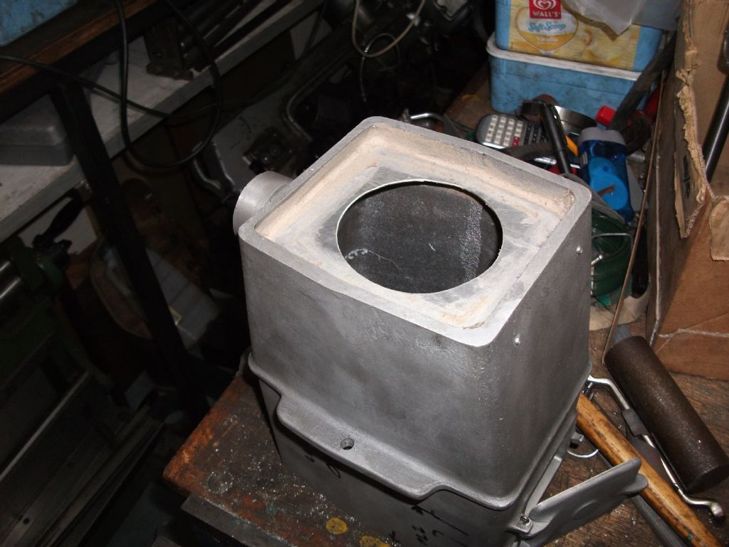

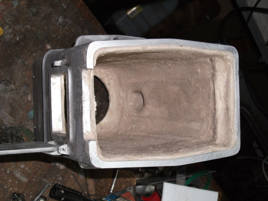

                    The engine that was made was also a Myers it was 3inch i think,
                    the firebox was lined with 4mm thick sheet similar to that below from RS
                    they still sell it its around £75 a sheet, they do sell the 2mm thick sheet
                    here for about £45 + vat Flame Retardant Calcium-Magnesium
                    Silicate Thermal Insulating Sheet, 2.8m x 610mm x 2mm , RS
                    Stock No 724-8906. Would probably be easier to fit in using 2 layers
                    with the fire cement that is how i fixed mine by laminating some layers
                    with the fire cement.
                    I could post a link here but it will be taken down almost instantly and
                    replaced with "online" which is of no use to anybody so i will send you
                    a PM with the link to the same material for a fraction of the price.
                    When i made mine i made some alteration the the firebox casting
                    by adding a support to form the lining at the roof of the firebox,
                    the two photo here show this ,it makes i easy to mold the shape
                    at the top ,the baffle is fitted low enough to allow the ring of bolts
                    that attach the hot cap end to fit and clear the space above is filled
                    with loose ceramic fiber blanket when assembled.

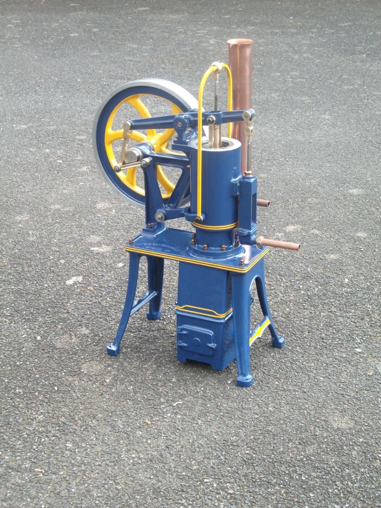

                    The engine was in model engineer from June 2013 4459 to
                    January 2014 4472.and is also seen here.
                    The photo gives no idea of scale it is about 24 inches to the top of the chimney.
