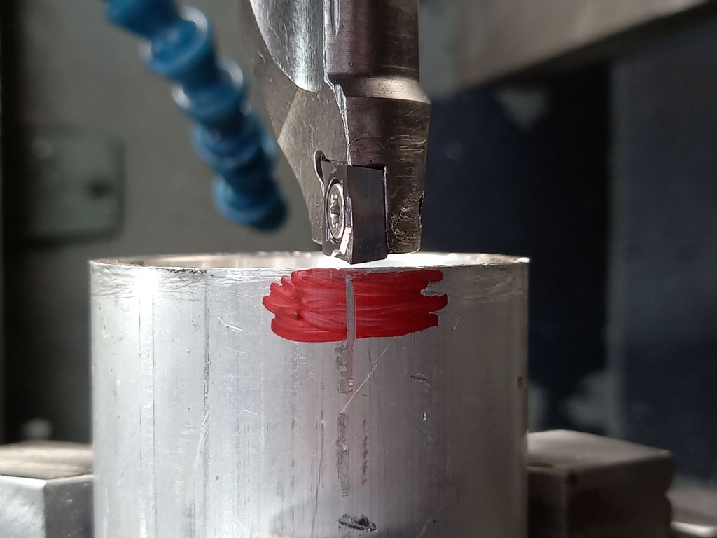

                                                #625367
                                                Neil Lickfold
                                                  @neillickfold44316
                                                  This is what I do to find approximate centre height when only using a boring bar when the stock piece already had a hole in it. I mark tge outside, then wipe a edge from something that is held vertical. It leaves a mark on the side. You could wipe a known tool on t outside too, but does leave a mark that may not be wanted.
