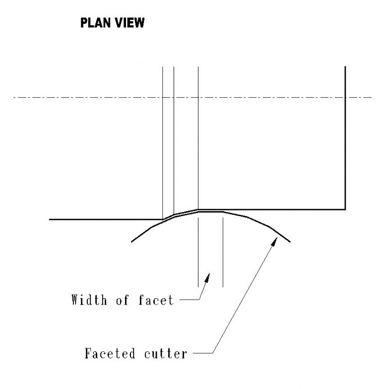

      What are people's favourite finishing tools for doing final turning, facing or boring cuts?
      Pretty much anything will do for hacking off metal but different authors seem to suggest different shapes of HSS tool to get a good finish on the final cut. Harold Hall's books suggest one shape of finishing tool while the articles in Model Engineer by Tubal Cain (I'm not sure who this is an alias for in Model Englineer) suggest a different shape of shaving tool to give a good finish. It may vary depending on the material – I'm not sure.
      Other people seem to use indexable carbide tips for the final finishing cut.
      Would be great so see what people's favourite finishing tools are. Photos welcome!

          David Littlewood
            @davidlittlewood51847
            Will,
            For fine finishing, the most important feature is that it should not be sharply pointed in plan view. A very sharp-nosed tool will leave minute screw-cut lines on the work, whereas one of rounded shape will smooth these out with ovelapping cuts as it goes. I cannot say I have found much difference between a round shape, or a knife tool (with a small radius at the leading edge) applied so that the front face is at a few degrees to the work.
            Most indexable carbide tips have a cutting lip which has a very small radius on it*; this is to make it more durable, as a dead sharp lip would be liable to chip easily. You can refine this with a diamond hone if you wish, but I have found that a new tip will take a finishing cut of around half a thou without too much difficulty. Around this depth of cut it will stop cutting and start rubbing, which leaves a lot of chatter and an uneven cut. Others' experience may vary. For the very finest of cuts a well-honed HS knife tool is hard to beat. However, you may find that the best finish is actually obtained if you leave a few thou to be removed at the last cut – I know in our world we often approach size on our one-off jobs rather tentatively. For removal of the last few tenths with excellent finish, I find the most reliable approach is to use a No 4 or No 6 cut genuine Swiss hand file (must have handle fitted) well soaked with cutting oil – an approach recommended by no less an authority than G H Thomas, and I have found it works splendidly to get good shaft fits.
            Tubal Cain was the nom-de-plume of Tom Walshaw, who spent his working life as a professional engineer, and who wrote many excellent books and articles. I met him once, very briefly; very nice chap he was too.
            David
            *This time I don't mean in plan view, I mean a (very small) a radius on the horizontal cutting edge – sorry if that was confusing.

                                            #96045
                                            Will Robertson
                                              @willrobertson16447
                                              Hi David,
                                              Thank you very much for all the information – very interesting and helpful. I hadn't thought of using a Swiss file on a bore. Have you any advice on how to choose a file fine enough and good enough?
                                              Does this work with both ferous and non-ferous metals?
                                              Edited By Will Robertson on 09/08/2012 21:53:04

                                                  David Littlewood
                                                    Will,
                                                    I'm afraid Hansrudolf is quite right – I was not suggesting use of a file inside a bore, that would be doomed to awful results. I was suggesting making the bore (reamer, boring head, hone, whatever) and then adjusting the shaft to suit using a very fine file. I apologise if this was not clear.
                                                    Don't try this using the bog standard files described as "medium" or "fine" ; these are suitable for metal removal but not for fine surface finishing. Genuine Swiss files of the finest quality come in numbered cuts, 0 to 6 – mostly the even numbers only are found, one occasionally sees odd numbers. I use for preference a No 6 cut hand file; this has a rectangular section and one safe edge (but check it – may need slight attention from a stone) and leaves a finish like the finest cylindrical grinder. I can easily take less than a tenth off the diameter, and the amount is small enough that it's reasonably easy to maintain parallelism.
                                                    You will find that genuine Swiss files (and I don't mean the titchy needle files often called Swiss files even though most of them aren't) are hard to find, and the No 6 cut is the hardest of all; when you do find them, the price may take your breath away. The only source I could find in 5 minutes Googling was
                                                    **LINK**
                                                    And look under "Files – Pillar Standard (Swiss Vallorbe)" for the 150 mm No 6 cut – £35.65 + VAT. I tend to keep a couple of spares in stock as they don't last forever and are hard to find. You can get nearly as good a result with a No 4 cut, bit easier to find (and cheaper). Keep clean (bit of brass run along the grooves is the best – the brass will soon acquire a set of teeth to match the file's tooth profile).
                                                    The steel/brass thing is important. If you want to use a file on brass, never use it on steel, this will very slightly take the keen edge off the teeth and then it will skid badly over brass.The counsel of perfection is to save a new file for brass, then demote it to steel when it starts to lose its first freshness.
                                                    Always use a handle when using a file on a moving part in a lathe; your wrists are at serious risk if you don't. Holding the part in a collet is strongly preferred as there are no nasty chuck jaws to hurt you.
