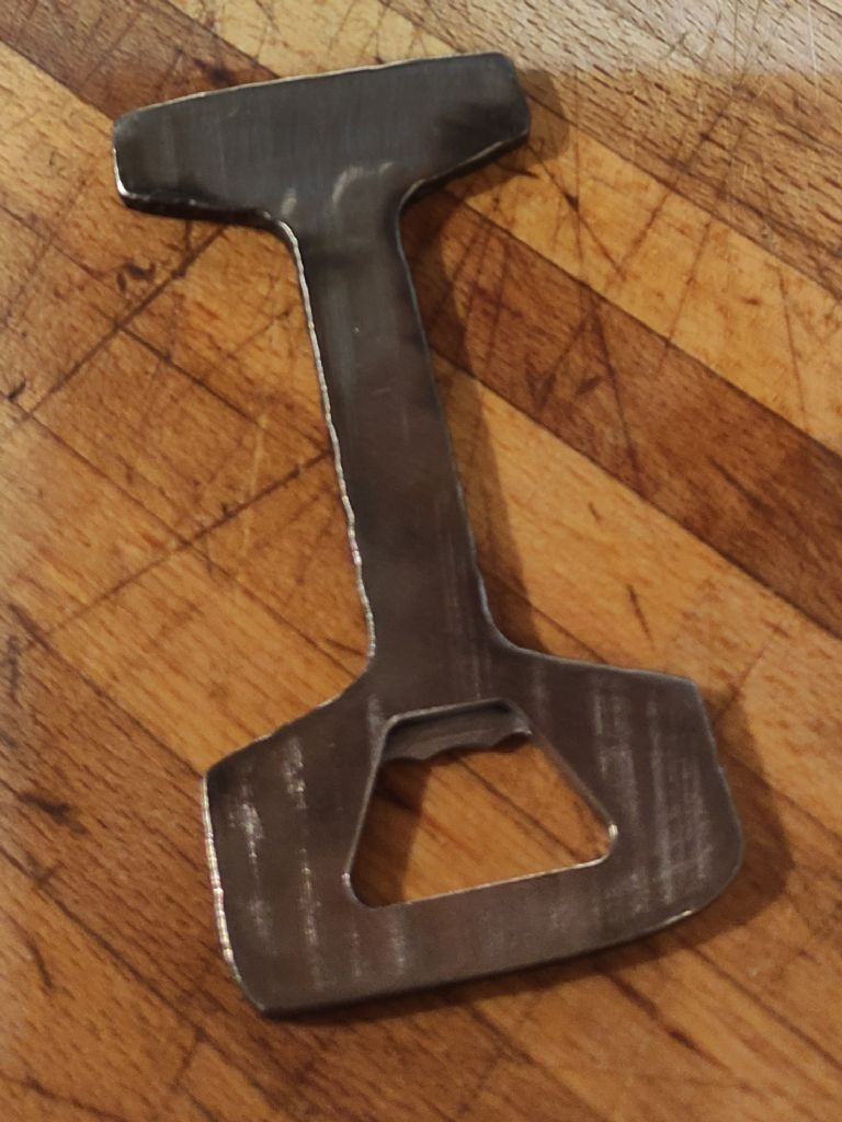

        On Monday I picked up a 6×4 bandsaw for a good price, so decided to do a it of last-minute gift making for father's day. I've had some bits of rail lying around for a while waiting for a project, I figured that a slice would make a good bottle opener.
        The bandsaw seems well set up and cut nice and square giving a nice event 5mm slice. That was until the blade snapped; too be fair the tooth count was far too high to be cutting the 5in web and I have no idea how old it was to start with.
        Unfortunately I couldn't get a new blade same-day anywhere nearby so had to crack out the hacksaw. Luckily the bandsaw had the cut well established square and had just about broken all the way through on the central web. The hacksaw cut didn't take as long as I feared and came out just as square.
        After a quick clean up with a flap disc and wire cup brush it was off to the CNC mill for the bottle opener cutout. After a couple of attempts in a scrap of steel to get the shape right I had a geometry that worked well. The Sieg KX3 happily drove a 6mm end mill through it leaving only minimal burrs.
        After a final deburr and clean here's the finished article:

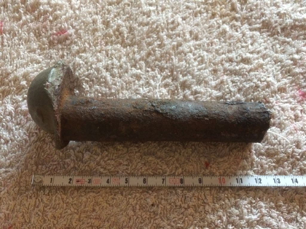

            Ah! Now I know what to do with a similar slice of rail for my son who is in the business so to speak.
            Last year he gave me a rivet that was recovered from the Sydney Harbour bridge during the repairs. Always good to get something useful !

              Engraving was part of the plan, along with letting my 3 year old boy stamp his name with the fly press (currently his favourite thing to do in the workshop). Unfortunately it was 11pm when I got it this far, so that'll have to wait for future items.
              Feel free to give me a shout if you want the bottle opener geometry – I'm more than happy to save you the faff of figuring it out. You will of course still need to test that it works before final polishing wink

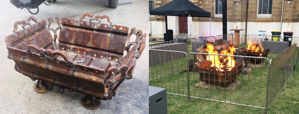

                Our club is located next to a train line where they are doing a major upgrade and we sell fire pits, made from the old parts that are scrapped (rail base plates, clamps, etc).

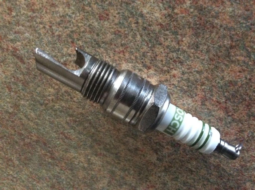

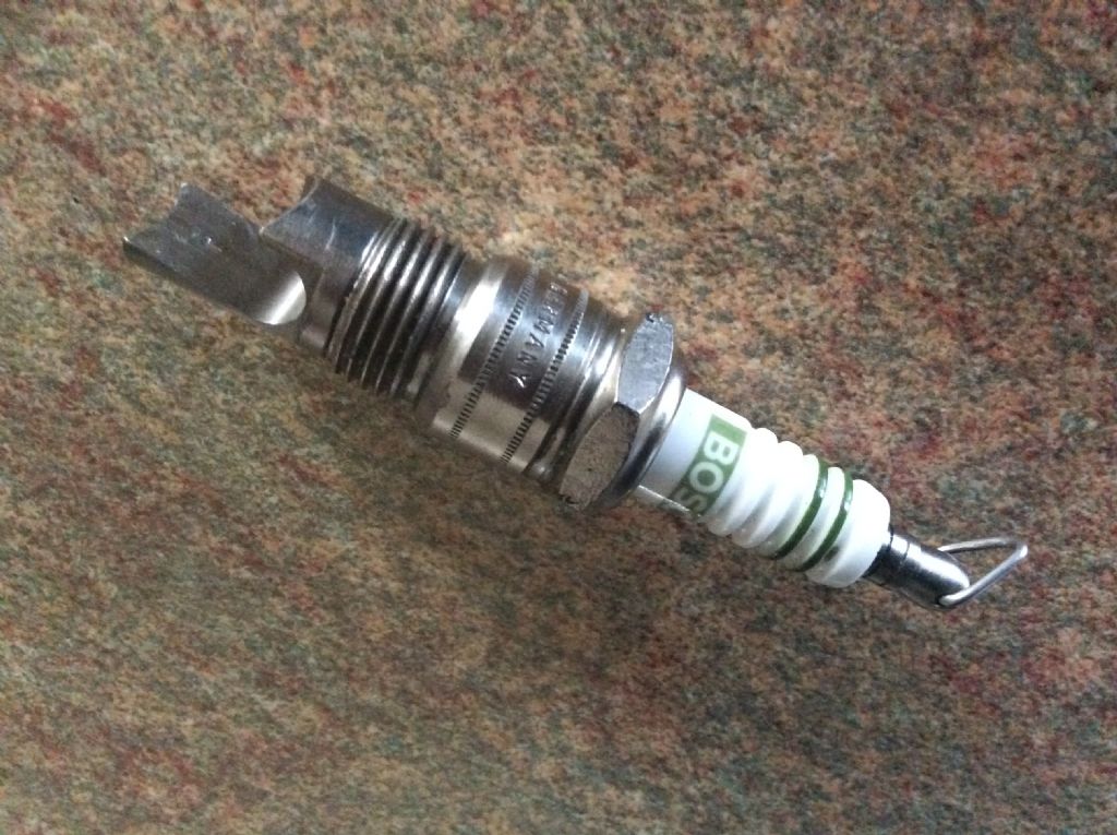

                      229f0520-4679-45ea-9c41-757844010959.jpegHad a similar idea to Mike but these are for petrolheads!b8e7449b-faaf-4cdb-9bd3-5346340903e0.jpeg
