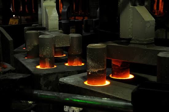

          Friction welding is also used to fuse together big pieces of steel.
          One of the projects which I worked on was machinery that replaced the anodes used in aluminium smelters. Aluminium is made in enormous electrical furnaces and use carbon anodes. ( Aluminium smelter use more electricity than that of a small town). The anodes are basically big blocks of carbon 900 x 900 x 1000 – 1500mm long and mounted on a steel stem. The stem has a number of branches at the bottom which fit into holes in the carbon block. Molten cast iron is used as a filler for bonding them together (similar process to solderring but on a bigger scale).
          The carbon is eventually eroded away and has to be replaced. The bottom of the support stems is cut off and new ones welded in place. The re-furbished stem is used again with a new carbon block.
          New pieces are spun at speed and friction welded to the bottom of the spigots at the bottom of the support stem. These are 150 – 250mm diameter and welded in minutes.
          Paul
          Photo after the pouring of cast iron.
