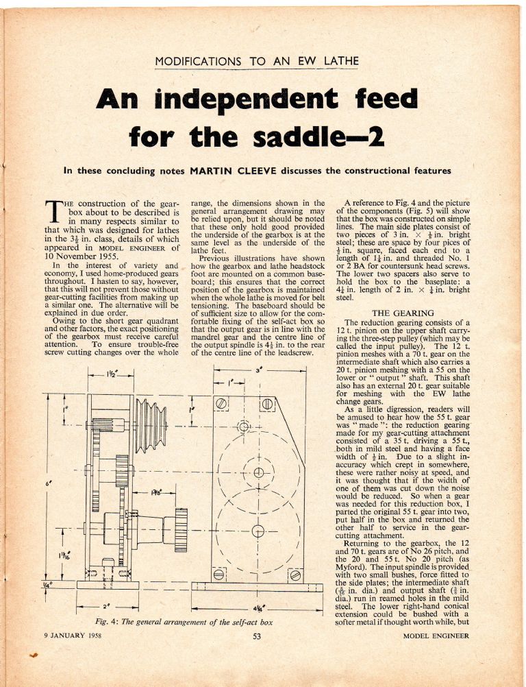

          Hi Martin Cleeve bloodhounds,
          I enclose a copy of Martins design for the EW slow feed, Are you sure that you haven't overlooked this refugee from a clock factory.
          There must be one somewhere so let's bring it to ground otherwise I'm just going to have to make one!
          Alan

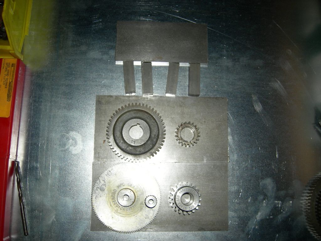

                alan smith 6
                  @alansmith6
                  Here are the materials for the Martin cleeve slow feed reconstruction.
                  More info to follow.
                  Alan

                  alan smith 6
                    @alansmith6
                    Martin Cleeve Bloodhounds,
                    I have bought in all the parts necessary to re-create Martin's slow speed gearbox. The metal cost me a fiver. The two used Myford gears cost £18 from fleabay and the three remaining gears I bought from HPC at the whopping price of £66.
                    Looking at the gears, the difference in thickness and diametric pitch does not auger a harmonious looking gearbox!
                    I will have to change the design slightly as there is no need for a three speed pulley on the input shaft which will now have a single pulley, that is enough to prove the design.
                    When martin designed the gearbox he made all the gears for it himself and in his article he then gives a list of gears that could be purchased from retail outlets. See copes of the articles which I will add to my photo albums. What this means is that the reader wil have to modify the design hiself as the bores of the bought gears differ from those that Martin made.
