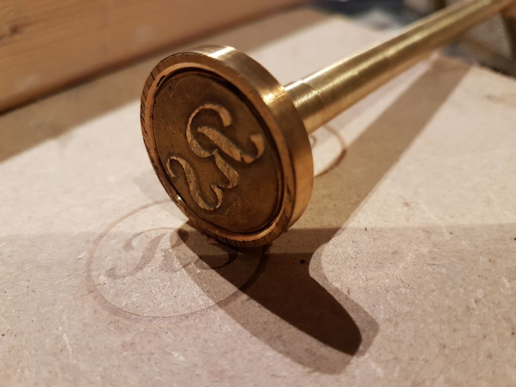

      Robin Graham
        @robingraham42208
        I would like to put a 'maker's mark' on a project in brass. I haven't got engraving equipment or skills, so I'm thinking about etching.
        I've had a look around on t'internet and the tutorials I've seen start with the assumption that the tutee has a laser printer. It seems that laser toner can be transferred to the the work to make the mask. But I haven't got a laser printer – just an inkjet.
        Another possibility would be using photo resist, but I'm having a hard time trying to understand what equipment I would need to do this. There are suppliers of photoresist film on eBay, but they don't give info on how to expose/develop (or even if it's positive or negative), so I'm a bit in the dark. Does one need a UV lamp? If so, what sort? Could I get away with burning a few welding sticks? They put out a fair bit of 300-400nm radiation.
        If anyone could cast light (of any wavelength!) I'd be grateful.

          Stuart Smith 5
            @stuartsmith5
            I have used Press n Peel successfully to etch into brass. It is a blue sheet that you print onto using a laser printer or photocopier. The sheet is then ironed onto the brass. You could print your artwork on your inkjet printer and then use a photocopier to copy to the Press n Peel sheet. You obviously need access to a photocopier possibly at a local library if they are open.
            I etched this after using pressnpeel sheet with the design printed using a laser printer.
            etched brass
            I heated the brass in the oven and then pressed it onto the sheet.
            I used Sodium persulphate from CPC as the etchant. It is clear so is easier to see what's happening than ferric chloride. It works best at 50 deg c.
            My daughter does wood turning and is is a brand to mark her work with her initials.
            Edited By Stuart Smith 5 on 17/12/2020 23:31:57
            Edited By Stuart Smith 5 on 17/12/2020 23:34:09

                      Thanks for replies. Tony Moss's video which David gave a link to is very informative, and has been bookmarked for further ref. At the moment though I don't want to go to such lengths just to put my mark on the job. It seems like getting a photocopy or finding someone with a laser printer might be the way way to go.
                      In the distant days of my youth I tried etching brass by coating the metal with paraffin wax, scraping out my design and immersing in nitric acid, which was freely available at the time. The results were disappointing – very ragged around the edges. I gave up and moved on – probably to making a firework or something. I was only twelve, too many interesting things to investigate! I may revisit this approach in the light of stuff I've since learned.
                      Thanks again for leads, Robin.
