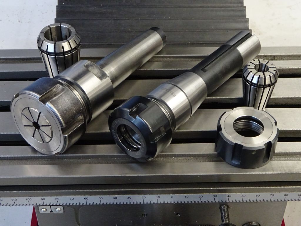

                                      NDIY, my collet chucks all have spanner flats on them so i spindle lock is not required (just a large single ended spanner) and I would suggest only purchasing this type if buying one. They can also be held in a vice if needed for tooling fitting or removal. If i had one without the flats I would consider grinding some on it.

                                          Sorry, but I’ve not a clue what you are talking about! I was simply assuming that those with ER holders (surely all have spanner flats?) would realise that operating two spanners while holding a cutter is a bear. Nothing more, nothing less. I have a few wooden blocks I use to hold/prop the end mill within the collet, while tightening sufficiently for the collet to grip the shank.

                                                Martin is right. There are some which don't have flats on the main body – perfectly normal. In such cases, spindle lock/find some way to hold spindle/spindle drawbar/peg type spanner with location pins (usually supplied with machine specifically for this purpose) to hold certain spindles at the bottom/ or grind flats on body as suggested.

                                                  And just to illustrate Ketan's point, one with and one without plus a couple of his nuts!
