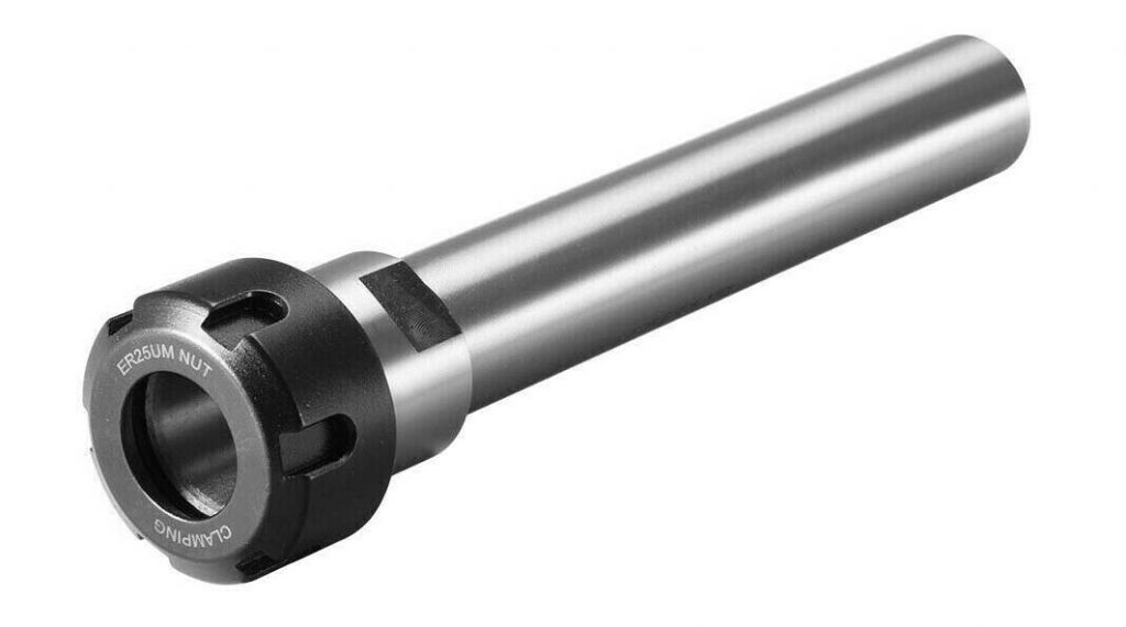

        Anyone know where you might be able to get one of these?
        Eccentric Engineering are out of stock.
        #548702
        ega
          @ega
          I'm afraid not; but if I needed another one I would make one (buying in the tricky nut).

                      No, I don’t want an ER chuck for a Myford lathe, I want an ER32 extension as stated in the thread title! It’s for my existing (flange type) ER chuck. Eccentric Engineering list them on their website but as I said they’re showing as out of stock.
                      #549108
                      DC31k
                        @dc31k
                        Posted by Vic on 09/06/2021 23:17:45:
                        If that is what you want, why are you confusing us all by posting a picture of one that is clearly spindle-mounted?
                        It takes seconds to post a link to the correct item:
                        https://eccentricengineering.com.au/shop/ER32-Collet-Chuck-M40x1-5mm-Extender-p178489274
                        For those who have never seen one before, this _replaces_ the closing nut on an ER32 chuck and uses a female M40 x 1.5mm thread.
                        As this is not an item that is used commercially, or in any other application than the Turnado system, there is a worldwide monopoly supplier of this, Eccentric Engineering. So if it is out of stock, you have to make your own or wait.

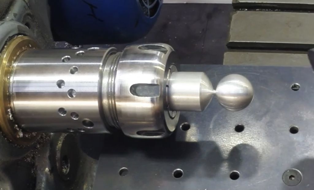

                            The link above by DC31k goes to an ER32 Collet chuck extender which screws straight onto a backing plate type ER32 Collet Chuck to extend the length from the lathe head to the work piece.
                            EE also have one that screws directly onto the spindle shaft of a Southbend 9 lathe (similar to the photo originally posted by Vic)
                            Both are listed for use with the Turnado freehand turning system so not for precision work. Both are out of stock.
                            An alternative is to hold an ER collet chuck extension (ER collet holder with a parrallel shank) in the collet chuck which is on the lathe. Lots for sale on ebay.
                            (Possibly just an ER collet holder with a morse taper shank as they extends further from the mill head and more compact than a collet chuck mounted directly to the spindle)

                            Vic
                              @vic
                              Posted by DC31k on 10/06/2021 08:31:56:
                              Because that’s the only picture I could find. But really, the clue is in The Thread Title ER32 Extension! Locating some bits on the Eccentric website isn’t easy.

                                Paul, I did think I could mount a C20 ER32 spindle in my Chuck but I lose the ability to pass stock up to 20mm through my headstock. I may buy one at some point though as they are only about £30 on the auction site.

                                        #656239
                                        Brendan Gill
                                          @brendangill16097
                                          To be honest i have one. it is spectaculary made. but!!! i get 20 thou run out off mine and thats without a collet fitted..
                                          I suspect tthat can't be due to the collet holder as it is made so well.. not sure where to look next at improving it but thought I should bring it up. I was going to make one myself but bought this instead.
                                          Just some food for thought.
