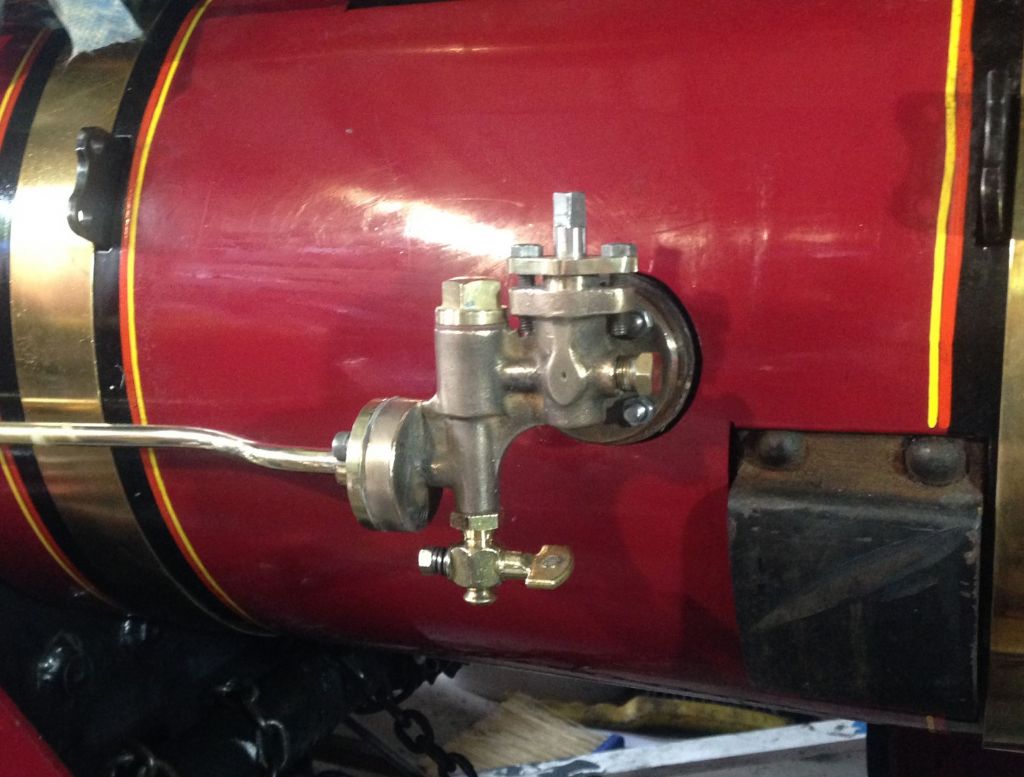

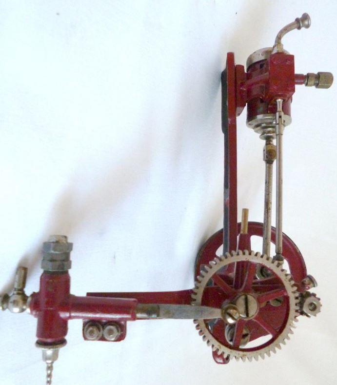

                  As Paul says many full size gear down the pump drive and it is also common on models the Burrell GMT being a popular one. You even find it on things like the Stuart D10 and the old steam toys by the likes of Ernst Plank, the latter having quite a reduction ratio.
                  As for plumbing my Fowler has the bypass valve on the end of the pump and is just a short drop back into the tender. Whereas the Minnie has the valve towards the rear of the tender and pumps back below water level, not a bad thing what with the boiler mounted pump as that would get even hotter if the bypass was just circulating a small volume of w ter
