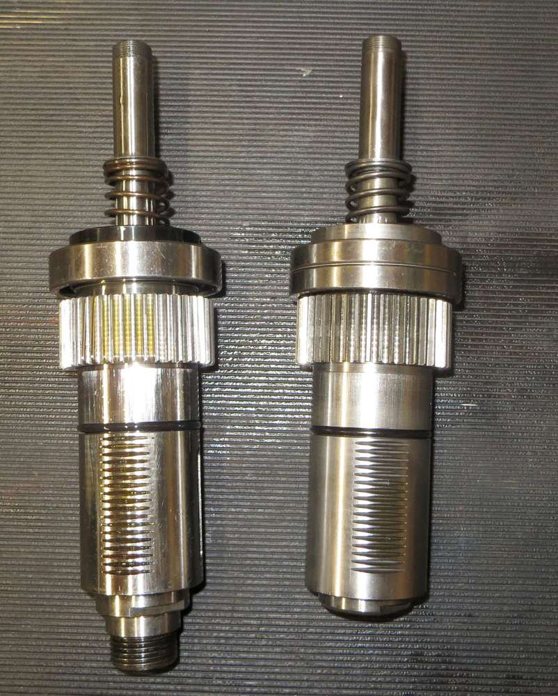

                                Well, it took a few months to wind its way from the USA to the beautiful Forest of Dean UK, but I now have my spindle, and it’s been in use for a while now.
                                IMG_1737c
                                The original clone quill assembly (with the Myford collet nose) is on the left, and the well-travelled Emco assembly is on the right. There are a few differences, notably the large bearing at the top. My clone’s head casting doesn’t have enough depth to accommodate the Emco bearing, but it’s an easy fix: Just unclip the circlip and the large bearing and gear slides out, then just swap them – they interchange perfectly. A very minor modification was also made to the oil seal position on the clone’s head, but that’s a subject that would be better detailed in the ‘Emco FB2: Quirks and Additions’ thread, if anyone’s interested.
                                Anyway, the difference is night and day. The spindle play is now barely measurable, and this shows in the ease of making cuts and the surface finish. I feel I could quite easily make twice the depth of cut that I could before, and finally, I can centre-find using a DTI. I’m really enjoying using my FB2 clone now, and I was very lucky the quill assembly turned up at the right time.
                                I’m also in a position to investigate the problem with the original spindle at my leisure, but that’s now much lower on the priority list. If anyone’s interested in the original fault, please reply here and I’ll make an effort to strip it and diagnose properly.
                                All the best, Paul

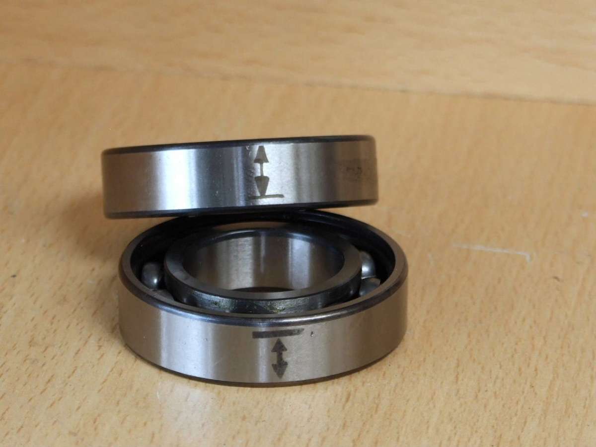

                                        In the Emco Quill the two top bearings while they may look like standard bearings, they are anything but.
                                        Emco Top Bearing
                                        These bearings were specially prepared by the bearing manufacturer. When the two are clamped up onto the spindle they have almost Zero sideways movement. These bearings are not available commercially.
                                        All standard bearing can tolerate Axial Thrust, or Loading and this is usually about half the Radial Loading. To eliminate any axial play, standard bearings would need a shim between the bearings. This would need to be carefully gauged as it this is over done then too much loading would cause the bearings to fail prematurely.
                                        Angular Contacts would be a good substitute used in “Back to Back” format.

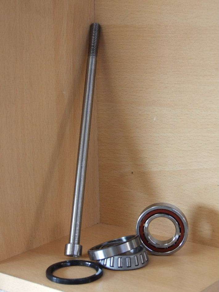

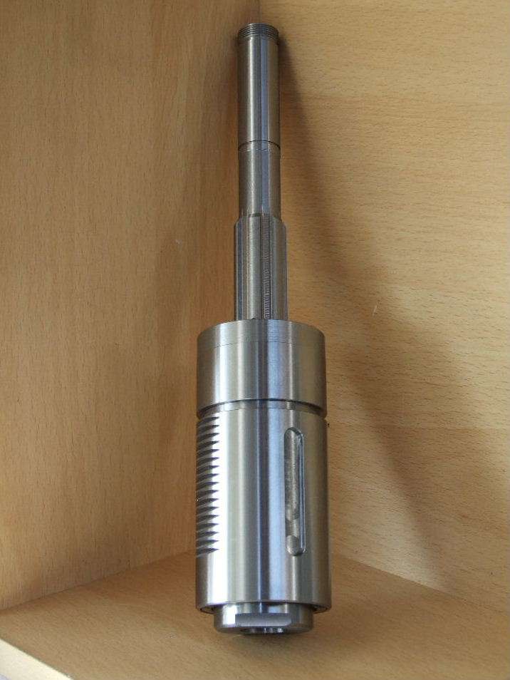

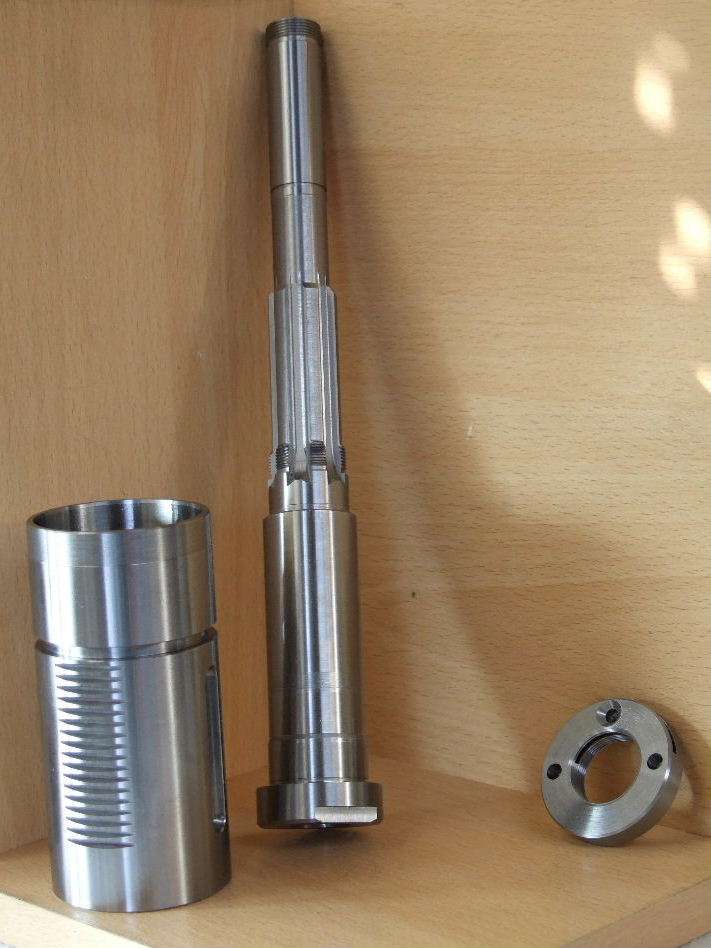

                                            Your memory has not failed you. However while the bearing arrangement was simpler there was no real gain in performance, over the original Emco design. I would say they got it right first time.
                                            Finished 8mm longer Emco FB2 quill assembly
                                            I had better just add that this Quill was a complete remake, and does not use any of the original parts of the Quill.
                                            New parts for redesigned FB2 Quill
                                            The Quill needed to be made 8 mm longer in order for the Taper Roller bearing to miss the Keyway.
                                            Bought in items for revised FB2 Quill
                                            The Spindle also being longer needs another longer Cap screw for the draw bar.
                                            All of the parts were made on the Emco equipment I had at that time. The whole exercise was a valuable learning curve.
