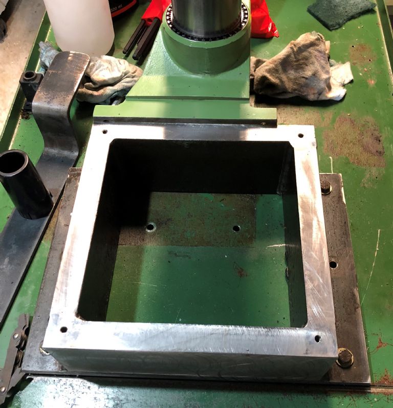

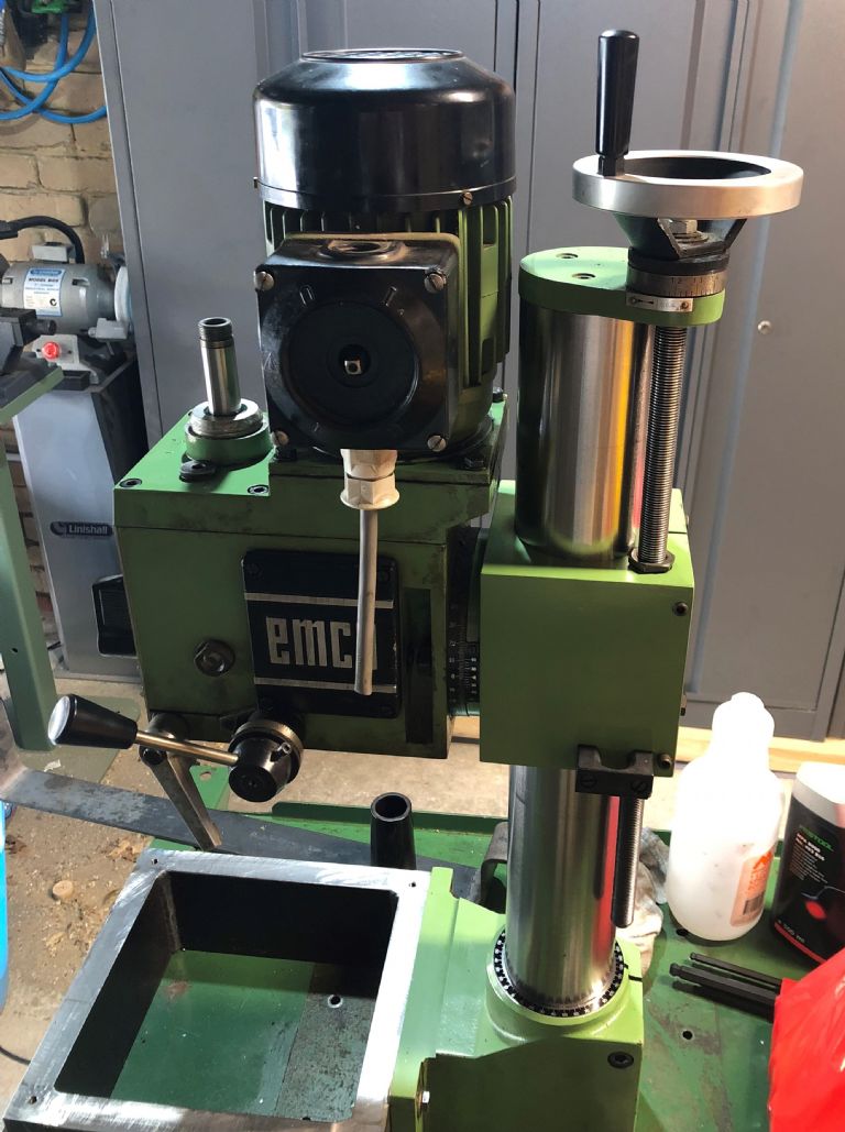

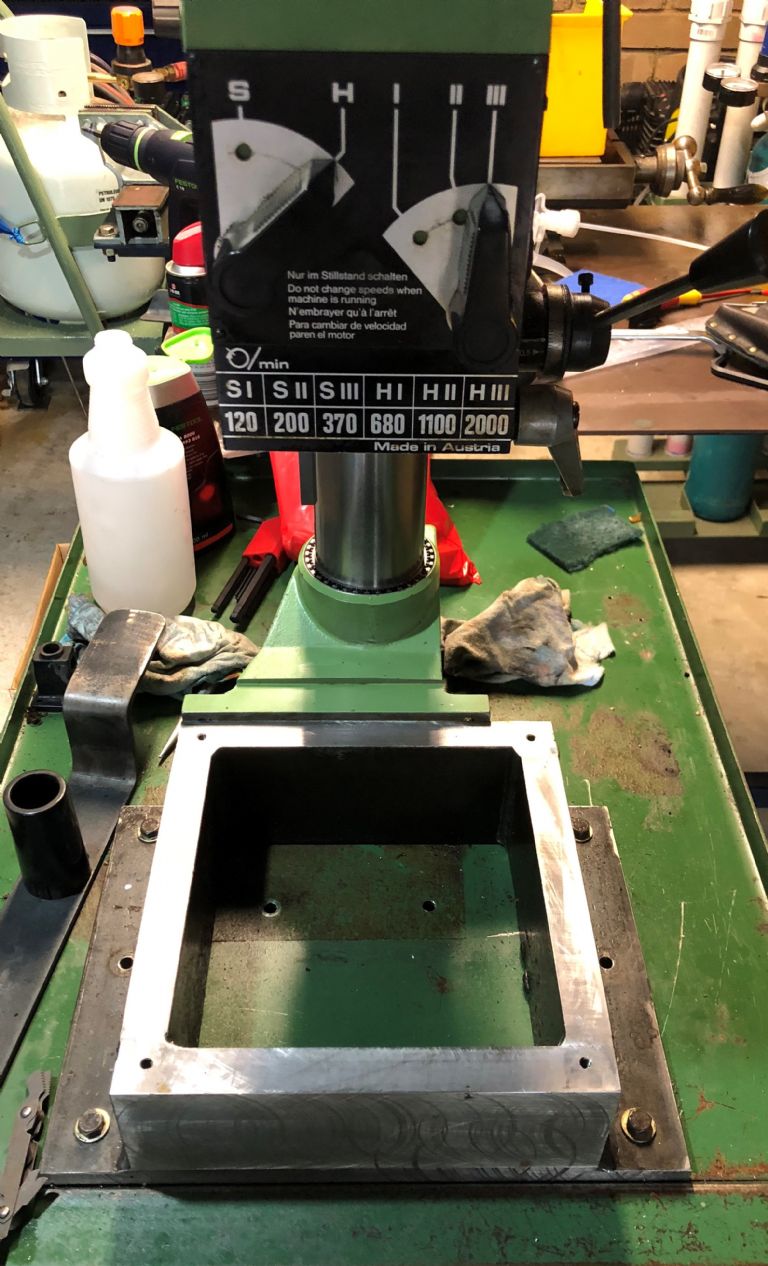

                              #354093
                              Sam Collins
                                @samcollins81137
                                Success! Picked up capacitor from a local motor repair shop ($10.50) and hooked it up temp to test. Will wire in permanently once i get around to fabing up a stand and possibly a chip tray. Photos attached with table off showing previous owners homemade base, very heavy!
