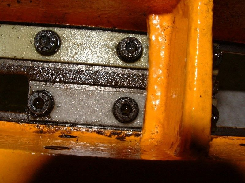

                      z+axis+gibstrips.jpgWilliam
                      If you are able to lift the saddle from the bed you may need to fit some new gib plates, or just remove and refit the existing ones by turning over end to end to use the unworn surface.
                      This will normally improve the performance of the lathe and is best to stand the lathe on end to gain access to the M5 socket caps retaining the gibs.
                      Did you get the chuck key ? if not a Jacobs K3 will fit if you turn the spigot to fit the chuck, also you need to extend the length to give working clearance.
                      I guess you know the chuck jaws are reversible, the relation of chuck jaws is the numbered sheet on the lathe headstock.
