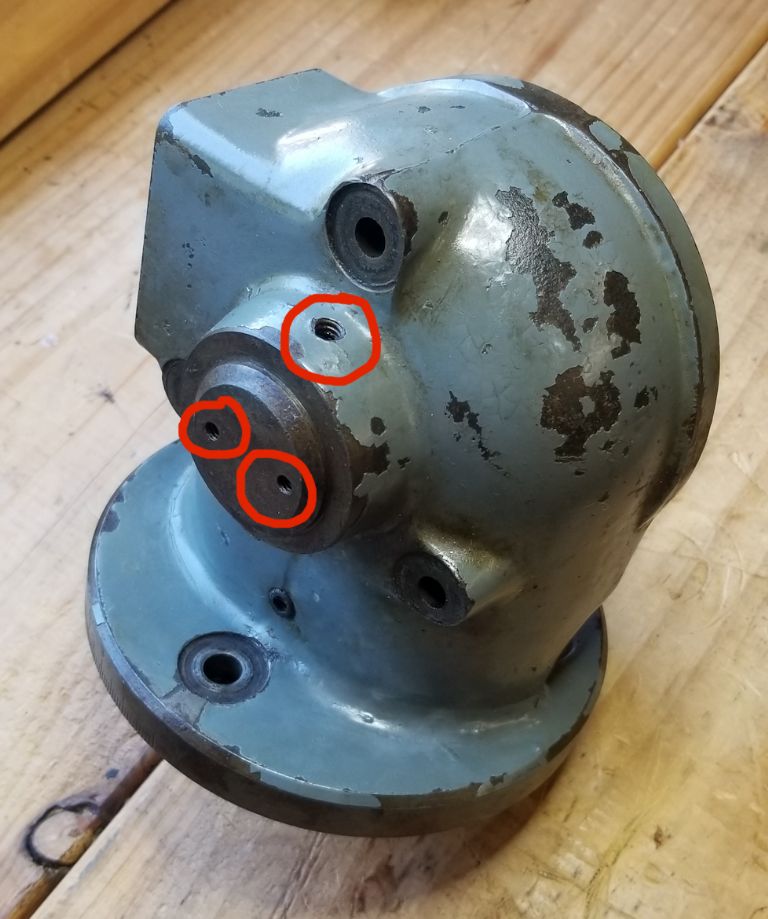

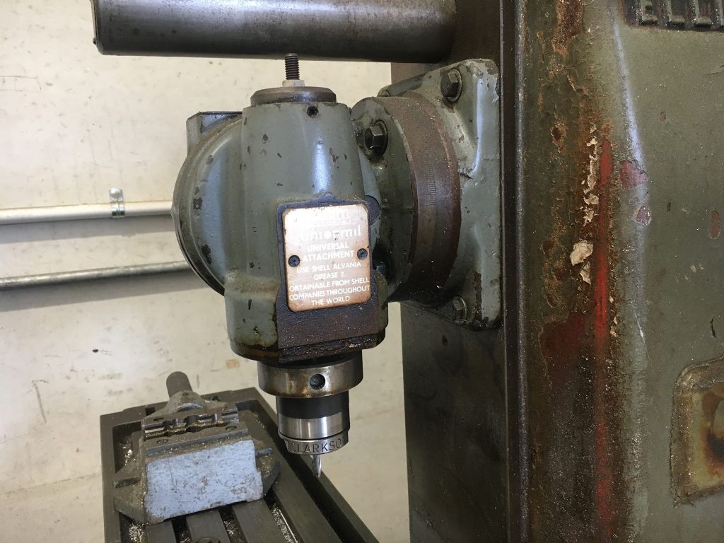

      Hi everyone
      I have an Elliott 181 with the Universal Milling Attachment and I want to give it a bit of a birthday with some new bearings. I don't have a manual for the head and the Elliott operators manual does not have any sort of exploded view of the unit.
      Before I resort to brute force and ignorance, does anyone have experience with taking these apart? My main problem is there appears to be a couple of bearing end caps which are retained in place by grub-screws. I do not know if the caps themselves screw out or whether they must be pulled out.
      Any help would be appreciated.
      cheers
      Dean

          Rather than ‘I want to’, does it actuallly need new bearings? What are the symptoms?

            Mill has not been run since I have had it as it came with a 1-1/4HP 440V-3Ph motor.
            As I don't have access to 3Ph power I will be installing a 220V-3Ph motor so I can run off a single phase inverter.
            If the bearings are OK I'll probably not change them but I want to disassemble, clean, inspect and change or re-install and lubricate.
            I would prefer to do this now while I have the rest of the mill apart.

              Two Three things. 1) your choice, but 2) You are more likely to feck the bearings, than make them better, and 3) Is the current motor not able to be converted to delta?

                I'd agree with NDIY regarding stripping the mill head unless you suspect something amiss I'd leave well alone, these are very tough old things designed for heavy constant use in industry.
                If its not been used in a while a long run at slow speed in various orientations of the swivel head should warm it up a bit and loosen up the grease within. At one time I looked after the machine tools in a large production factory and bearing problems in assemblies such as this were very rare, from memory only caused by monumental smash ups that bent spindles and damaged gears.
                I'm not trying to be negative but it is quite possible to do more harm than good dismantling something of this type.

                  1) yes
                  2) Yes I had considered that and after your prompting I may just wait until I can run it to ascertain the condition of the bearings.
                  3) No it cannot be connected in Delta. The original Elliotts were available up to 2HP from my understanding and I'll probably replace with a 1.5kW-4P. I already have a 2.2kW drive available.

                    Hi Dean, find your local motor rewinder, they will easily be able to pull the star point out of the existing motor (I had all three on my omnimill done this way) then you can run with a VFD.
                    Cost was about an hours labour, they also replaced the bearings in one as they were past there best.
                    I agree with above don't go pulling anything bearing wise until you have had the chance to run it.
