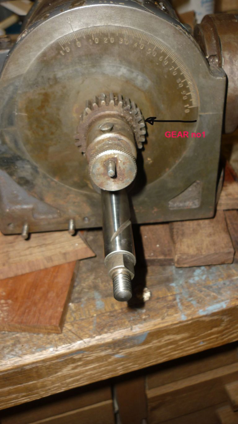

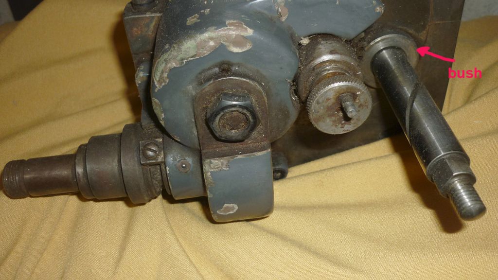

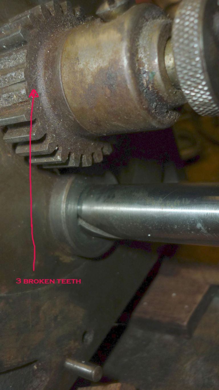

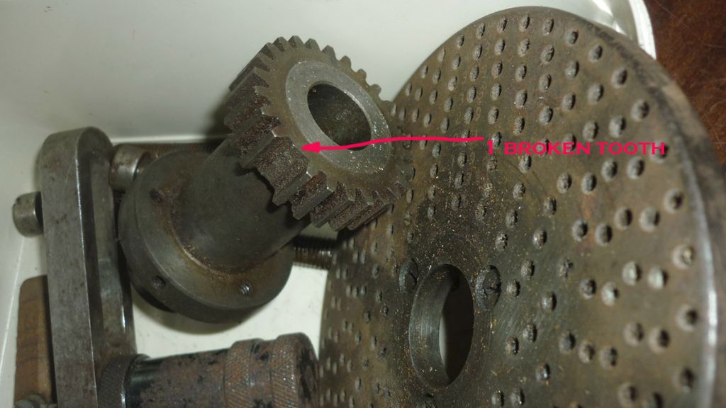

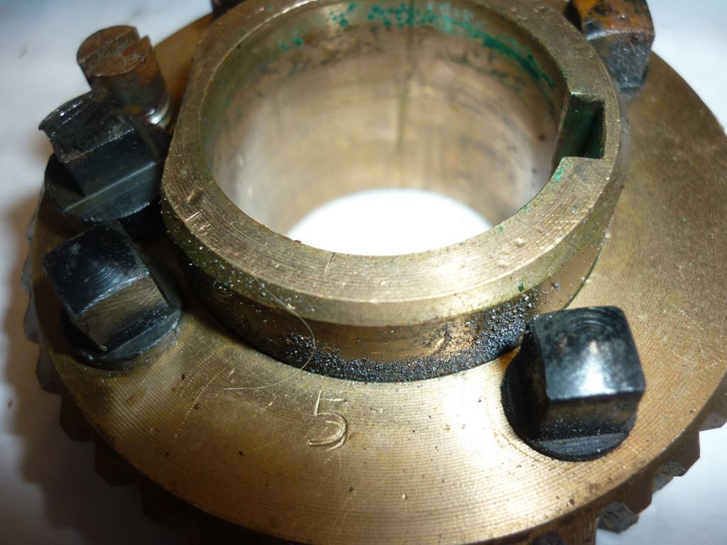

      Hi Just bought this on ebay after wanting something of suitable size ad deciding whetehr or not to make one .
      Anyway it was advertised with 2 broken gears ,although has a nice burnard 6" four jaw which from inspection looks like it will clean up like new with no jaw wear.
      On taking it apart (or trying to) i discovered another broken gear under the cover! I knew it may have other problems when i bought it so not too annoyed about that . But on trying to be clever and dismantle it without any manual or instructions i buggered up the part on the end of the worm(on the opposite side of the main body).
      I dont know what i was thinking at the time but thought it was just a cover so gave it a little tap with a very thin metal knife edge after removing the 2 socket screws and a hammer and the whole bit shattered leaving what looks like half of it in the side of the dividing head. I wasnt expecting the boss on the other side of the diamond shaped bit.
      Anyone have an info on these heads ,such as how to get that broken bit out .
      Also the gear info . all the broken spur gears appear to be 26 teeth and possibly 16DP.
      Anyone have a parts diagram they could post??
      Rather annoyed with myself.

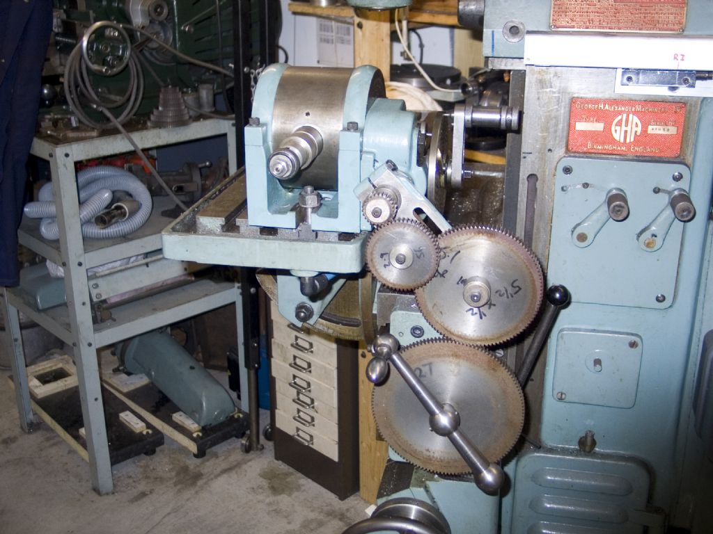

            Well at least it's not the helical gears that are broken; you should still be able to make spur gears on the dividing head as is.
            I have a manual, with exploded diagram and parts list, including the 7" swing version, which is presumably this one? PM me for details.

              Damn some people are quick.
              I have just been and rooted out my copy of the manual, only to find I have been beaten to it.
              Most of the differential gears including the banjo and spindle attachment parts were missing on mine, and I had to design and make them myself.
              If you need any of those parts you are welcome to my drawings.

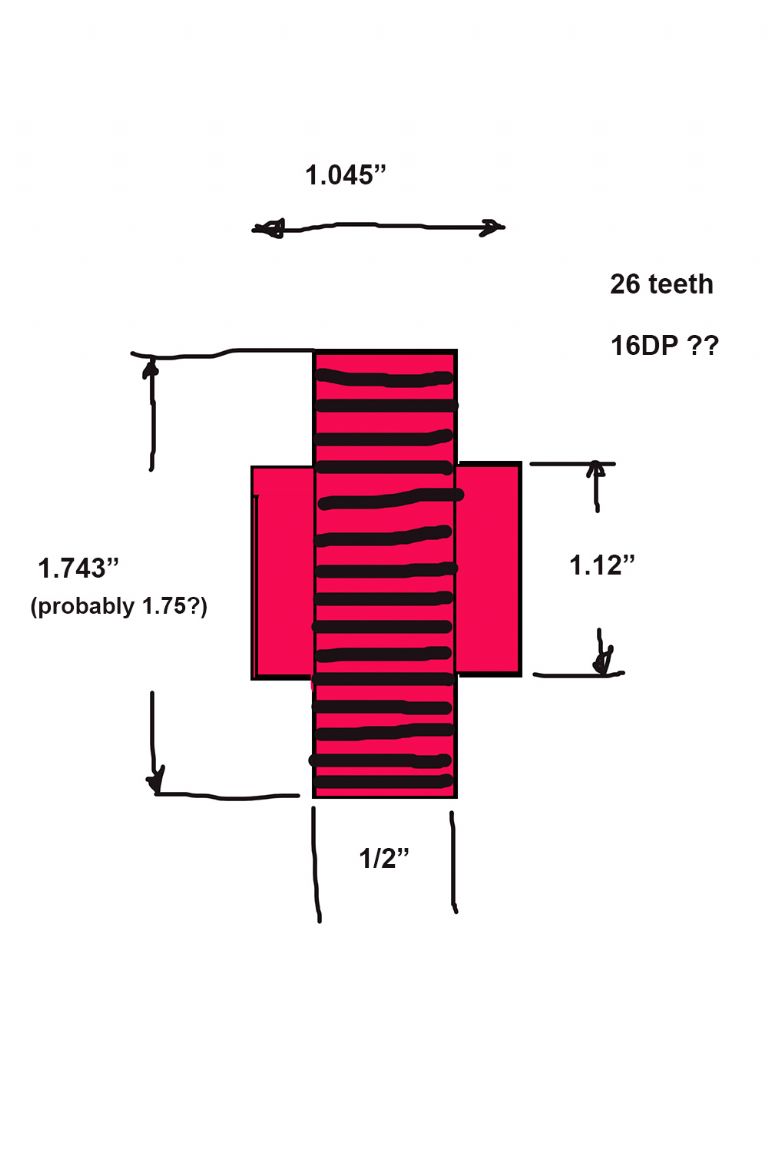

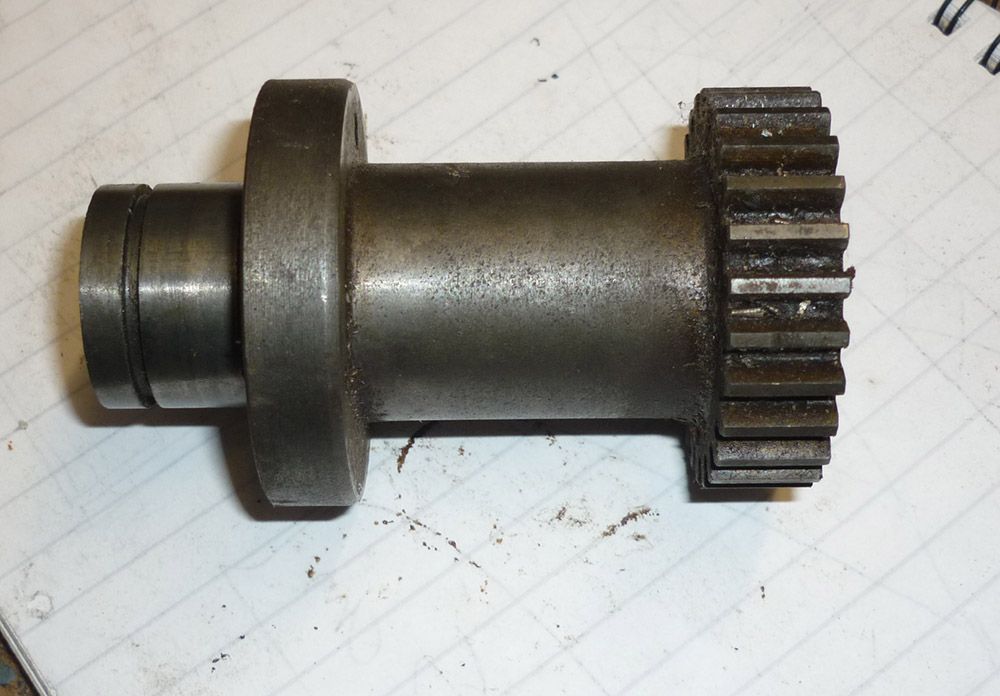

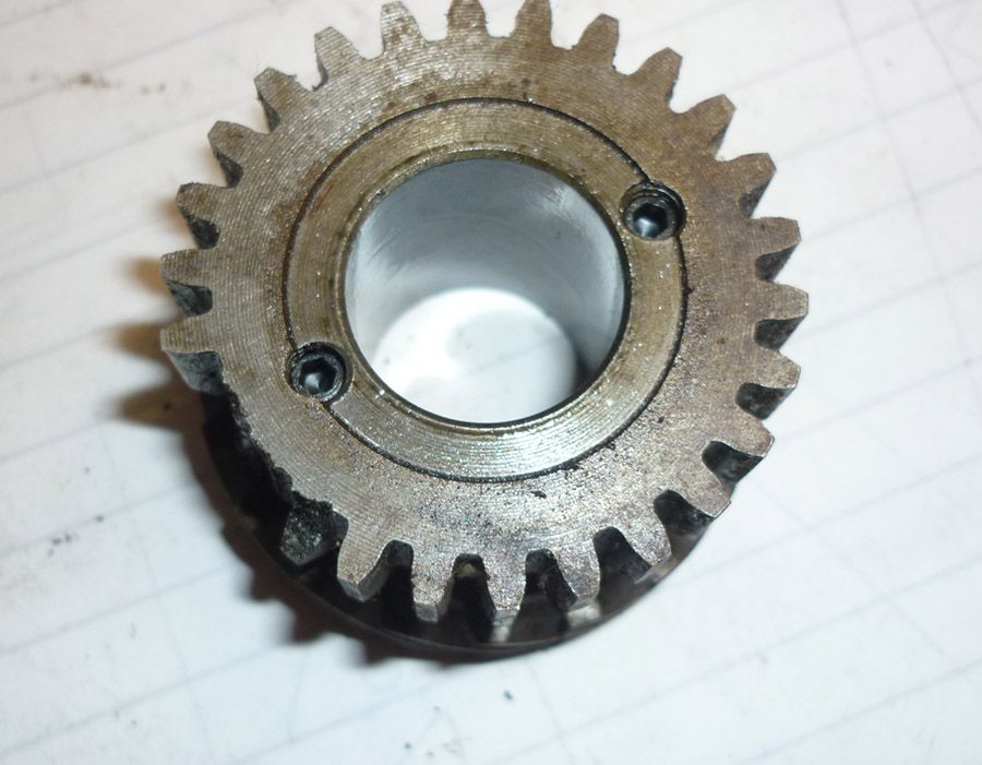

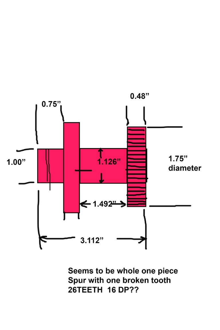

                        John S, ive took some measurements ,sorry about the crappy freehand paint drawings.The measurement may be slightly off due to wear .
                        the second is the one on the same shaft as the worm which the dividing plate attaches.
                        the last is the one attached  by two grub screws in the end to a  shaft with the undamaged helical gear on.

                          Not in work again until Friday so I'll have a look and photograph what i have then.
                          Looks worse than it is as it can still be used as a straight dividing head without these gears and if worse comes to worse you can fit 3 new off the shelf gears from someone like HPC by pinning as ones is already done,

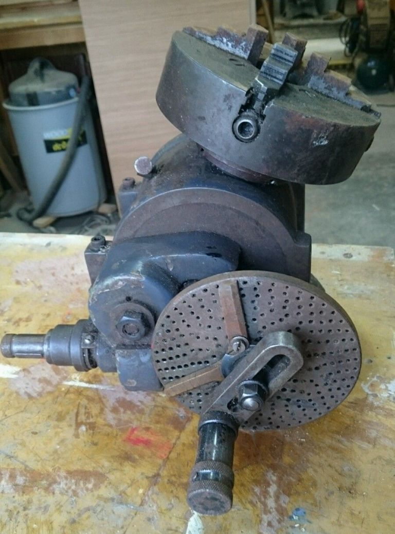

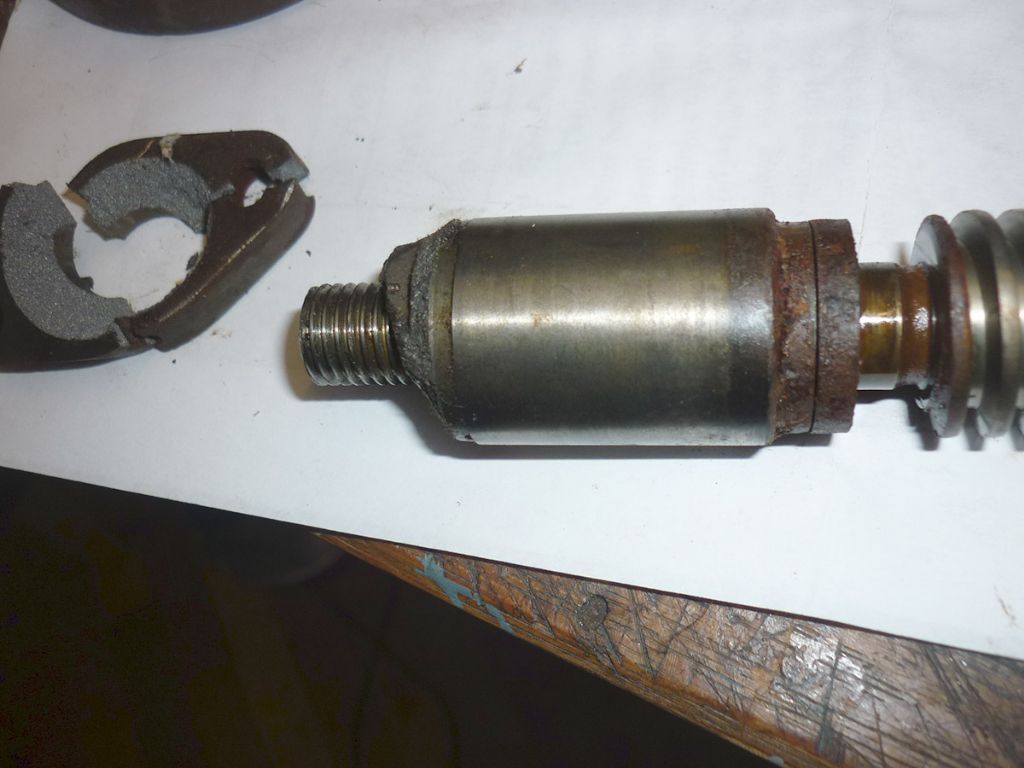

                            Anyone any ideas how to get this out ,its the remains of the broken bushing ,it extends about and inch or more into the main body with the worm shaft going through it . It is whats left after the end of it shattered .
                            I tried filing a couple of flats on eith side but there is hardly any material on one side of it(so hard to avoid damage to the worm shaft.). I managed to turn it on th eflats with a spanner but no change of getting a good grip and wiggling it out.
                            Thanks
                            Edited By mark smith 20 on 07/12/2016 20:48:35
                            #270558
                            Bazyle
                              @bazyle
                              Drill and tap a hole in it, insert a threaded rod and arrange a slide hammer type system to pull it out.
                              #270565
                              Swarf Maker
                                @swarfmaker85383
                                As this bushing retains the worm shaft, isn't it a simple case of withdrawing the worm shaft such that it brings the remains of the bushing out with it?
                                If it's really tight then a tube with an internal bore larger than the bushing diameter and of a length such that the wormshaft nut can be tightened against a washer over the end of the tube, will allow tightening of the wormshaft nut to withdraw the shaft and the bushing.
                                #270566
                                mark smith 20
                                  @marksmith20

                                  Im not sure theres enough room for to  drill a hole and tap unless it was very small diameter?

                                    I`m not sure that would work as it is, as the worm cant be just easily disengaged from the worm wheel. It has, ive been told a split worm wheel instead which would have to be removed along with the spindle ,before i could pull on the worm shaft.Though not certain if im understanding correctly.

                                      The key to dismantling something can often be found simply by thinking about how it was put together in the first place!
                                      I would have assumed that the worm was no larger in diameter than the bushing, otherwise how would it be assembled? Granted, the worm will need to rotate as it is withdrawn from the worm wheel.

                                        I'm not seeing any problem if the flange was part of the whole casting. It will knock or press out from the other side after dismantling whatever is on the shaft (on the other side) or shaft removal.
                                        Looks like the shaft was secured after some form of adjustment on the worm side?
                                        Or is there no clearance to remove the shaft from the other side and won't push out? If so just start drilling or other machining to remove it in small bits!
                                        Edit to add: slide hammer on the shaft, maybe?

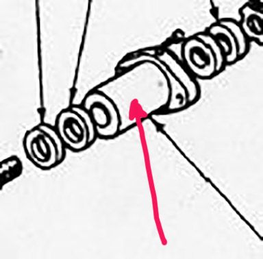

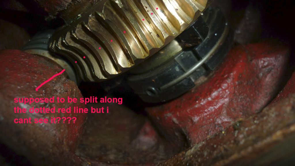

                                          Hi Thanks for the further ideas, i am terrified of breaking any other part ,hence the caution. The other side of the worm shaft also has a flanged bush ,see photo. Although i have the parts diagram i can hardly see anything of the worm shaft on the inside and certainly dont want to strip any teeth on the worm wheel.
                                          The worm wheel is a split type which id never heard of and cant even see the split down the middle . I assume its for some sort of backlash adjustment . Other bigger heads have an essentric shaft to disengage the worm this doesnt. Heres a few photos of the inside as well.
                                          I didnt know what a slide hammer was but looks useful if the worm shaft was clear of the worm gear wheel.

                                            Try turning the shaft, whilst holding the chuck (to prevent it and so the worm wheel revolving), the worm "unscrewing" from the wheel should push the remains of the bush out. Only gentle turning should be used and try turning the shaft in both clockwise and anticlockwise, as you may not know if the worm is LH or RH.

                                              Nick , tried that first it didnt worksurprise
                                              Anyway finally made progress ,i decided only way was to remove the spindle by slackening the locking nut and tap with a hammer on wood on the back end of the spindle. Because the worm wheel is keyed to the spindle the slackening of the locking nut and tapping released the spindle without damaging the worm shaft or wheel. Once out i just put my hand in and lifted the worm wheel out.
                                              Then i tapped on the front end of the worm shaft which drove the broken bush out. The thrust washers on the worm shaft next to the broken bush were all rusted up and one is still rusted on and wont move.
                                              I still cant see the split in the worm wheel ,which must be there as its indicated in the parts diagram and the adjusting screws on the worm wheel itself. smiley

                                                Sorry Mark,
                                                These all came off bigger heads and are far bigger on the gears.
                                                The gear in this pic is well over 2" in diameter.
                                                If you want new gears then for just 3 off HPC is probably the best bet but you do realise you only need these gears for spiral milling or compound dividing.
                                                Normal straight dividing just using the plates doesn't use these gears.

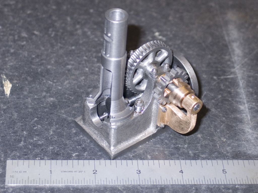

                                                  You might need them if you do any "Spiral Slotting"
                                                  This is part of the clutch on my Pollitt & Wigzell barring engine.
                                                  Phil
