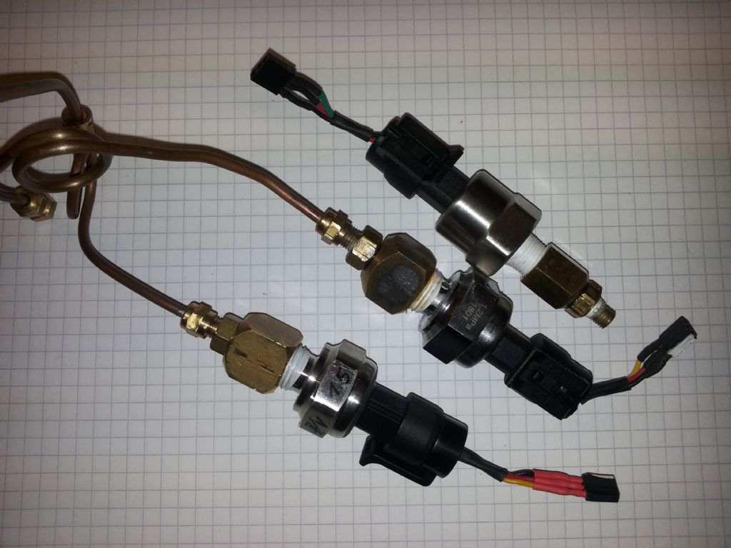

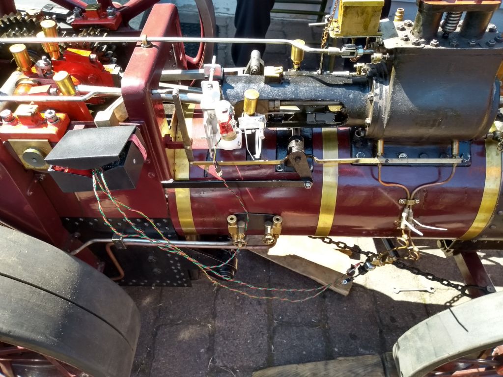

        Hi folks,
        i made some work with my electronic cylinder indication system. My steam friend Jürgen have a nice 4 inch Garret Traction Engine. Last year i showed here the video transport for live steaming.
        Jürgen made some progress with the adjustment of the valve setting until he was satisfied. The engine run for him OK. But sometimes during start the engine behave in second gear like a wild horse. I had build an electronic measurement system to indicate cylinder and found some not good adjusted valve timming in my own locomotive. So I know how good such a setup is to tune the valve setting. With his Garret there is an additional problem, the valve setting changes from cold to warm,because the boiler length changes about 1.5 mm by calculation of the heat difference and length from the drive shaft to the cylinder.
        My setup is based on a selfbuild rope displacement sensor with a return spring in it. It is able to measure 300 mm in total. With this i measure the piston travel.The pressure sensors for the cylinder pressure are capable to measure 12 bar. They are equipped with an integrated
        electronic amplifier and are factory calibrated . It is an affordable China product. The data has been collected with an Arduino Nano and is able to work with 8 Channels. The sampling rate is 560 samples per channel per second.
        It is possible to measure the towing force , the speed and the temperature in parallel.
        The software is my homebrew for the arduino and the laptop.
        I used this system before to optimise my 5 inch locomotives. The attention is to increase the effiency and not the speed of an engine. I like traction engines which are in standby slowly ticking over and this is a sign for a good valve setting.
        My hobbies are constructing steam engines and electronic systems. So is this a perfect symbioses of both for me.
        So I convinced Jürgen and add the measurement system to his engine. At the first step the displacement sensor was tricky to mount and not good aligned, but the measurement correlate to the action of the engine. The next step was to construct a better attachment of the displacement sensor. Between me and him are many Kilometers in distance so i constucted it after pictures and it was attachable with some improvisation.
        The pressure sensor was adapted with tubes, this was the only possible way to make it quick and dirty.
        Please take a look at it. And for shure it is possible to work whitout such a system. Steam engine are very fault tolerant. If there are any question please ask.
        Werner
        Ps the outcome oft the video was , the engine run better after the first cahnge, but there is some room for improvement with an additional shift of the valve.
        Very good is, the measurement and the practice behaviour is correlating.

            in the video it is not good to see, in front of the pressure sensor is a copper tube with one turn for condensing the steam as it is normally made for pressure gauges.

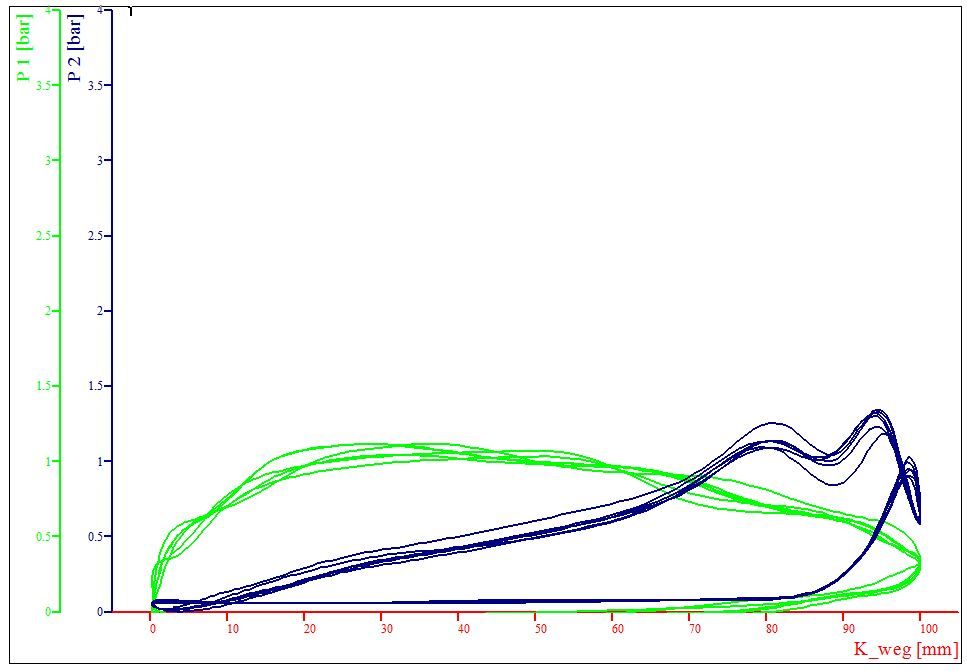

                      Here is an update of our activies from sunday. We made a steam meeting with four road steamers.
                      At the beginning as the engine was cold we change the valve setting of the Garret. With the electronic steam indicator we had after studying the measurements the idea to shift the valve 1.5 mm to the chimney to equal the pressure curves of the valve chambers. In total we changed 3 mm since the beginning. After the engine was under steam it was noticeable that the flywheel runs much smoother as before. Juergen made two long runs with 2..6 and 3.6 km and noticed a much improved consumption of water and coal. A great benefit is that the engine is now better to handle in slow driving. He is really satisfied now. His codriver Stefan noticed independantly the same.
                      Here is the documentation of the control measurements. It was a little bit difficult to film , the interest of the steam colleages was great,but very often someone blocked the camera.
                      But for documentation it is enough. I tried to make it understandable and I hope i reached this goal.
                      It was a good step from subjective feeling now it is Ok ,to see it on the diagram that it is OK. Always fascinate me a smooth running or ticking over engine.
                      Juergen is with the improvements very happy now. I recognized which a good tool I made . The first tests were made with a small 5 inch locomotive and now the big Garret Traction engine for another experience.
                      I hope you can enjoy and understand what we have done.
                      best regards
                      Werner

                        And utube explanation! I wondered why at the rhs end the graph line dips down , and bounces back up… ? What was causing that do you think?

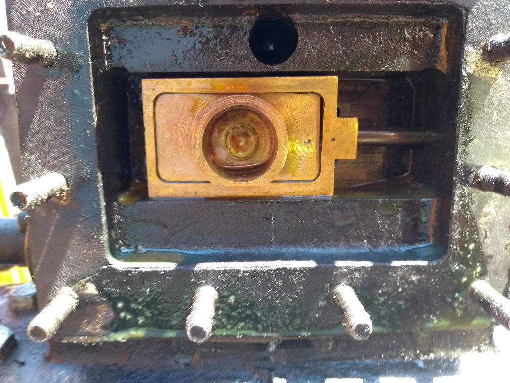

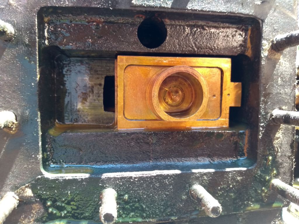

                          I try to explain what you want to know. I made a picture of Juergens valve gear and there is to see that the valve steam channels are casted. The blue side movement from chimney to gear or the rhs in the diagram is not very accurate. The shape is not with straight cut as it is achieveable if it is milled. img_20210611_145236087.jpg
                          For my opinion is this the reason in combination with some marks on the valve running surface that there is in this area the valve is not perfect steam thight.
                          The steam channel on the gear side is more accurate and straight. But in the picture it is not very good to see.
                          And there are many marks on the surface too.

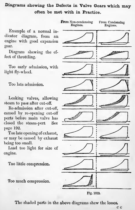

                          When I look in old books i found that from 90 to 100 mm piston displacement the blue curve comes up and the reason is that the steam port to the chimney is closed and there is some compression. Therefore at about 100 mm there is then steam comming in and this cause in a slope, because steam pressure is lower then the compression pressure at this moment of opening the valve. To make this perfect the valve have to be a litlle bit machined in the inside to allow the steam to come earlier to the chimney. If green where mirrored as a blue curve this will be better.
                          If we look to the curve in the old book there is an example which is discribed with too late admission.
                          Juergen made the excenter settings with not very good explanations in the plan, as he told me. He had to interpretate some dimensions. And it was clear he had to decide to screw down the excenter after his measured dimensions. I think the result, after this possibility of possible mistakes, is very good.
                          Juergen want not to change anything in the beginning, he was satisfied with what he had achieved. As I show him which i achieved with my little loco Plettenberg with the first tests of the electronic cylinder indication setup, he gave me a try. I made then some attachements for the rope displacement sensor and the electronic.

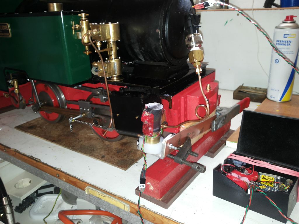

                          The first base measurements were made with lot of improvisation during standing without load. This was not good. The best behaviour for measurements is slow running ~ 120 -200 RPM and under load. As you see in the diagram, there is a very low steam pressure ~ 1 bar during driving in the cylinder.
                          The pressure sensors are connected with tubes, because he had no possibility to screw the sensor pipes to the cylinder. But in the other hand it is good to see that the measurement setup is in function with this circumstances.
                          Here is a closer view of the sensor attachment. For me it is a little bit difficult ,because i make all pictures, video, computer, measurement and calibration by my own. Therefore I was happy Stefan the friend of Juergen helped me with the steam engine.
                          The rope sensor have been build by my own with a multi turn potentiometer and a return spring from an identiy card jo jo. Herbert a modelflying colleague sponsored me with fine steel wire . The accuracy of the rope sensor is in the range of 0.1 mm by 300mm displacement. I compared it to a digital gauge at my mill. This is much better then we need for this measurement.
                          The pressure sensors are chinese ones and i compared them to a pressure gauge with a good result. And they are low cost. The electronic is based on an arduino nano with bluetooth transmitting to the laptop. The software is my homebrew based on freebasic and is coming from DOS times with GW basic. In the field it is easier to act with key commands as with scroll down menus. So it is very good for this kind of work.
                          Juergen is now very happy with the valve adjustment and measurement. He made long runs of 2.6 an 3.6 km and noticed remarkable less coal and water consumption. And he can drive now very slowly and the engine starts now smooth and not like a wild horse as it was in the beginning.

                          #557504
                          Werner Schleidt
                            @wernerschleidt45161
                            Here is the diagram with the principal indicator diagrams.
                            It is from the Handbook on steam engines from Haeder and Powles 1902.
                            Thanks to Vic who sponsored me with informations and web links!
                            This is taken from the side 383
                            The left curve number four with late admission fits to the kind of the measured curves and number two throttlling. For the power of the engine we had during the measurement to less load . Normally the engine have to pull a wagon with some adults as load.
                            Werner

                              I had no trouble translating Biergarten from the video, but what is K_weg (mm) on the graph? I know it's piston distance ('weg&#39, but what's the K_ ?

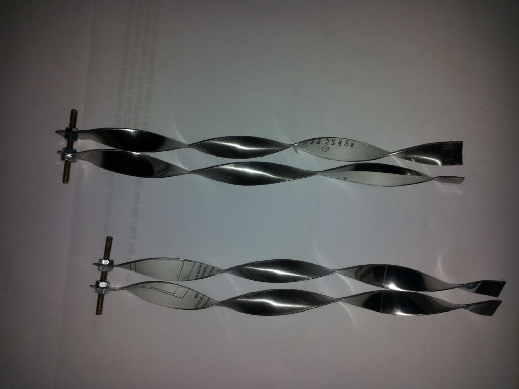

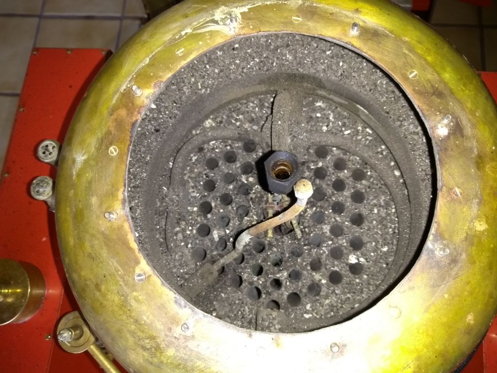

                                a few words to my fire king. It is roughly planned to make indicator measurements too. But this have not so a high priority.
                                The steam engine had a remarkable improvement of the boiler and fire performance with the added steel stripes in the fire tube which is normally for the superheater pipe. Many thanks to Johannes, known as Yorkshire Man, he gave me the hint in a german forum. So i gave this idea a go and test it at my fire king boiler.
                                This stripes hang in the middle wide tube of the boiler. This stripes force the exhaust around this stripes and add some resistance for slowing down the gas velocity. So the exhaust gas have more time to add heat to the boiler.
                                The change was remarkable. I could drive after this with continous blowing safety valves and the fire burns much better. There was only like black sand in the smoke chamber. Before there were much more bigger unburned coal parts and sparks. I changed then the exhaust nozzle to a wider bore. This gave the steam engine less back pressure and so the RPM and power increased. The fire burns a litlle bit worster ,but much better then before I made all this changes. If i drive continously and do not forgot to add coal regulary , I can drive permanent with a pressure short for blowing of. I can control the pressure by adding water or not.
                                Here is a photo with the setup and the changed exhaust nozzle after 11 Km of driving.

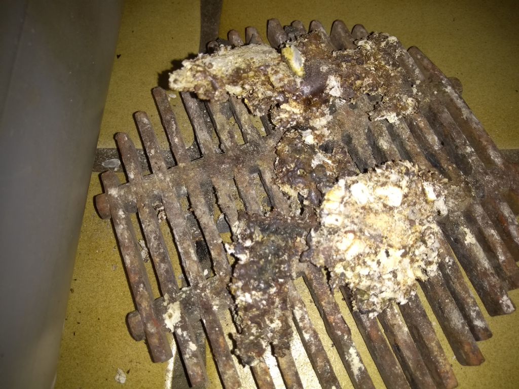

                                And here is the clinker after this ride
                                This was a big improvement.
                                I made measurements with a thermocouple to measure the exhaust temperature and it was clear to see that the fire burns much better.

                                  K_weg is the short form for Kolben Weg or better to understand piston travel. Your deduction was correct.
                                  I try to make it so understandable as possible, but I see there is room for improvement. The same I learnt from my colleagues, at our driving area , they see all ,got explanations, but with the video and additional explanations they understand it complete.

                                                  I want to add more information about the sensors.
                                                  The pressure sensors are china made ones in a stainless steel housing with diaphragma and strain gage amplifier and ready calibrated. They are made for 5 V excitation and have a range from 0.5 volt to 4.5 Volt. I compared them with a normal Pressure gauge with good results. For my software i marked them with the parameters i have to add in the software for the correct span and zero adjustment.
                                                  I made adapter from 1/8 BSP and 1/4 pipe thread to M6*0.75 mm for easy use with my model applications. The sensor is very cheap ( < 20 &euro for the quality and good for field measurements. I found no noticeable drift.
                                                  The connectors had been changed to rc model type ones they are simple and cheap. If they were pulled out by accident there is no damage possible. I secure them with tape and add numbers or a discription to know hwere they are installed.

                                                    The displacement sensor or the piston travel sensor is more tricky. I want to have a sensor who is on small and bigger engines possible to install. I had an incremental angle sensor this is very accurate but it have to be attached to the axle or flywheel and that is not so easy without changes at the model or object. I get by chance a very fine LVDT displacement sensors with a carrier amplifier and inbuilt electronic. To meassure 100 mm the sensor is about 300 mm long. This is difficult to mount. So i came to the results that the sensor mechanism with a rope like in the old indicators is very favourable. So i thought about about how i can build a sensor. In my former job i know rope displacement sensors based on a rope a return spring mechanism and a rope drum and a potentiometer. This parts are very expensiv , the range is from 500 to 1000 €
                                                    So i construct my own. The base is a multiturn wire potentiometer with 5 Kohm , a drum which is coupled with the potentiometer axis and a return spring i got from a identicard jo jo. This were my parts which play together to operate the rope sensor. My modelplane colleague Herbert sponsored me with thin multiwire control line rope.
                                                    It was very tricky to bring all parts together and after the first one i made two others all in a range of max 300 mm. I tested them in comparison to my digital gauge at the milling machine. The measurements were very repeatable and with a good accuracy. I added a small amplifier with a filter for cutting noise and with a level shifter for easy zero shift adjustment. The span was precalibrated at the amplifier and a fine calibration can be made by software. All sensors have a unique calibration file, but the rope sensor are very similar.
                                                    To give you an idea from my sensor
                                                    The spring is in the frontside of the drum . In the front cover of the housing there is a screw which is the spanner for the spring. The tricky part is adding the rope winding by winding in the right direction and spanning the clock spring and setting the potentiometer at the correct position. This is a four hand job, but with several try's it worked good. The amplifier ist then attached to the potentiometer and then it was added some heatshrink tube. Then the parameter and calibration was measured and marked at the sensor.
                                                    In the next picture it is adapted to my loco for measurement.
                                                    The pressure sensor is connected to the cylinder cover. The rope sensor is mounted with some improvisation with clamps and wooden bars at the front. The rope is connected to the crosshead by a chain and a adapting screw. The white PA part allows clamping of the sensor and some adjustment.
                                                      In the small box is an arduino nano with the connector bank for the eight analog channels , the bluetooth modul with 115 Kbaud and the power supply based on old laptop cells. The power supply is able to work with eight sensors for two to three hours.
                                                      On the laptop screen there is a test measurement of 30 secs to see.
                                                      In these many curves is the start , some braking with load and the stop to see. This is a kind of overall info as you can see it during measuring .After the stop the data have to be stored. I can measure several tests and store them with usefull short names. After a stored measurement i can reload it and look in the time frame for interesting parts. In the time frame i can look if there are two to three similar curves and with the start and end point I can plot them then in a xy diagram. Is this in running condition on the track i calculate the average pressure and the rpm of the engine. With the piston size , travel ,rpm and average pressure the power in this cylinder chamber can be calculated. This is possible but it is difficult to run the engine under full load. I use the system as a tool to see the begin of steam come in and the shape of the curve. So i can adjust the valve gear. I do not like try and error methods as i made it befor i have this system.
                                                      My experience at the moment is, it work good, gives good results , but the software and the procedure how to measure need some fine tunning for more comfortable use in the field. And one thing is at the moment clear, i see it as i measure Jürgens engine. All visitors are exited to see the result immediatly and this is only possible to see in the overview as it is in the picture above. I have to add in the software during measuring some markers for the constant driving or something like that.
