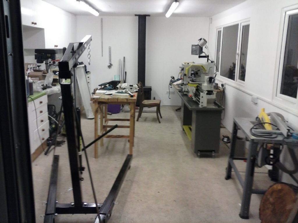

      My shed was purpose built circa 10yrs ago. Low dwarf wall and insulated concrete floor, stud work with insulation, vapour barrier and uovc cladding, light weight faux steel tiles and ply lined with double glazed uovc doors and windows. In other words dry.
      Professionally wired with 60a incoming line and sub consumer unit. Breakers fir each row of wall sockets, one breaker shared between both runs if ceiling lights and fourth breaker for external security lights .
      There's a 4 gang light switch one for each ceiling run and one for each external light..the originals could be switched to stay on and override the movement detectors and toners. This floods have long since been changed to simple led security floods without that override.
      Some months ago the inside lighting breaker was tripping whenever either ceiling light set was switched on. At the time I had enough other stuff going on and left it be.
      With the darker evenings I figured I'd better sort it and opened up the light switches expecting to find a short. Everything in their looks very neat and solid. Before starting to look for problems in both ceiling runs I tried the lights again and they now work . Multiple goes on the switches and no problem.
      Ok so for the moment I just use it but any ideas for an explanation? Insects got in the consumer unit? Temperature change with time of year?

                                cam00243.jpgThis is an old pic of my shed shortly after completion. Roof pitch quite decent and clad in some galvanised steel sheet tiling that has cosmetic brown grit on its surface. The tiles interlock quite robustly. There is no sign of damp on the shed ceiling which is flat inside.i.e cannot see the internal pitch. Again this is insulated ply sheeting.
                                Consumer unit is a main 60ARCD with 4 MCB's the lighting circuit NIDCB06
                                Some 3-4 years ago I converted the 6ft fluorescents to take LED tubes.
                                Again an old picture from my album but you can see ceiling type and light arrangement. Back then a pair of fluorescents each side (now LED) and the whole shed doshed out in white emulsion. I'd have expected any damp to show up well.
                                I won't try and guess what the wiring insulation is – looks like ordinary domestic stuff to me and yes the earth bundle in the switch gang is sheathed properly.

                                  (off topic) First pic made me laugh I'm afraid, having read many posts asking for advice as to how to shift lathes, milling machines etc – you obviously had that part of setting up well thought out!
