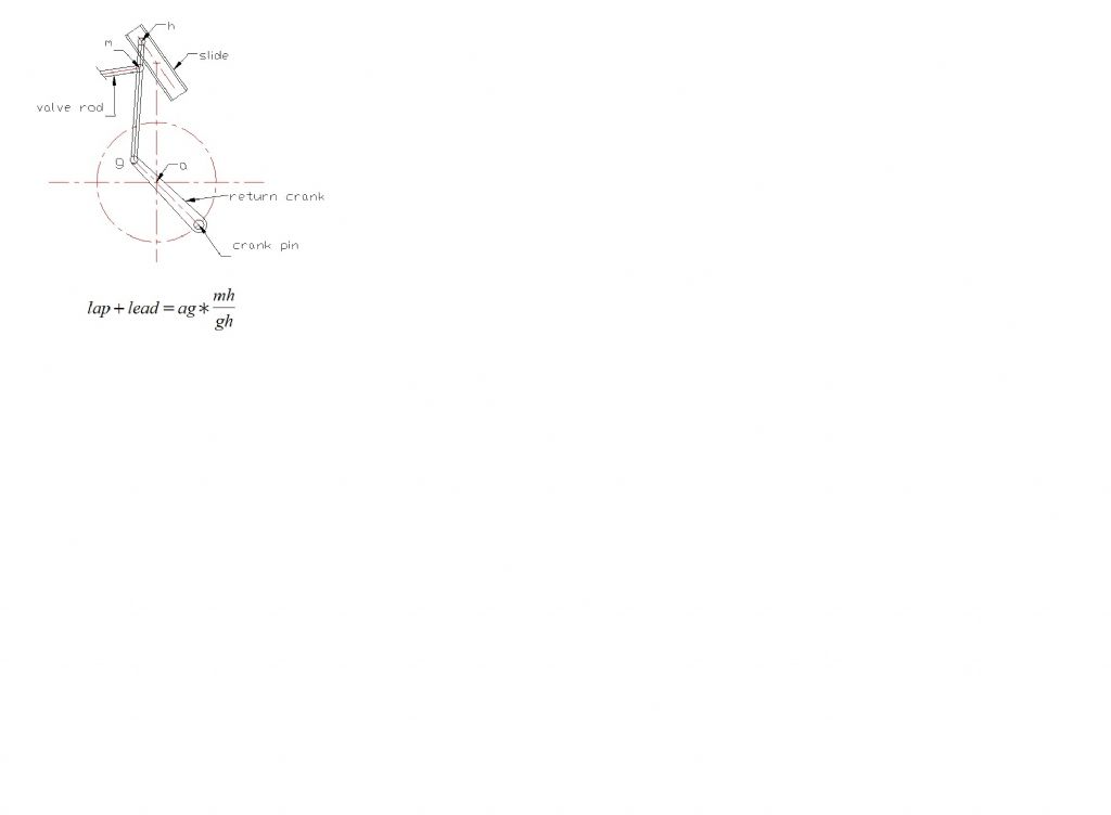

                            The mid gear valve travel is determined by the return crank radius and the dimensions of the vibrating lever. If you just set the lap without reference to this you could get too much or too little lead. I don't want to open another can of worms, but 0.01" is plenty of lead in 5"g loco.
                            If this doesn't make sense, I'll post a sketch. Don't expect brilliant valve events, Hackworth is not a good valve gear.

                                Set as in decide upon. Once the length of the valve is decided on the lap and lead are fixed as well

                                                That's not correct, in mid gear you should get 2*(lap+lead).when I get home I'll post a sketch

                                                    @duncanwebster1
                                                    Well if about half the maximum valve travel is 'hardly any' we must live in different universes. If for instance you had 0.125" lap and 0.01" lead, at a cutoff of say 80% the valve travel would be 0.58". The valve travel at mid gear would be 0.27". Once you've got the valve gear made, lap+lead is fixed, nothing to do with port width.
