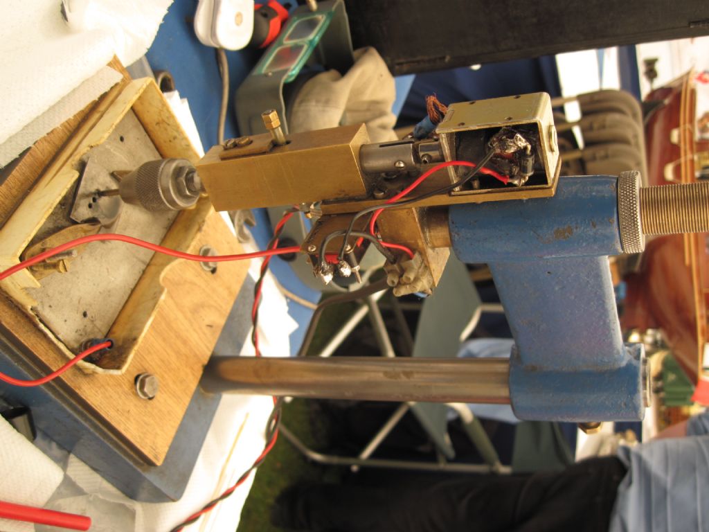

                                    Much as I'd like to build something as sophisticated (and impressive) as the EDM machine JA has built – I'm afraid it's never going to happen at this stage in life. However – whatever their limitations – there are much simpler designs around that I might consider building – especially for the removal of broken taps and making small 'oles-in-ard' things…
                                    I saw this simple EDM set-up at Guildford MES in 2016 – and had a chat to the builder (sorry I did take his details but cannot find them att). As I understand it, an electromagnet pulls the anvil up until a capacitor fully charges, where upon it falls back and touches the work, thereby discharging the capacitor – and causing the required spark – the cycle then repeating ad-infinitum. A very simple concept and no complex electronics required.
                                    I'm not sure if this is the same as one of the other EDM systems already mentioned and there may well be all sorts of limitations associated with this simplicity – but it would certainly cover most of my (admittedly) limited needs…and the work samples shown were quite impressive…
                                    Regards,
                                    IanT
                                    PS Sorry – image started off right way up but seems to have done a 90 degree rotation on up-load…
                                    Simple EDM

                                      the Guildford one may be that by Maurice Fagg – on the SMEE stand? – it certainly worked on the same principle + I recall it being there in 2016 + 2017 but in a more skeletal version.

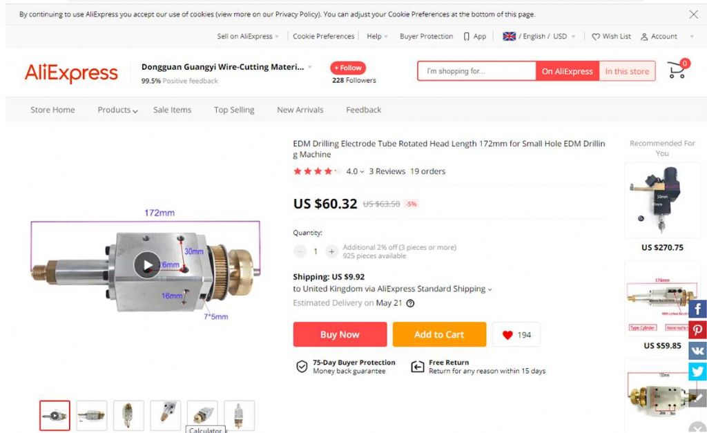

                                                  I was looking at this for my EDM head:

                                                    You do not need to rotate or oscillate the electrode for successful EDM. In fact doing so will reduce accuracy of cut, because the motion will need clearance to work, and that clearance will be multiplied by the distance from electrode tip to rotate / oscillate mechanism , cutting the hole much larger than the electrode.
                                                    An accurate linear slide to hold the electrode, and a DC gearhead motor or servo to operate a leadscrew to drive the slide up and down are all that is needed, if you use the Ben Fleming design. If you are going to spend some cash, get a decent linear slide and forget about rotating the electrode with the apparatus in your picture.
                                                    I built a Ben Fleming Mk.1 conventional EDM (sink) machine in 2009-2011 with such a slide (from Deltron in the USA) and some other variations and it has worked great since. If I make copper electrodes .003" smaller than the desired finished hole dimension the holes (whatever shape) come out VERY close to dead nuts on size.
