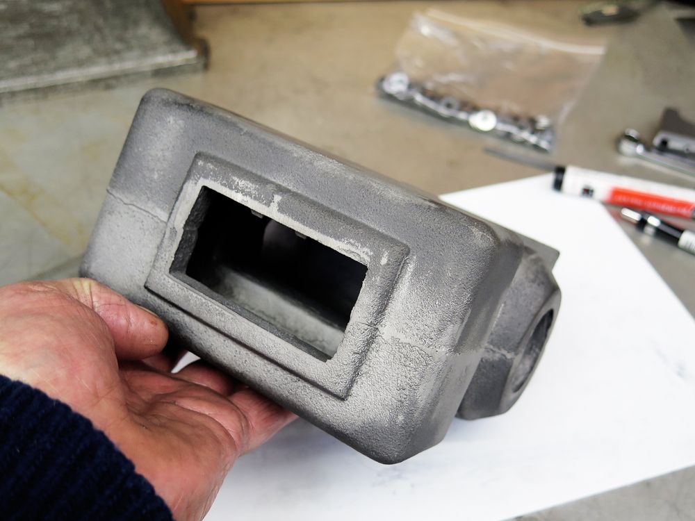

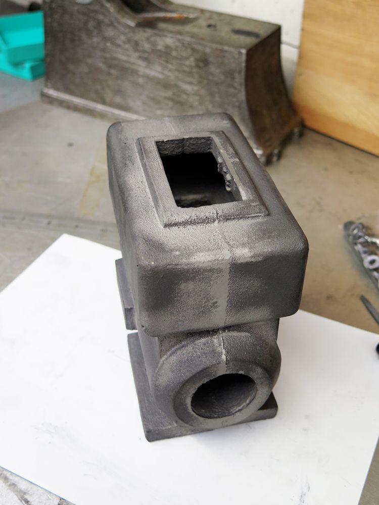

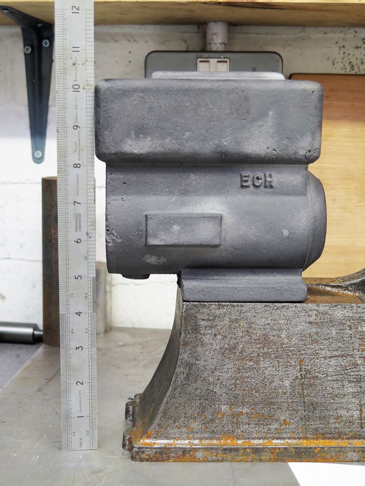

                    Anyway. The cast iron casting for the cylinder / water hopper turned up today. Postman remarked that everything I seem to have delivered is heavy. laugh
                    Nick

                        Posted by Michael Gilligan on 07/03/2017 19:30:26:
                        That 'looks the business' Nick yes
                        I just wish they would not have letters or numbers on the castings as I have to grind them off.!
                        Nick
                        #287624
                          I hate that too, often done with a Dymo lable, suppose it helps the foundry keep track of patterns and castings. Could so easily have put that number on the push rod pad where it would get machined off.
                          #287691
                          Ian S C
                            @iansc
                            Why take the numbers off, full size motors have casting numbers on them?
                            Ian S C
                            #287695
                              If the number is not a scale representation of the originals then I take them off, some do replicate the original number so in my case they stay. I have even been known to add lettering/numbers but i try to do it to scale not stick a dymo lable oncrying 2
                              #287926
                              Ian S C
                                @iansc
                                I see what you mean with the number on the hopper opening, it looks likely to be a Dymo stick on, I was initially looking at the letters ECH on the side.
                                Ian S C

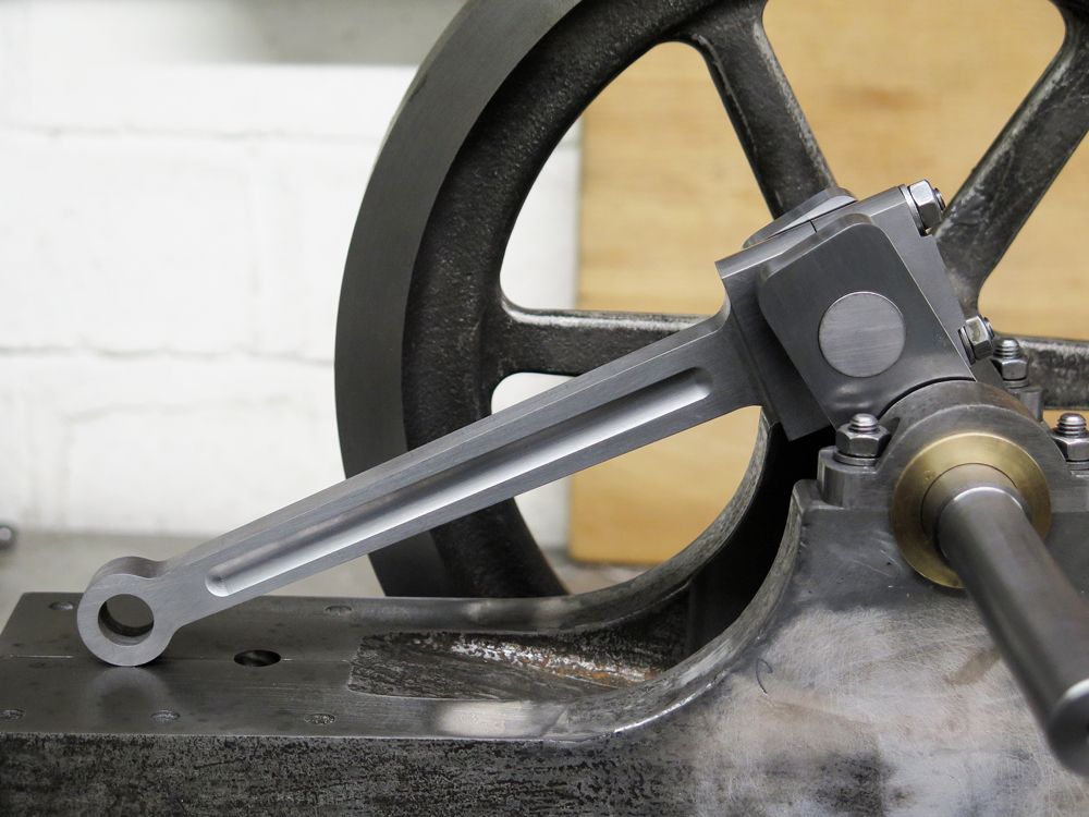

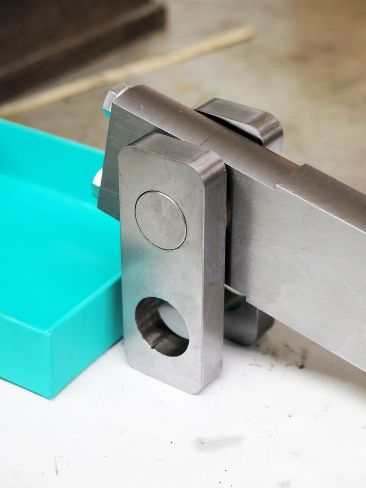

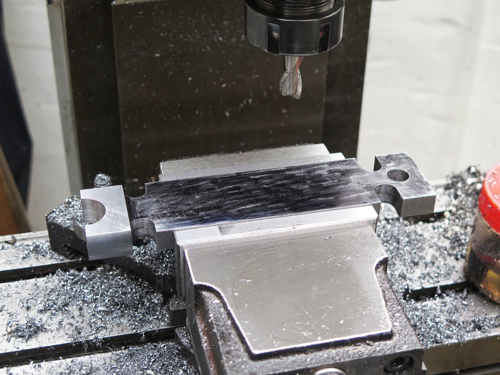

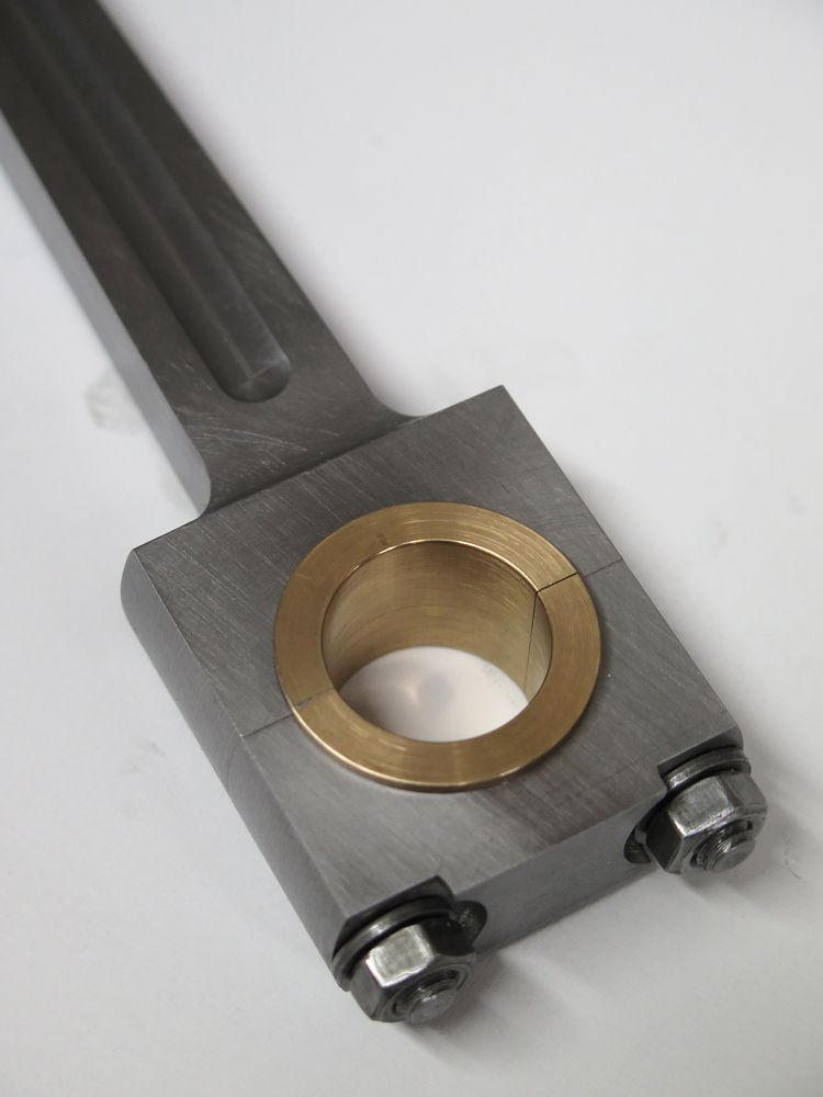

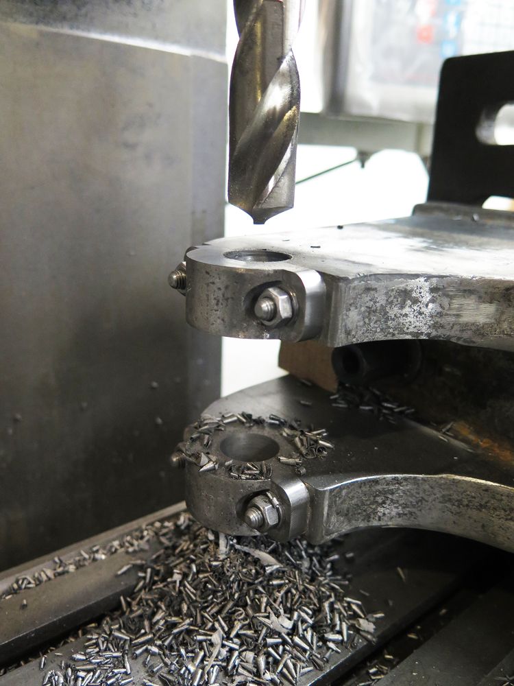

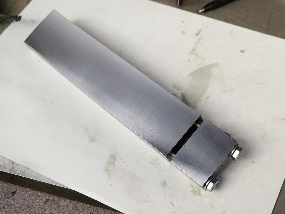

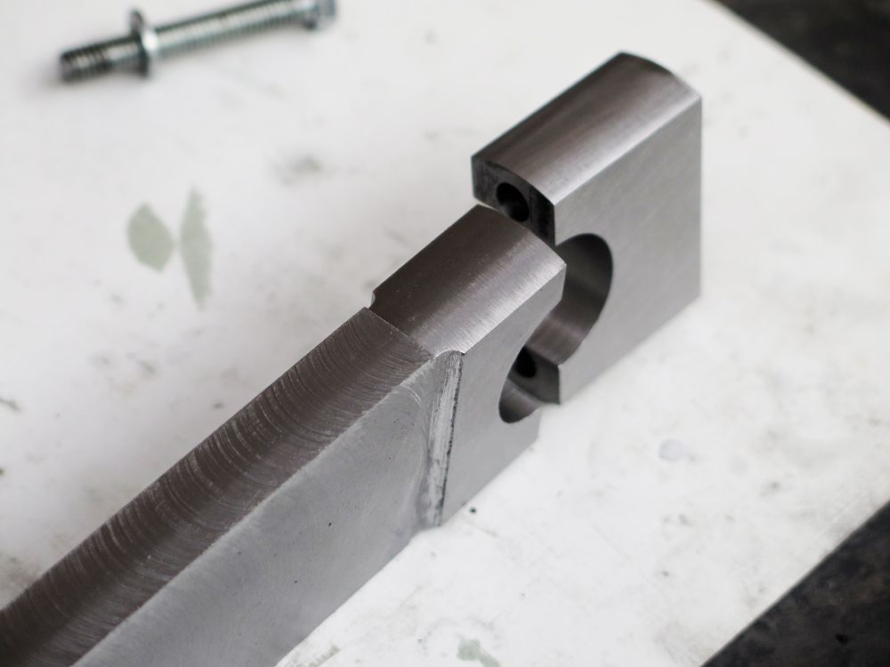

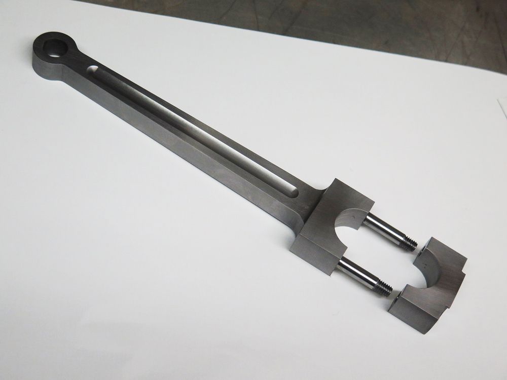

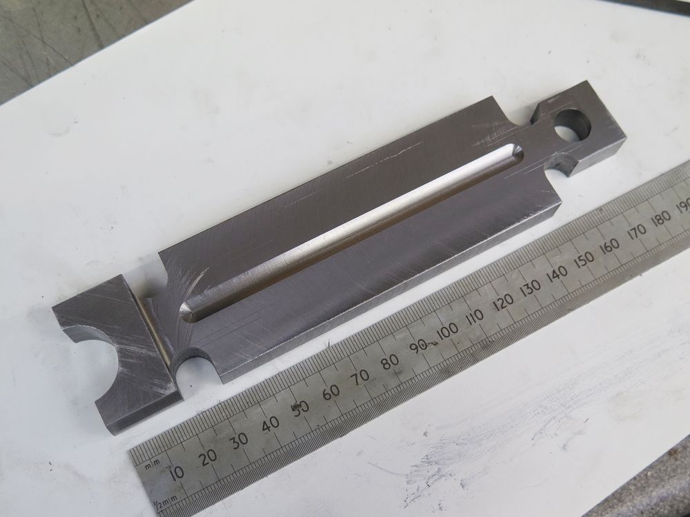

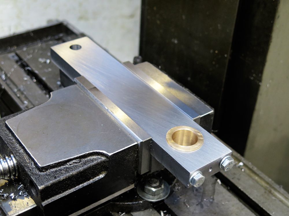

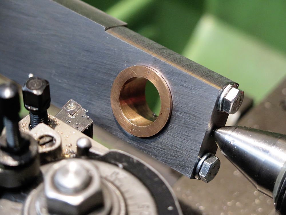

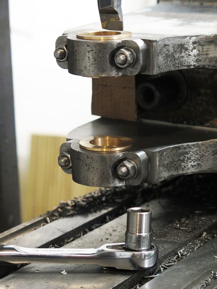

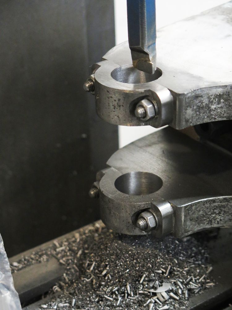

                                  The conrod.

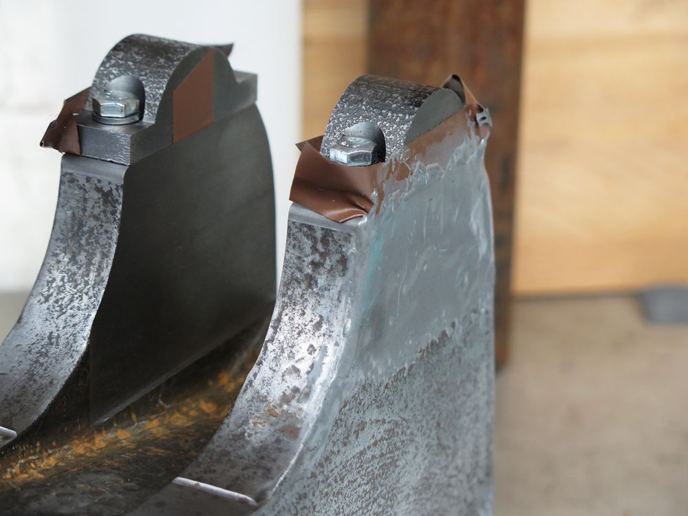

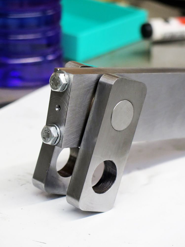

                                  I eventually got 2 pieces down to the major size required and drilled and tapped. The big end cap is a little longer as I want to turn a section in the lathe and then shorten it to remove where the live centre recess has been. – This rounding is not on the original drawing as it's shown as just a block. I thought it would look a bit better.
                                  Decided to get the holes in each end while it was all a uniform shape and simple to grip. This is the first time I have used a boring head in a mill but there was no drama.
                                  Checked the size of the split bearing (made previously) that is still soldered at the joint.
                                  Then split it and checked it against the big end it's self. – Mmmmmm, twas a little tight. sad Not much, so had to lap the 2. A conversation with Jason gave me advice on the best way to do this.
                                  Over to the lathe for that rounding shaping I mentioned.
                                  Milled the sides down to the required width.
                                  Then milled in the roundings for the taper of the rod. – By now I was getting concerned of doing something stupid and ruining a part that by now I had invested considerable time into. frown
                                  This concern reared it's head when it came time to cutting the recess groove along the side of the rod. It should be following the line of the rods taper. But I ran out of balls.! I admit it would look better so I really should have grown an extra pair and gone for it. blush
                                  Milled into the edges to form the taper and round off the little end.
                                  Made some proper studs from 6mm silver steel and shortened the bearing cap to length.
                                  I still have to make the PB bearing for the little and and drill in some oil holes etc.
                                  I will remove all the tooling marks and give it a polishing when it come time for final, final, final assembly. That way I will hopefully not do my normal trick of bashing, dinging and dropping totally finished parts during the rest of the build. crying
                                  Nick

                                            Soldering the joints on split bearings can be a little hit and miss on the final diameters once split. If you put/use just 0.0010" at each joint that would give you 0.0020" on peripheral length, divided by pye would mean that when the tinnning/solder was completely removed after splitting both the original machined O.D. and I.D. Would reduce by 0.0006" and more than that pro rata if the solder/tinning is thicker than 0.0010". Not easy to control.

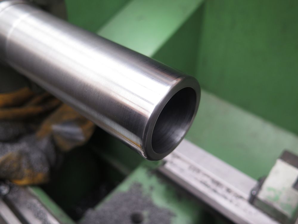

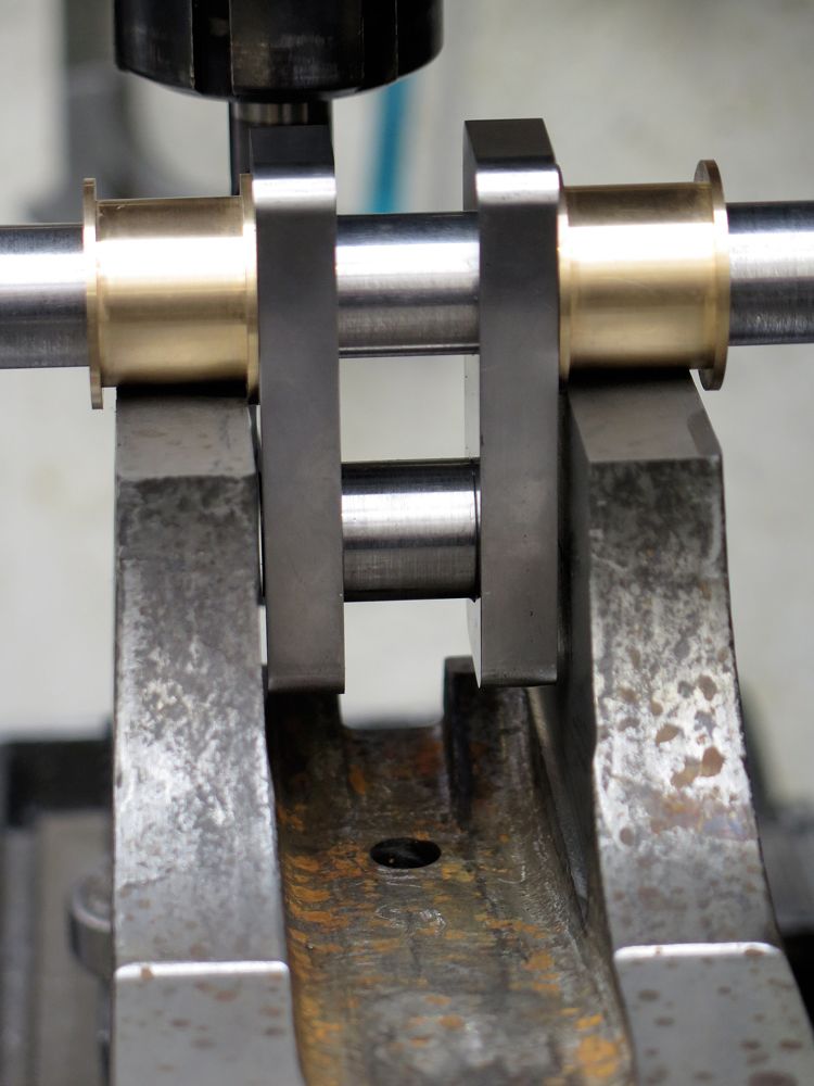

                                              I have spent the last few days doing a 'mish-mash' of several things not really concentrating on one particular area or part. i.e. making studs, rounding bearing caps and part finishing the cylinder liner etc. – This was most;y due to be having to build up width of the tops of the crankshaft pedistals as they were shy on width of about 1.5mm once I milled out between them to allow the crank webs to be able to pass. I did this with JB weld in several layers, each of these taking 24 hrs to cure. …………… Andrew Johnsons solution would have been the better option had I not already made the main bearings.
                                              Milled to give clearance for the webs to rotate. The lack of metal on the outside of the bearings can be seen.
                                              Started to build up the lacking width with JB weld.

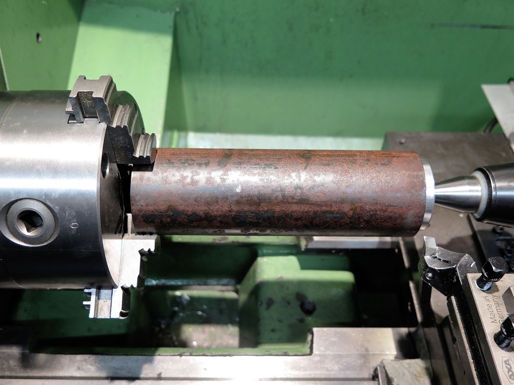

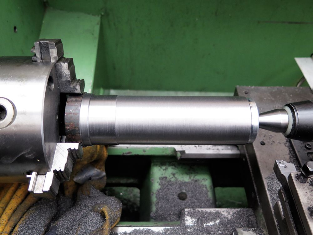

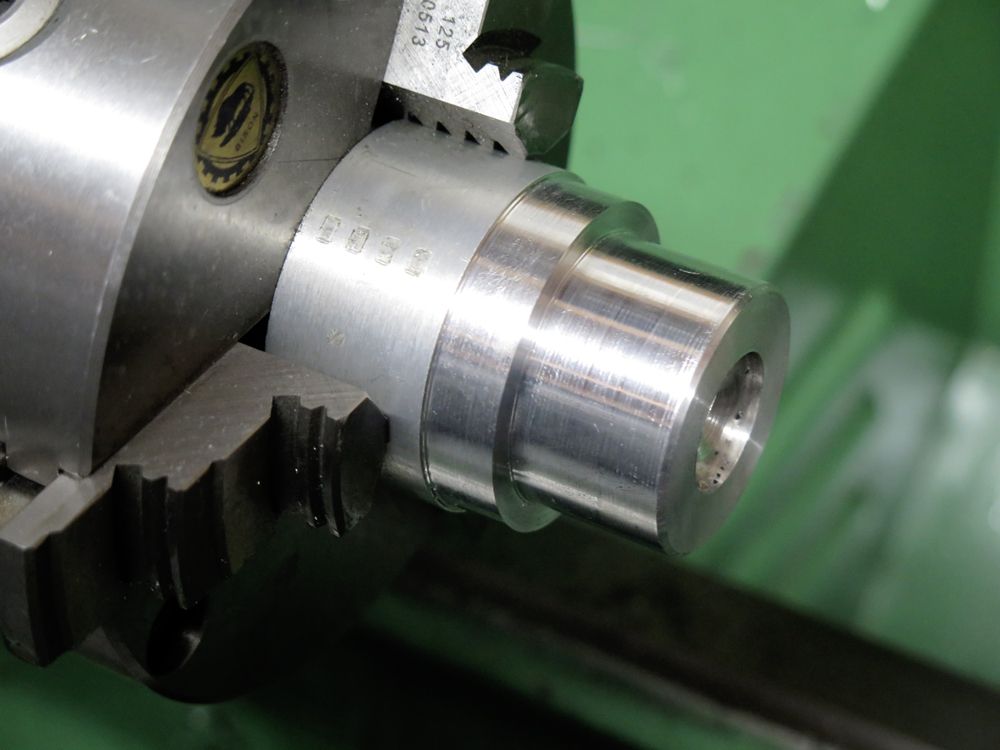

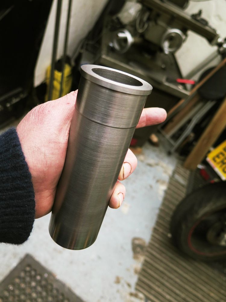

                                              Decided to start the outside of the cylinder liner. So went to my mates workshop to put a hole through the solid cast iron blank. This was 38mm and the bore will end up at 42mm.
                                              So first made a stepped aluminium mandrel to 38mm to support at the tailstock end while I machined the outside.
                                              Thus :-
                                              There are 3 different diameters to the liner. The smallest being 50mm (bore will be 42mm)
                                              Rounded off the crankshaft end as a short section will protrude and be visible once it's in the hopper and I will not get the chance to do it easily again.
                                              Parted off to the correct length.

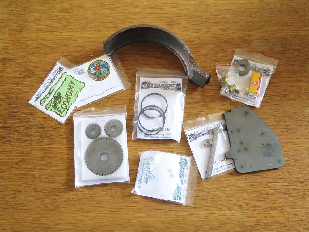

                                              Had a delivery from The Engineers emporium of parts. – They do a very good deal on them if they are ordered as a batch. I was going to have a go at cutting gears myself for this engine but was not really worth it with the deal by the time good quality cutters had been bought.

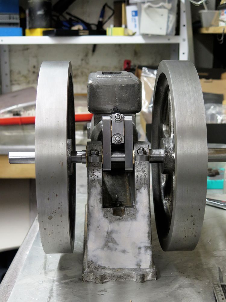

                                              Could not resist having a little layout play to get the general feel of things.

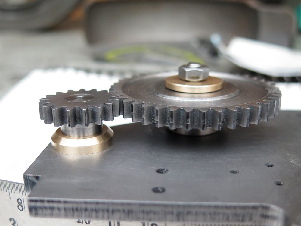

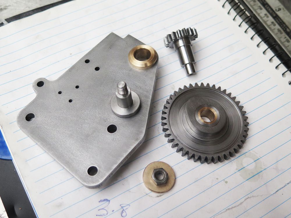

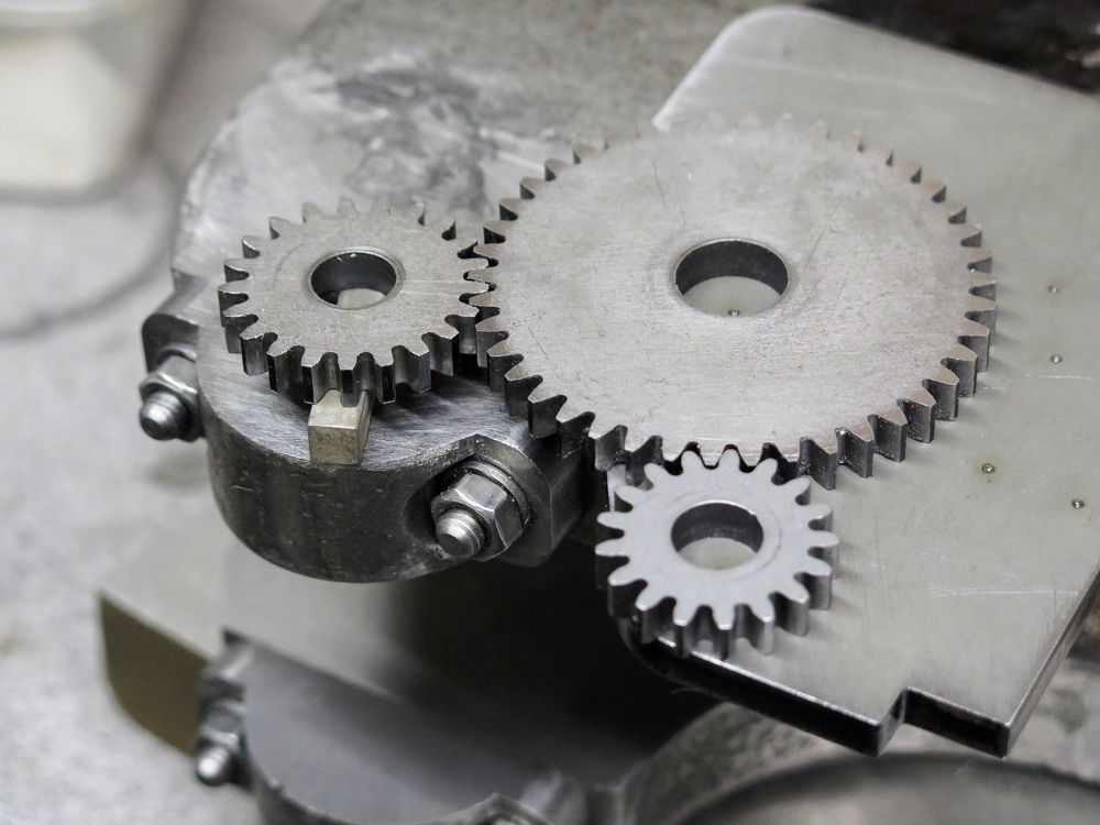

                                                Decided to do a little on the timing govenor plate and gears. – So spent a while drilling out the plate, boring gear centers, making PB bearings and shafts.etc.
                                                The plate was supplied laser cut. Nice.! But the edges where it had been cut were as hard as the hobs of hell.
                                                THEN LOOK. surprise – This is the 3rd time today I have done this.!!!! – I never usually do this at all. Then I do it 3 times in as many hours. – Time to call it quits for a while I think. blush
                                                I have a large angle plate now. borrowed from a friend so I can bore out the base to accept the main bearings. So I will start that with a fresh head. – I really cannot afford time wise and certainly not financially wise to make a dogs danglers of that bit.
                                                Nick

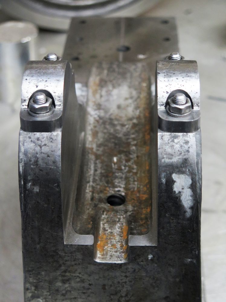

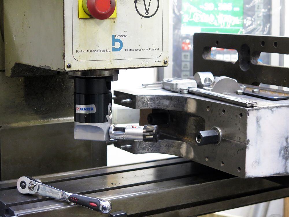

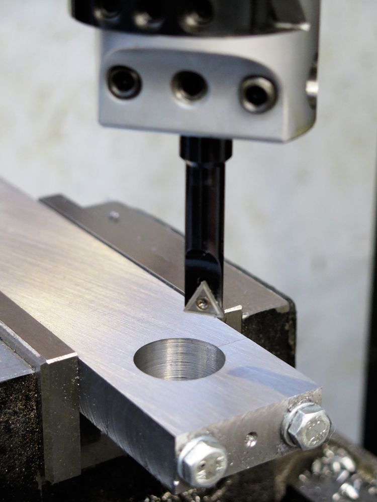

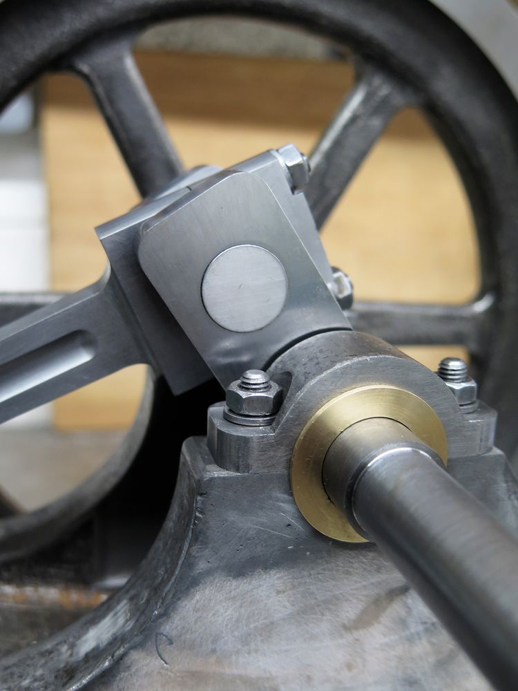

                                                  After a break it was time to carve out the base to accept the main bearing.
                                                  The squareness of the casting in the important areas was checked and adjusted until I was happy. One of these was checked with the laser indicator.
                                                  Castings were step drilled in stages until I got to a 20mm drill.
                                                  Then using a boring head in enlarged to the required 26mm
                                                  And the main bearings test fitted. – They did.! smiley
                                                  Then the moment of truth in seeing how the crankshaft fitted. – Rotating smoothly but without any play.
                                                  I still obviously have much to do. But getting the bearings in means things are starting to come together and I can now establish the final positions of much more. It's actually starting to look like an engine.! smiley
                                                  Nick
