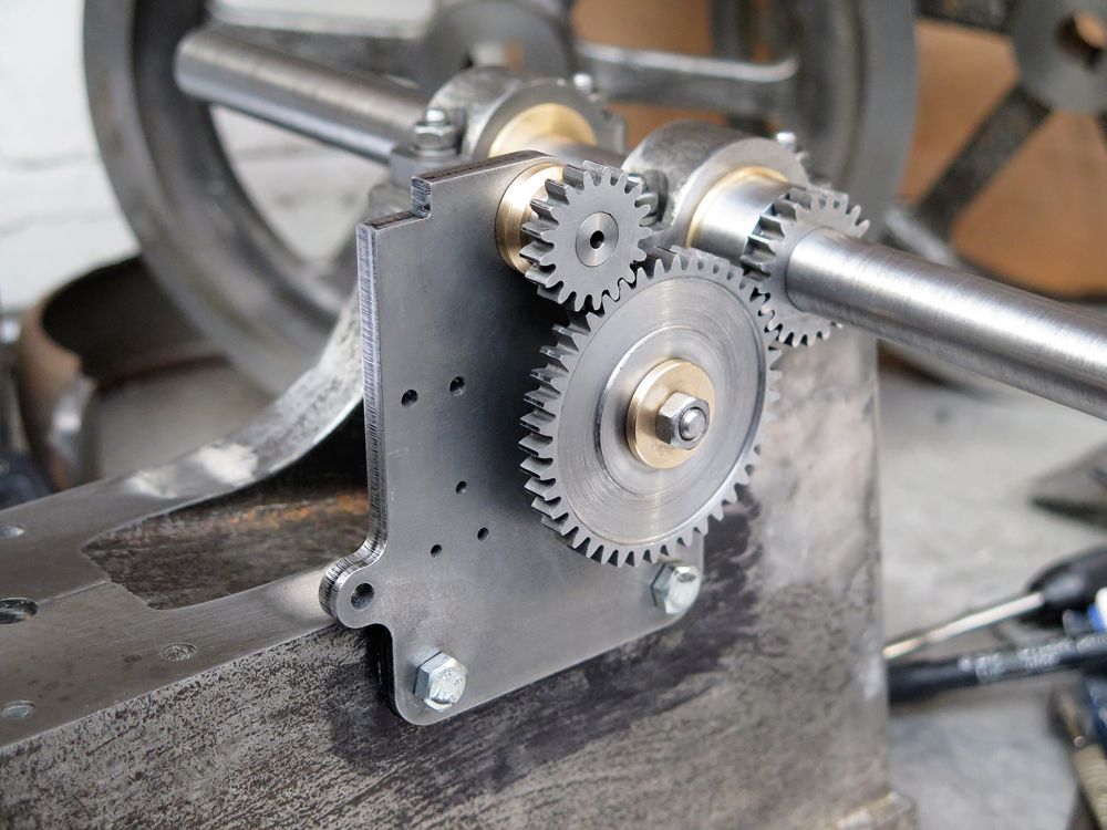

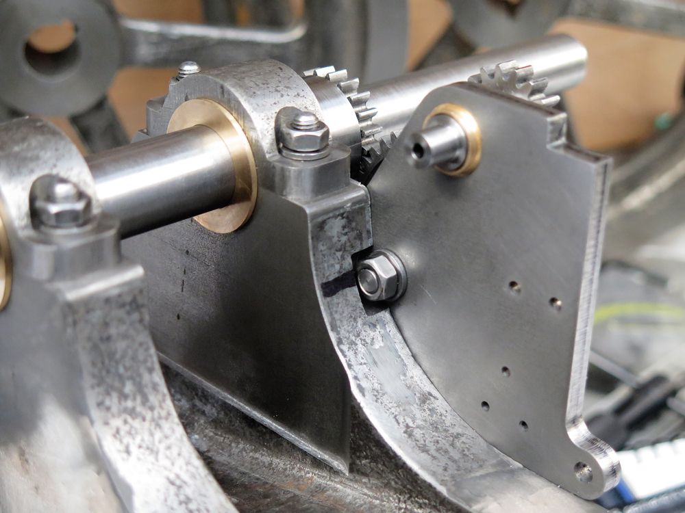

      Cut the recess into the base casting and made spacers etc. so I could mount the timing plate and gears.
      This meant I could get an accurate length for the crankshaft on either side. I also drilled and pinned the crank through the webs and shafts and drove in 638 covered 5mm silver steel. – Then to the mill to cut out the centre section of the shaft.
      Which means I can now do this :-
      Nick

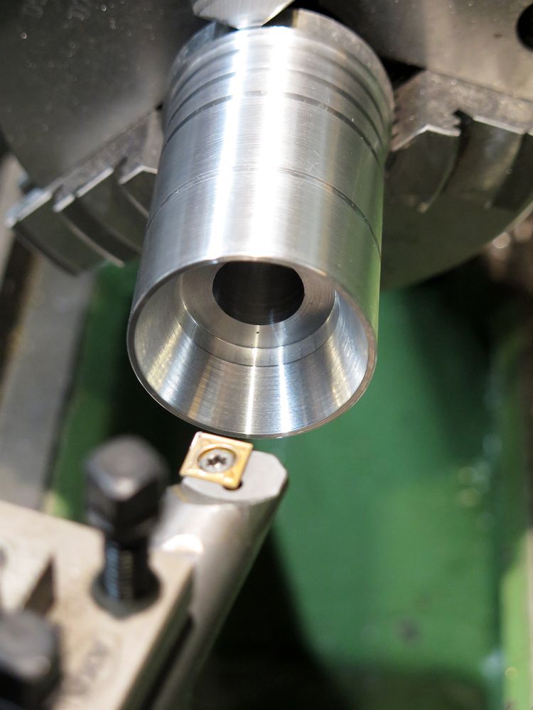

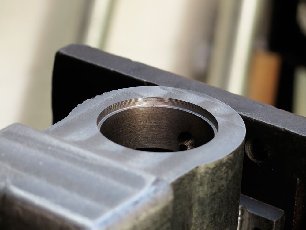

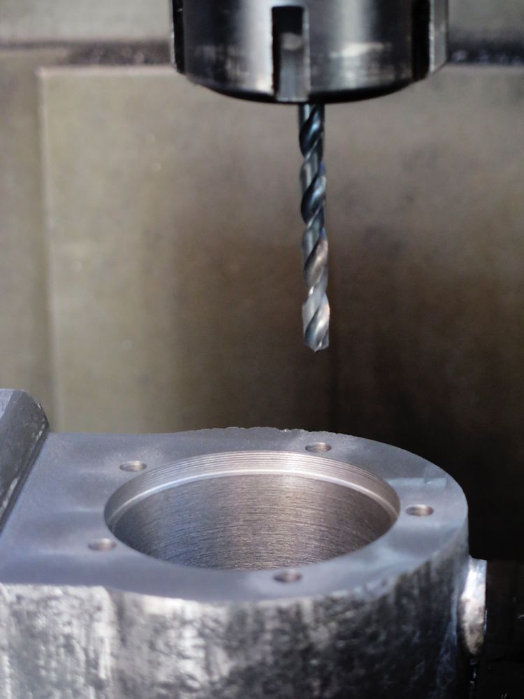

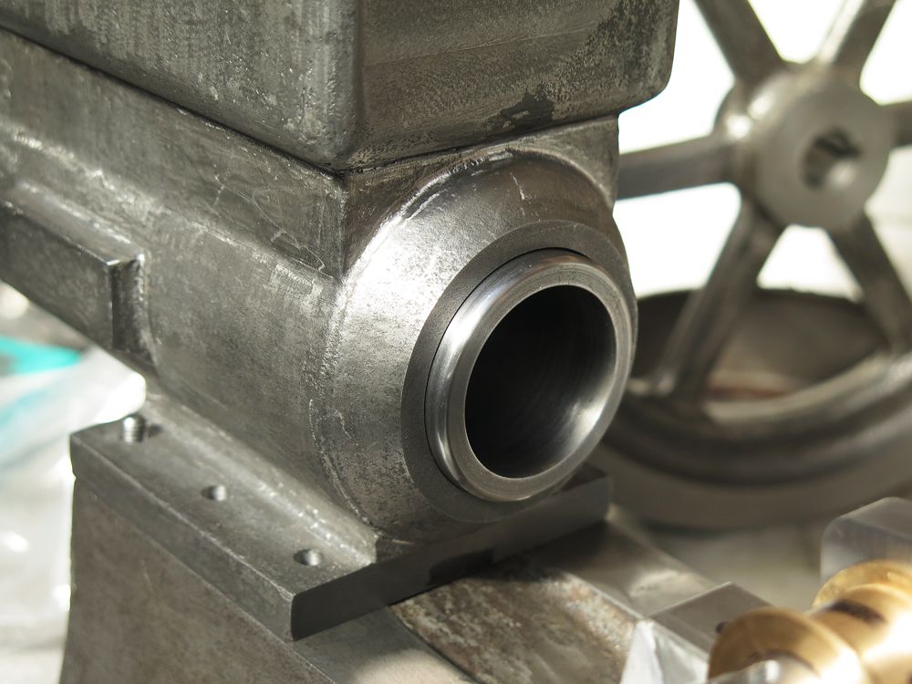

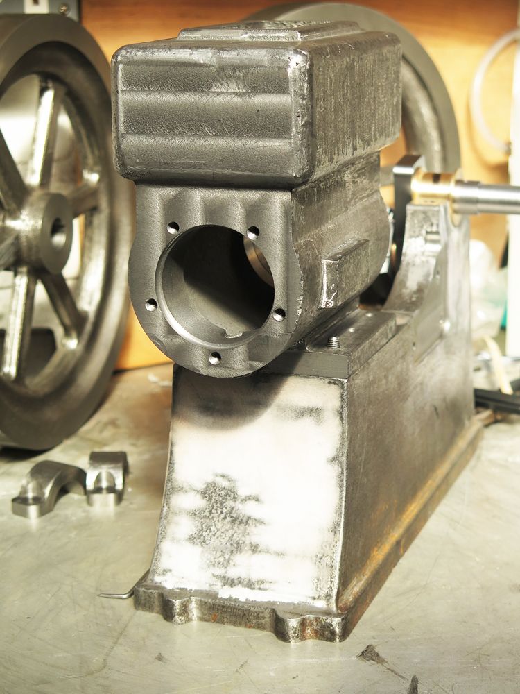

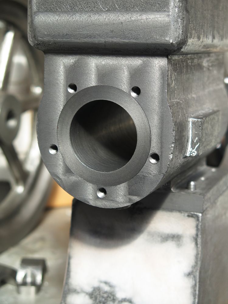

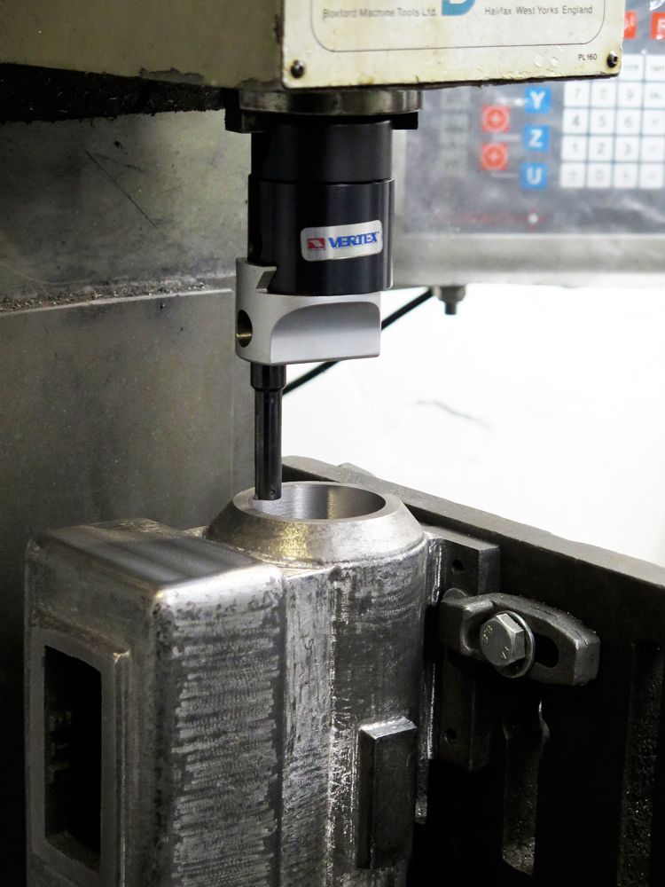

          Time to bore the hopper which will take the cylinder liner. This took quite a bit of head scratching and ummm-ing and arrrrr-ing of where to start as being a casting there was no true reference point. So after some deliberation I made some milling cuts that I could use as such. There are several axis with this part that have to be correct. – Some visual and some important from an engineering point. One of the visual ones is that the liner protrudes as true / central as possible through the taper at the back of the hopper.
          No going back now after this first boring cut to accept the liner.

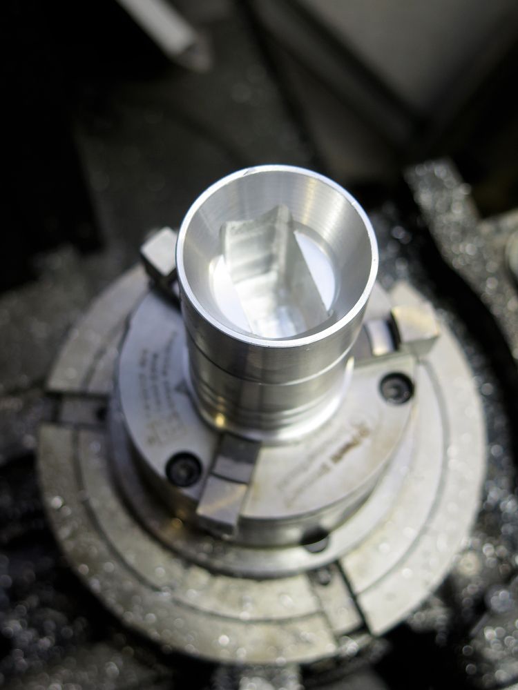

          The tricky one was to reverse the casting and bore the face on the cylinder head end so that it lined up spot on with the bore at the rear. This was done with the ref cuts I had made, a lazer edge finder and my blessed DRO. – there is also a step in this hole to accept a flange on the liner.
          I resisted the temptation to check a good alignment for the liner as while I had the DRO settings with the casting in that position I figured it would be a good time to do the PCD bolt holes for the cylinder head.
          Happy days.!! smiley – If this had not worked out the cat would have had the kicking of it's life. devilwink
          I still have to bore the liner out as it's just had a 38mm drill through it. It needs to be at 42mm with a good finish.
          I can drink red wine and sleep contentedly tonight now. smiley
          Nick

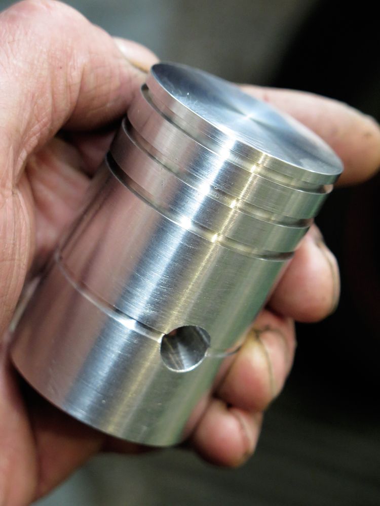

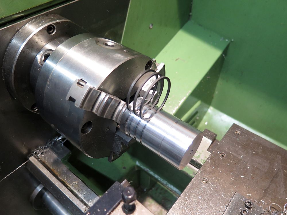

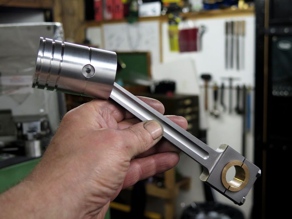

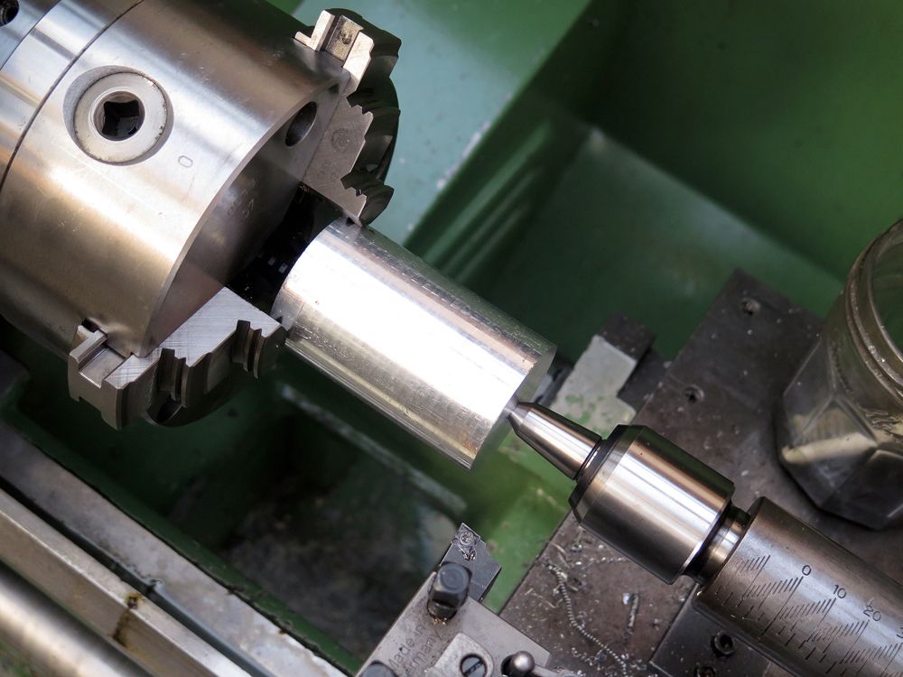

                Piston.
                The supplied aluminium was just long enough and was faced both ends.
                This was then turned to diameter and grooves cut into it to accept the piston rings and a shallow groove to help small amounts of residual oil into the gudgeon pin. (think the Americans call this a wrist pin)
                Taper into the piston skirt.

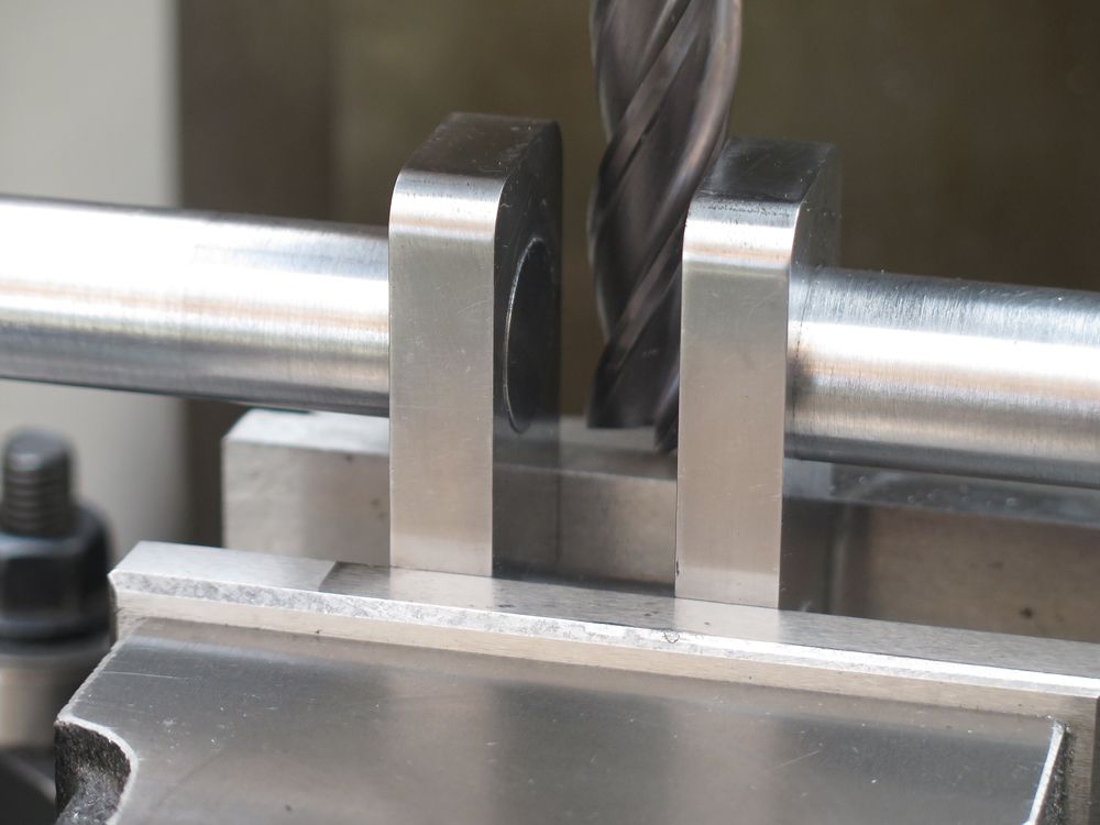

                Then over to the mill to recess a pocket to take the little end of the conrod.
                Then the chucking area was removed in the lathe and to the correct piston length.
                Now I have this.
                Still need to put some oil holes through to the bearings and make some caps from PB or brass to cover the gudgeon pin ends so that it will not damage the cylinder bore.
                Nick

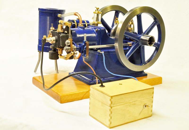

                                  Seeing as you insist, this is Peugeot Indigo blue:
                                  Cheers,
                                  Rod

                                    Rod, That is lovely.
                                    TBH I was aware of the images of your Wyvern and I confess that it was they that made me consider blue. yes
                                    I know that Grey and Green are also 'scale colours'. But the Engineers Emporium Economy / Hercules is not a scale model really. It's more of a representation of a multitude of hit and miss engines that were once manufactured. – If it was a scale model then I would without question go with an authentic colour.
                                    Cheers,, Nick

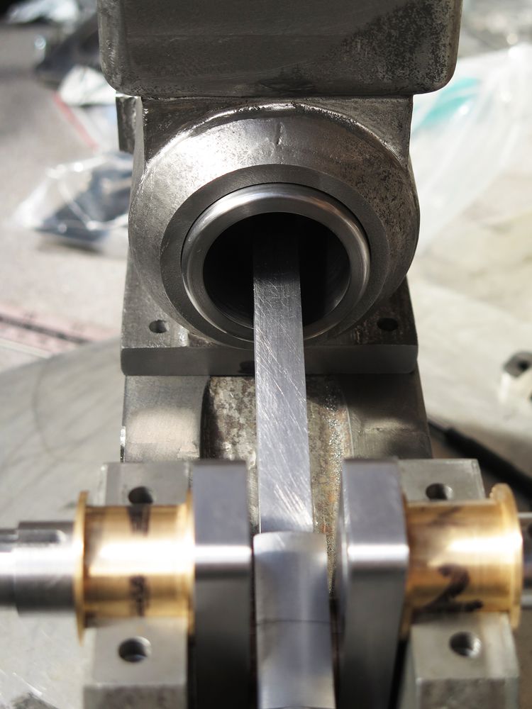

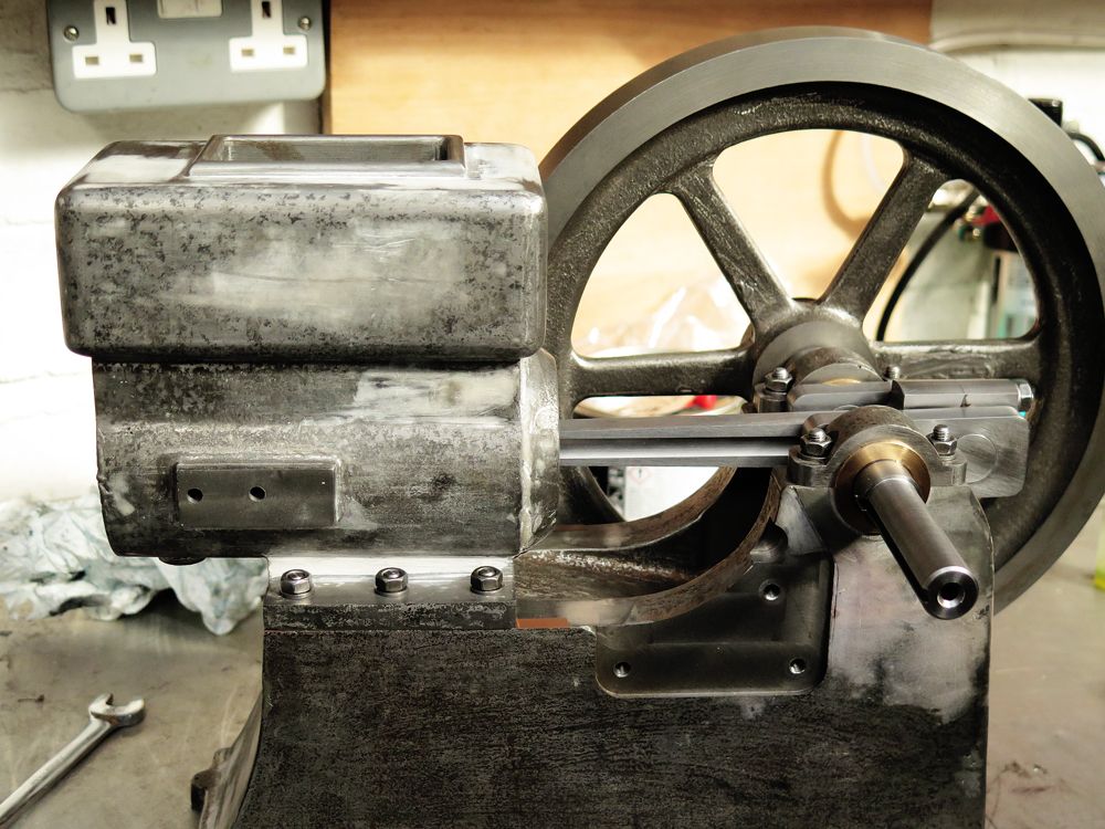

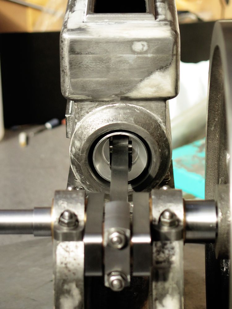

                                      Checked the alignment of the bore to crankshaft before I go much deeper. This is one of the few critical things on such an 'agricultural' engine as this. But quite a few factors effect it's alignment.
                                      It was thankfully in the 'adjustment zone' wink of the fixing holes.
                                      There are no piston rings fitted as I wanted to be able to feel for any binding spots in the stroke.
                                      Quick video. – The slight knocking is that the flywheel has not got a properly sized key in it as yet. ……… Honest.! cheeky
                                      Nick

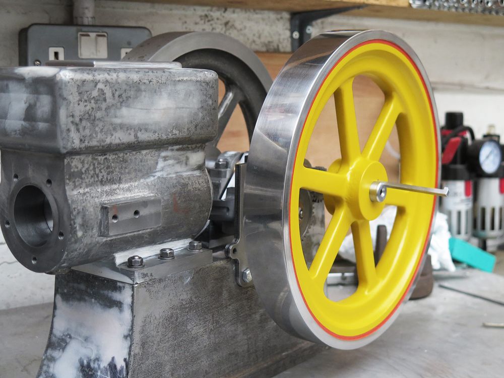

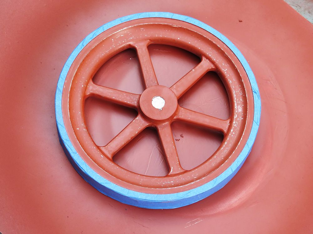

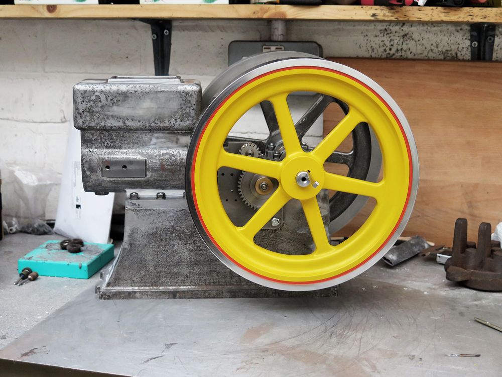

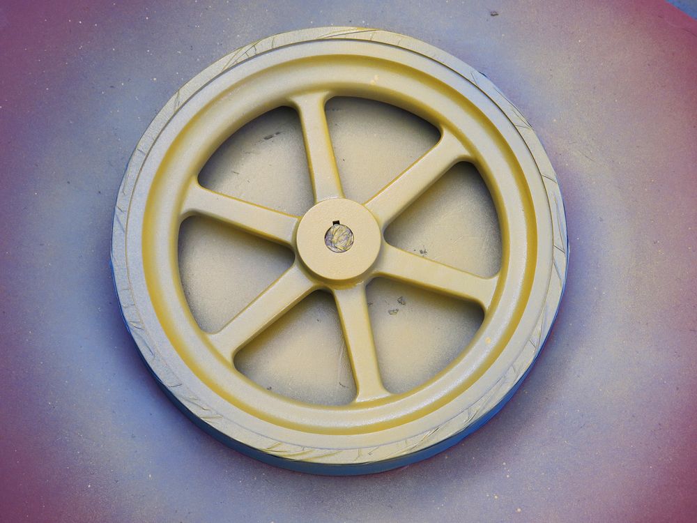

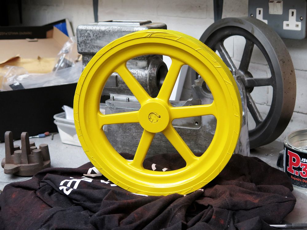

                                              OK I know I am miles ahead of myself her but I just wanted to get an idea of how it would look in yellow.
                                              Prepped it in red oxide (because I have lots of it) rubbing it down between coats. After quite I few I got to this :-
                                              Then 2 coats of grey primer as its better for yellow and a light dusting of the yellow.
                                              It took 6 light coats of yellow to get to this as the yellow seems a very 'thin' colour for coverage.
                                              Then a bit if striping in red.
                                              I now have an idea of how it would look in that colour.!
                                              I shall behave myself now and get back to making the parts and not painting them. laugh
                                              Nick
                                              #292182
                                                After yesterday's excitement …
                                                Dare one say that it's looking Bloody Good ?
                                                #292183
                                                MalcB
                                                  @malcb52554
                                                  Thats looking really good Nick.
                                                  How did you actually red stripe the inner rim?
                                                  #292187
                                                  Roderick Jenkins
                                                    @roderickjenkins93242
                                                    yes
                                                    Definite thumbs up for the yellow smiley
                                                    Rod
                                                    #292197
                                                    Nick_G
                                                      @nick_g

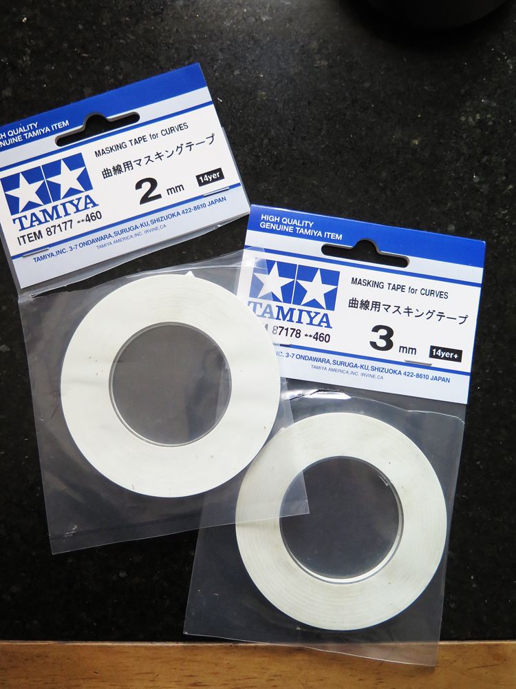

                                                      Posted by MalcB on 05/04/2017 14:42:20:
                                                      I have a super steady hand with a brush. laughdevilwink

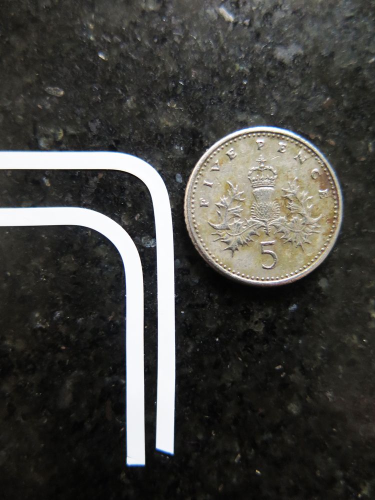

                                                      But when I am telling the truth I used this. :-
                                                      Good product it seems and is 'low tack' so it will not pull off any existing paintwork yet gives a nice seal so there is no bleed underneath at the edges.
                                                      What I did was run around the rim with one layer of the 3mm to use as a former. Then another inside that. I then stripped the first one out leaving the area to be painted with a brush and Humbrol enamel.
                                                      Just done a test with it.
                                                      They make it in several widths and I could have probably got a tighter curve had I not ATM got a gammy thumb.
                                                      Nick
