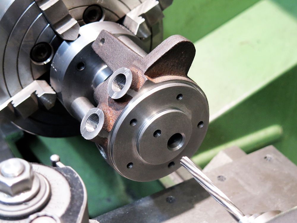

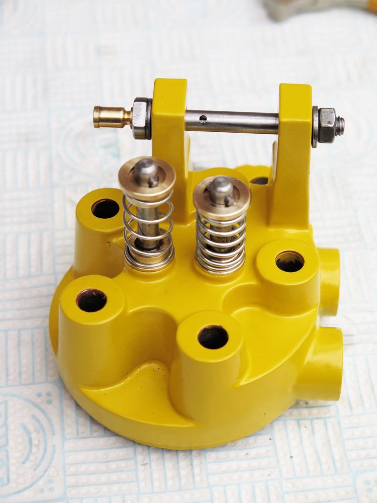

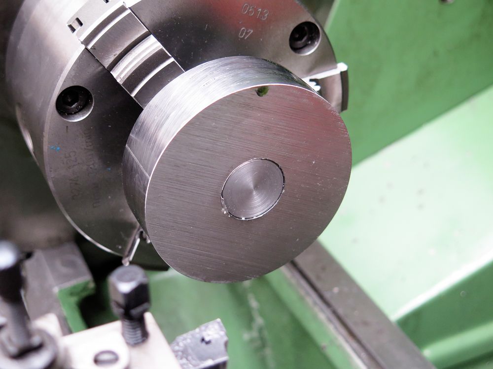

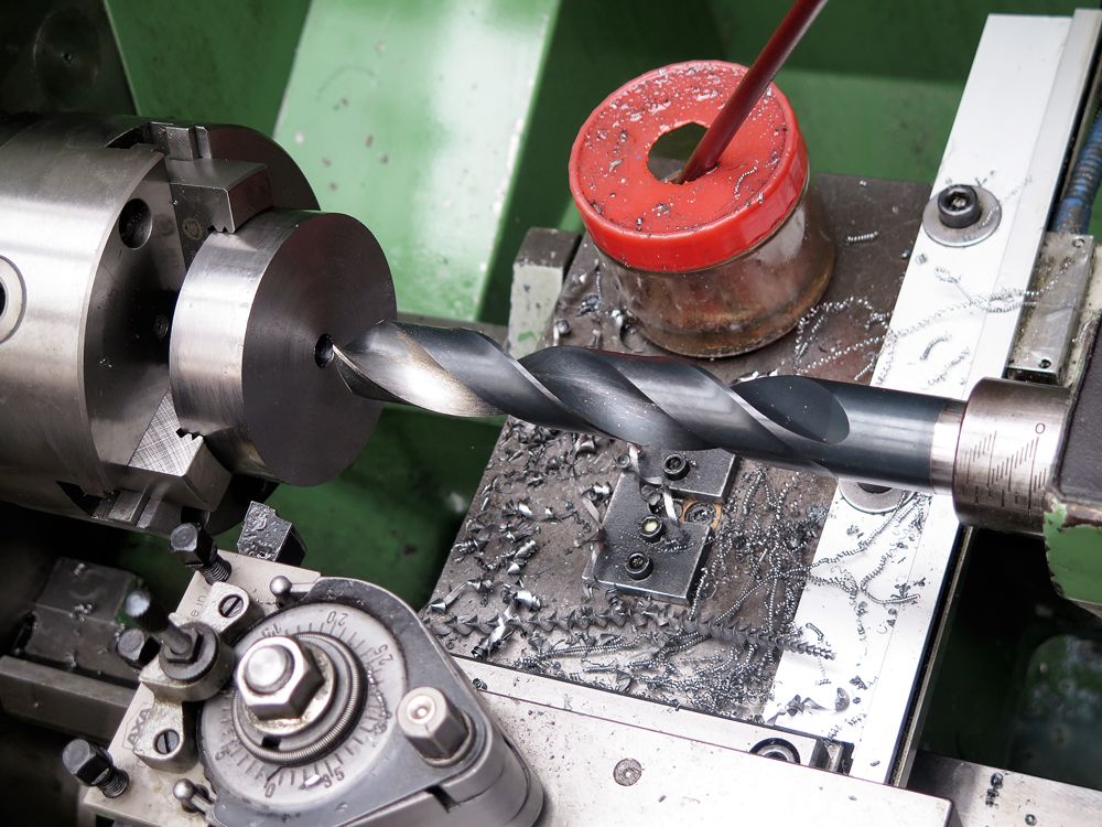

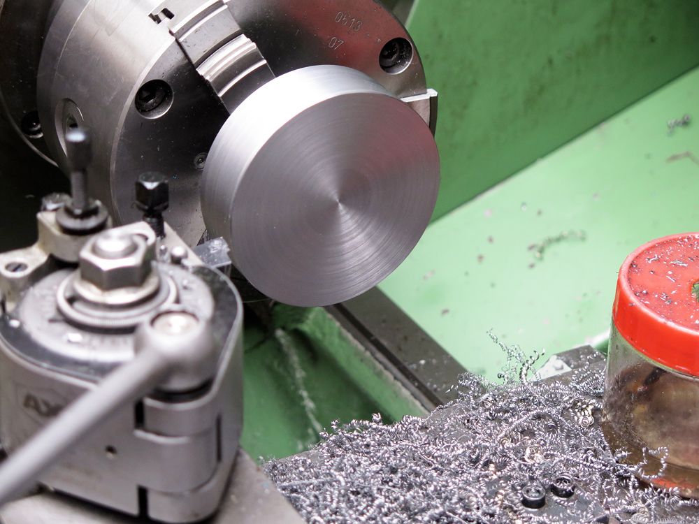

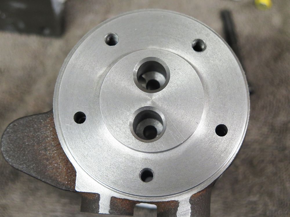

      For work on the cylinder head I made a jig to the style suggested by Jason.
      Added some PCD holes to both the jig and the head casting.
      The valve holes were dialed in while the jig assembly was mounted in the four jaw chuck.
      TBH I forgot to photograph most of the stages of the head machining.
      I will leave the lathe topslide angle setting untouched until I have machined the valves. (also suggested by Jason) so that the angle of the valves and the seats match as closely as possible for final lapping.

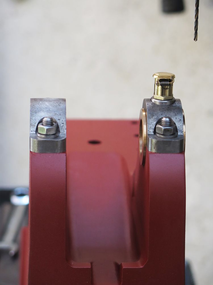

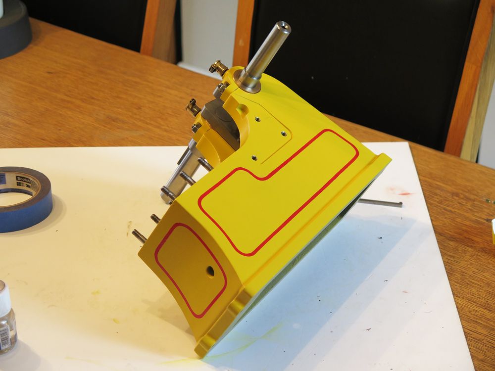

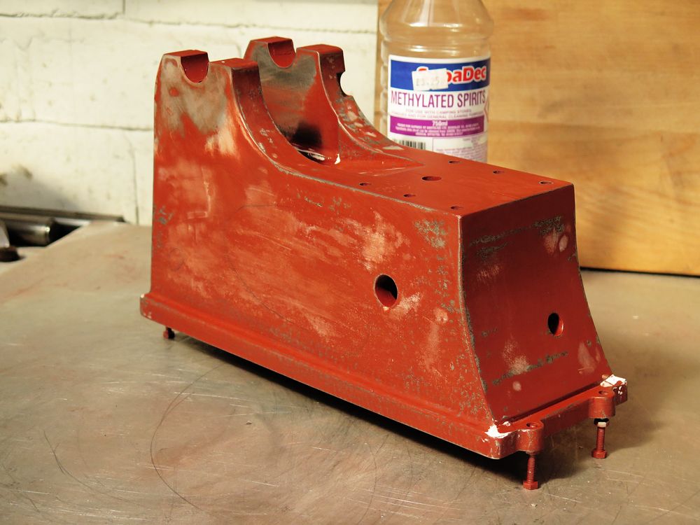

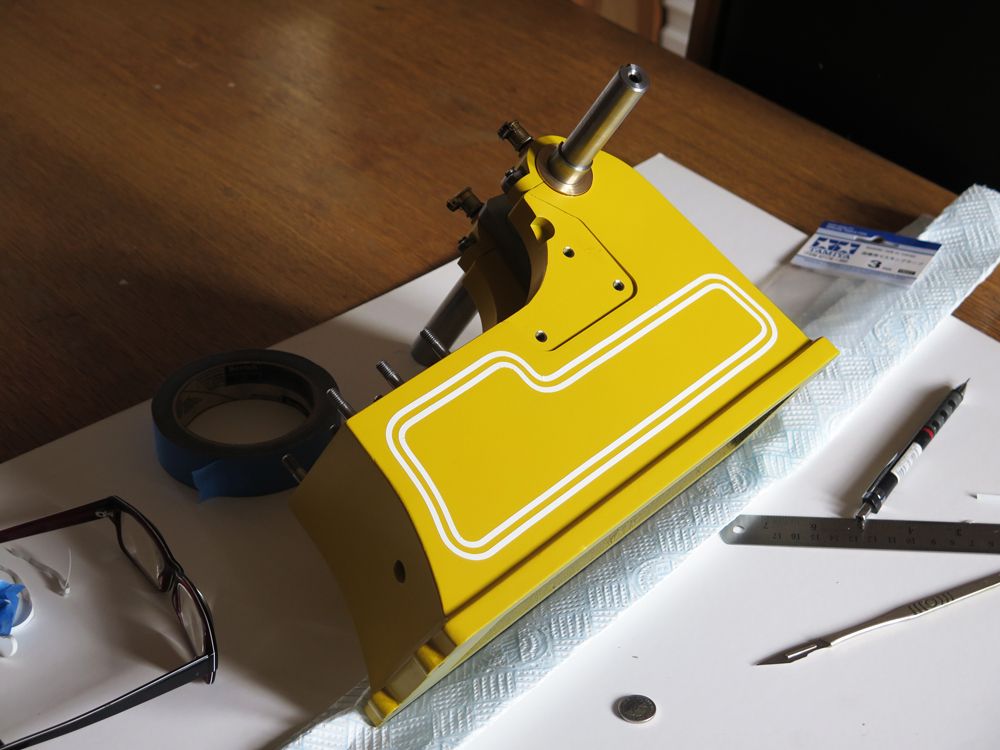

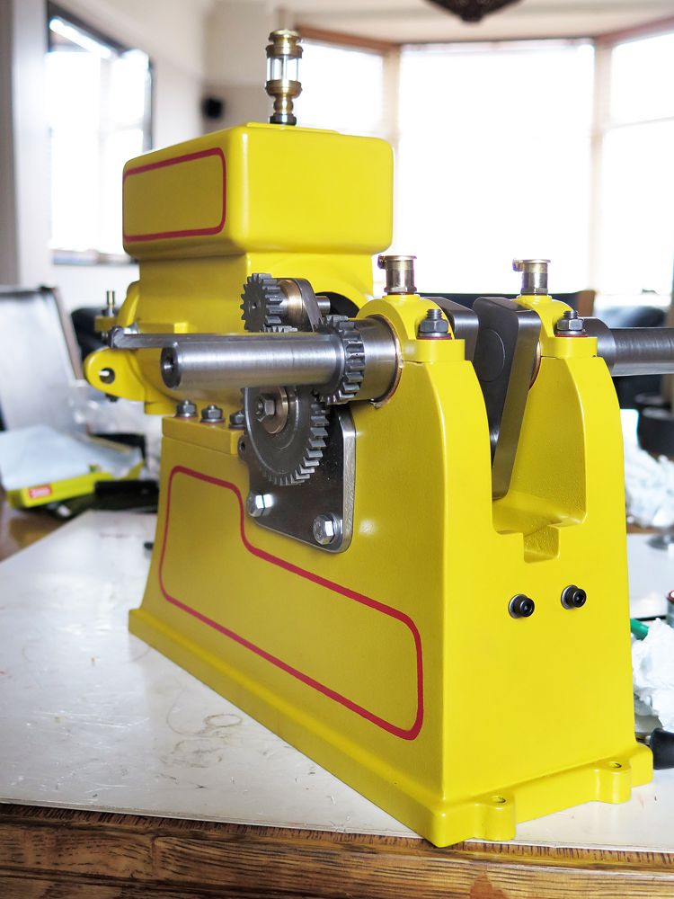

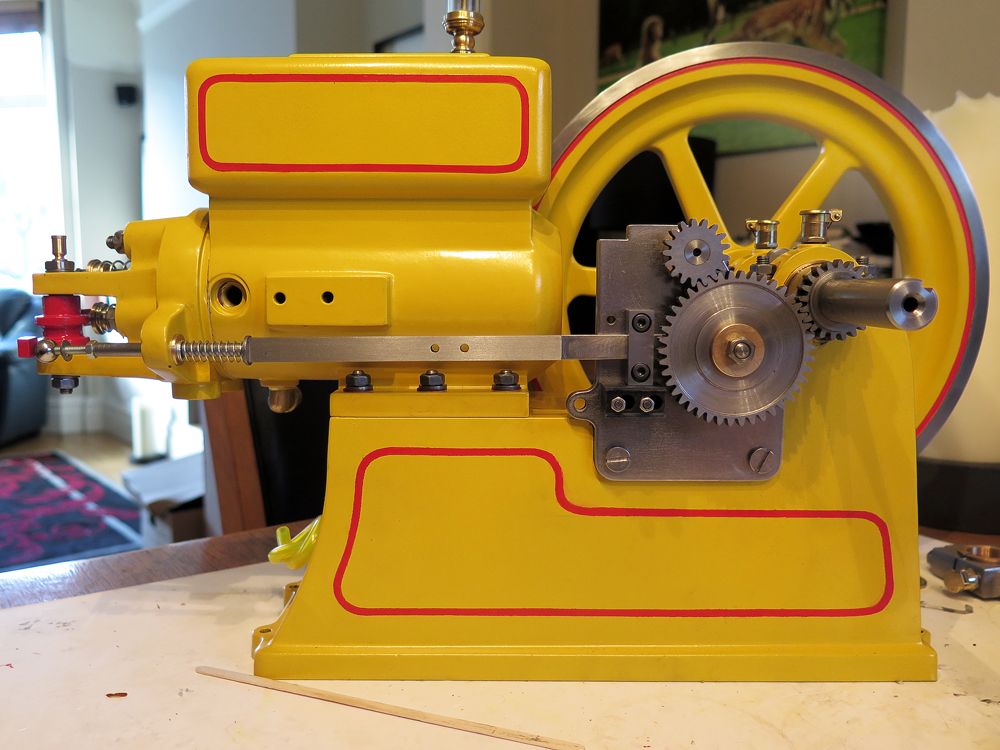

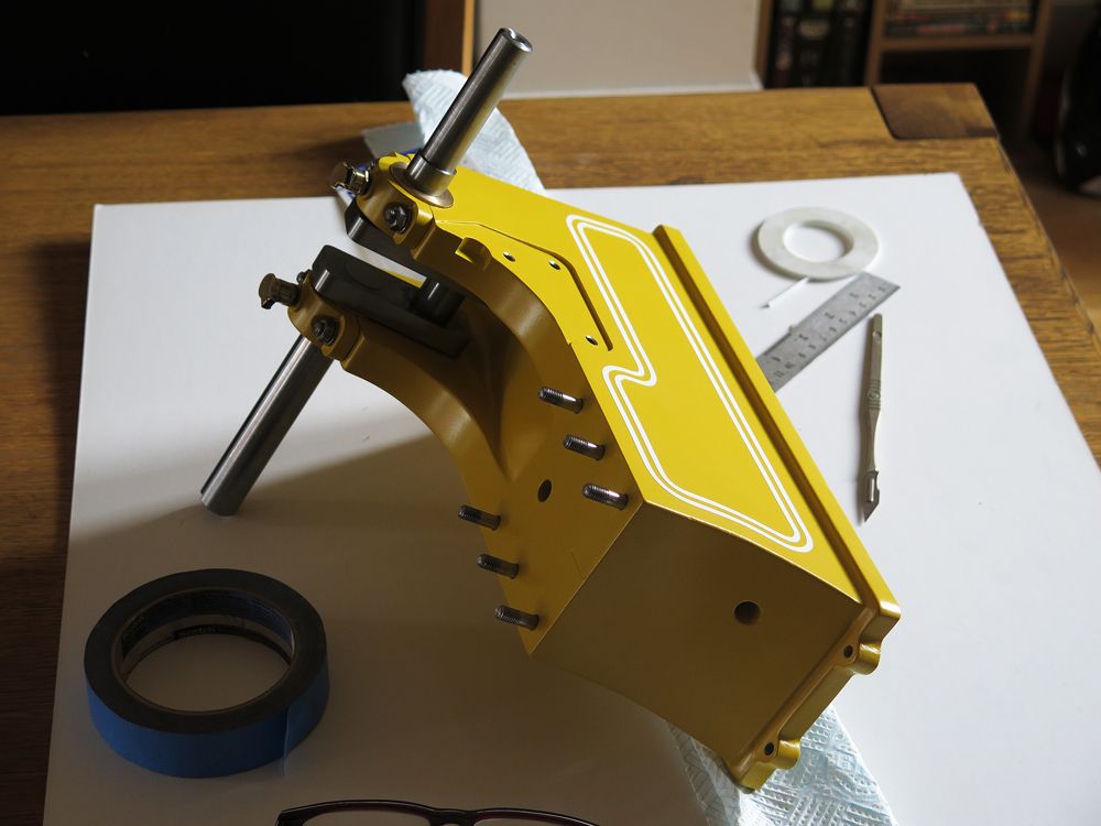

      Bit more painting in primer of paint and rub down several times.
      Added the oilers to the bearing caps.
      Then some coats of final colour.
      When dry I masked off with tape for the pin striping.

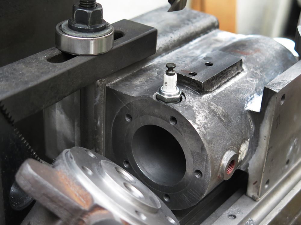

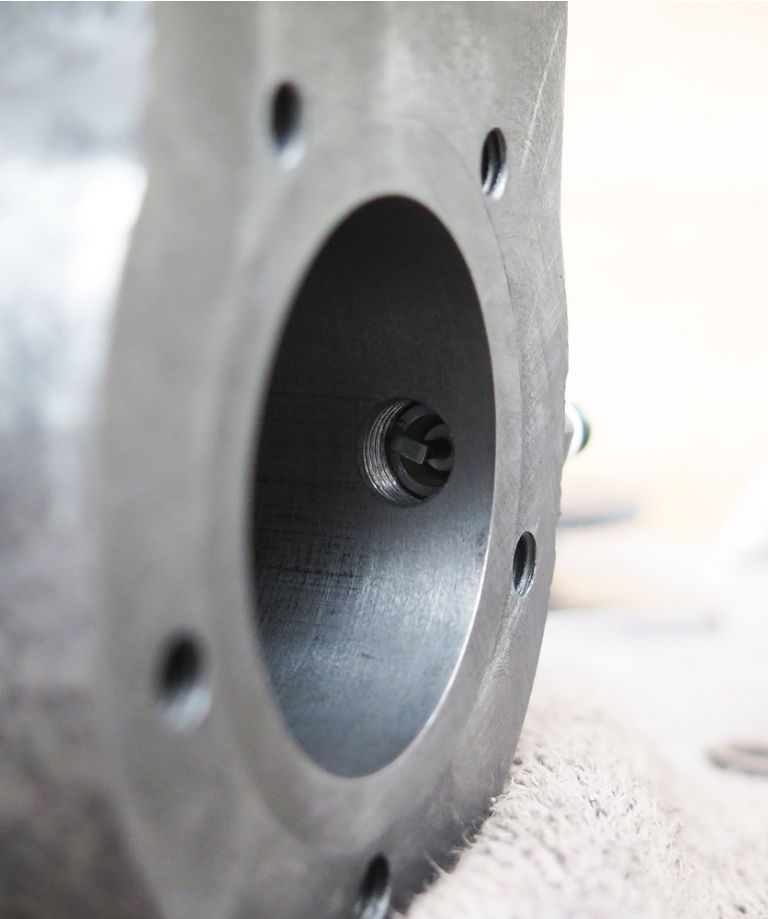

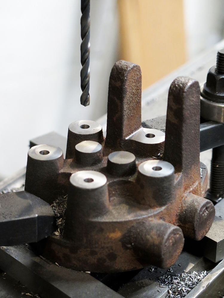

      Over to the cylinder / hopper to drill and tap the hole for the spark plug. – For some reason I found this step quite nerve wracking.??
      Then more priming, rubbing down and priming.
      Nick
      Edited By Nick_G on 14/04/2017 11:13:18

          Posted by Nick_G on 14/04/2017 11:11:20:
          Oh no I didn't!
          Though it won't do any harm, the main thing is to drill and ream the valve giude, open up the cavity behind the valve head and cut the valve seat all at one setting which gives the best chance of things being concentric.
          Just a note for next time, I prefer to put the inlet and outlet passages in after tdoing the above that way the drill is always cutting into solid metal so less risk of it wandering as it hits the cross hole.
          Now hurry up and get those red pinstripes done so we can see how blingy it lookssmile d
          #293350
          Nick_G
            @nick_g
            Posted by JasonB on 14/04/2017 13:28:09:
            I am ahead of you. wink
            Nick

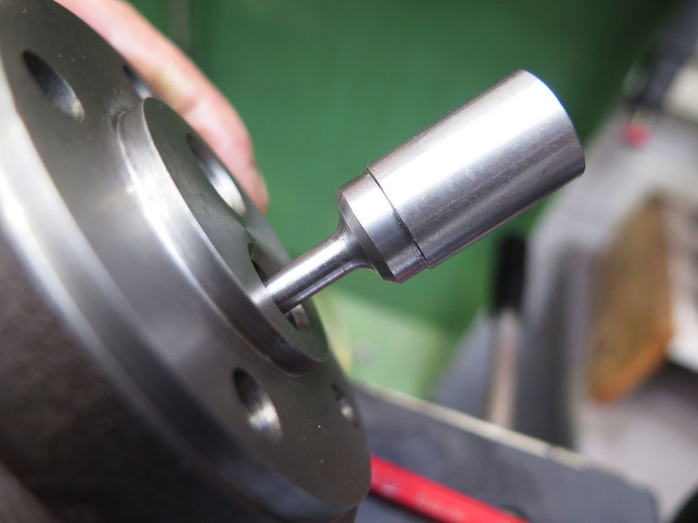

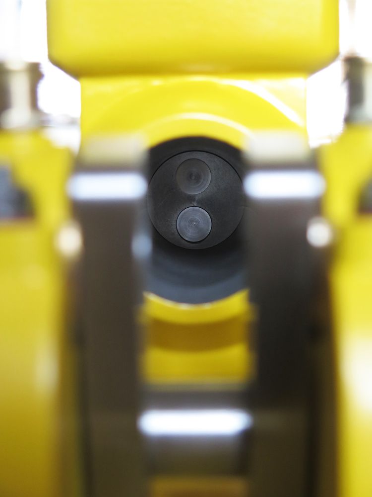

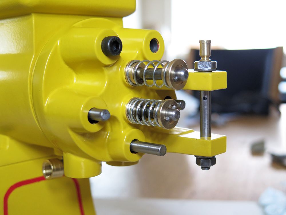

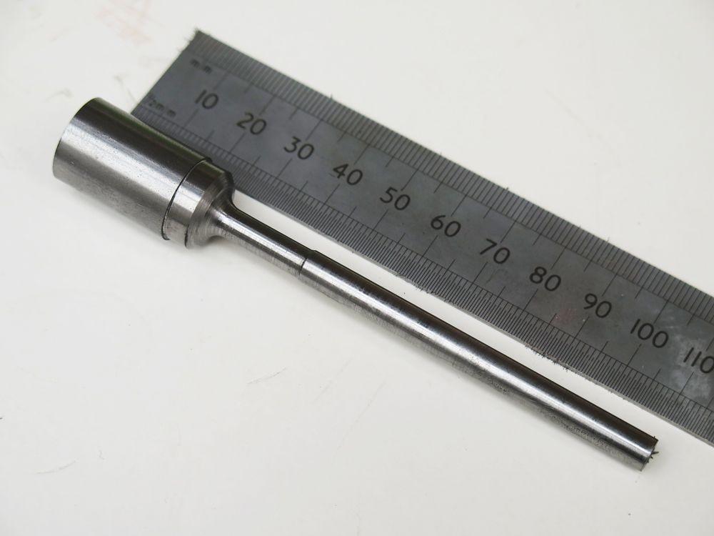

              Valves.
              Asked a mate of mine to drop off a bit of 16mm stainless steel. He came with about a meter of what is known as 431S29 stainless and exchanged it for a brew and some biscuits.
              I know nothing about this material other than it was really nice to machine and that he told me it's one of the magnetic stainless steels.
              I remembered to leave a bit of a stub on this time to make the lapping process a bit simpler.
              The above is the inlet valve which is an atmospheric one. I have read that the supplied spring is a little strong for the job so have made the stem little longer so I can place the retainer higher so that there is not as much pressure on the inlet spring. If it proves to be not strong enough I can put the retainer further down the stem with ease and not have to make a whole new valve from scratch. ………… Or get a weaker spring.! wink
              Nick
              Edit :- Just found a data sheet for it if anyone is interested. http://www.atlassteels.com.au/documents/Atlas431.pdf

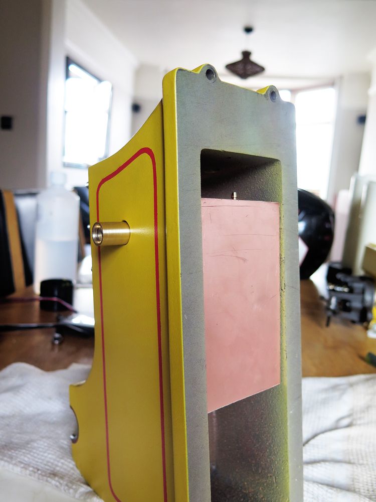

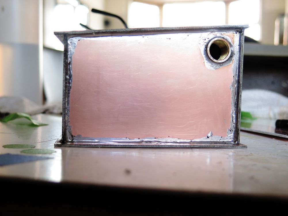

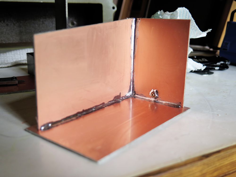

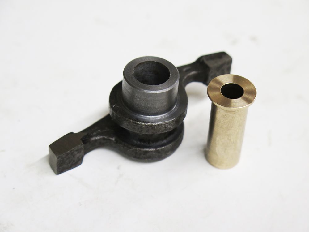

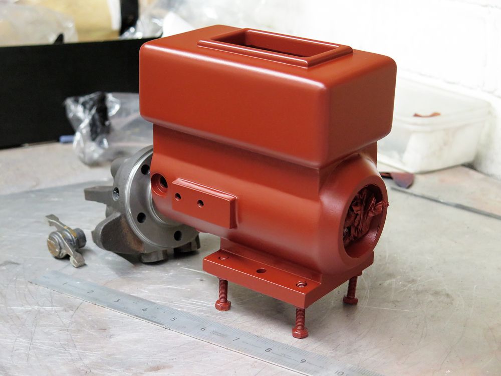

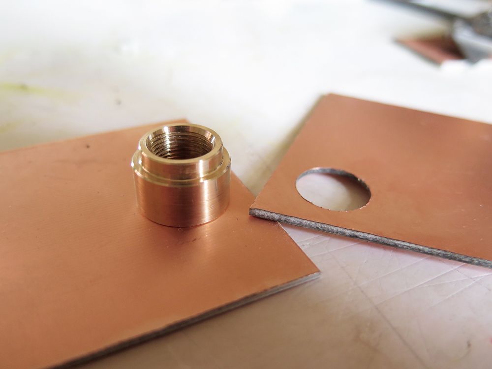

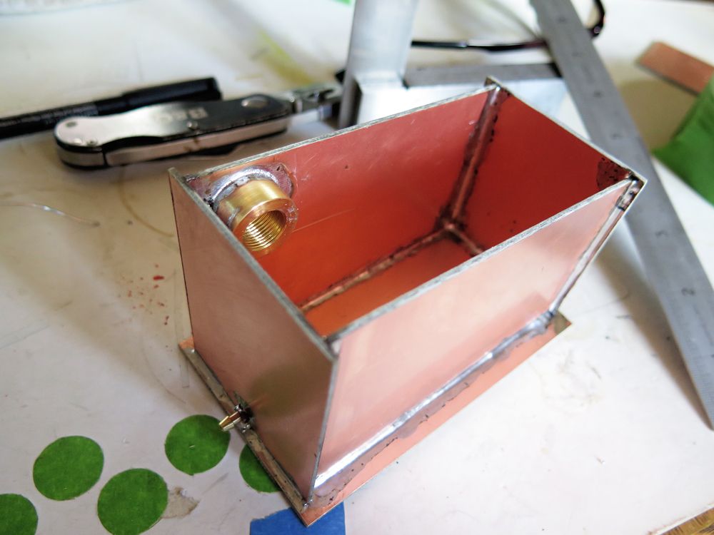

                Started to tidy the exhaust rocker valve and made a bush for it out of PB.

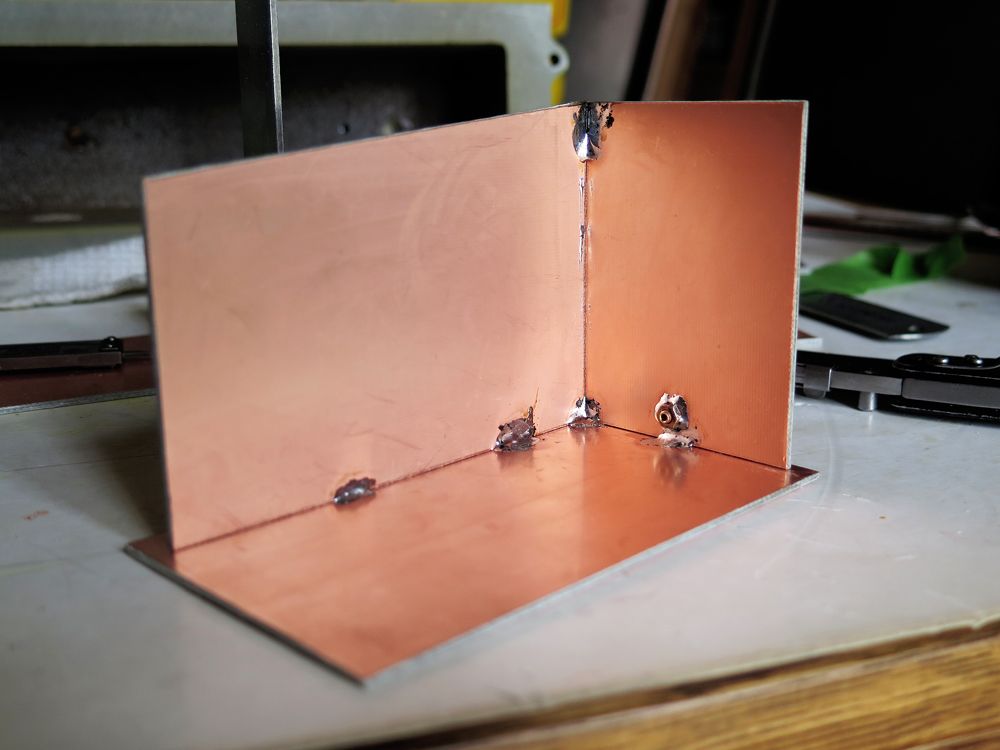

                With me starting to put the basic engine together as I have painted quite a few of the main castings I am aware of the increase in weight. As this is the all cast iron version and not the aluminium one the weight is considerable for a model (about 90 – 100 lbs assembled) Not wishing to tip all that upside down and ruin the paint I decided it best to make and install the fuel tank as this is located on the inside of the base casting.
                I made this out of double sided copper clad fiberglass board that is normally intended to making into printed circuit boards. – I got this idea from my ham radio construction days when such boxes were often made to go inside equipment and provide an RF shield.
                I used a 150w soldering iron that had more than enough whack in it to run the joints. The photos should be self explanitory how I did it.
                Tacked the boards.
                Ran the solder joints.
                Filler flange.
                Getting there and running the joints on the other side.
                Finito'
                Fixing is via silicone.
                Nick

                    Truth is though I do not really have any painting skills.! It's the result of nothing more than 'rattle cans' and masking tape for the pin stripes. Get close and it is a bit 'orange peely' on the finish. I probably would have got a better finish if I had got the air brush out.
                    I did however spend considerable time in the prep stages, but that is no secret be one painting a house, a car or a model etc.
                    I know nothing I ever make will ever win any competitions but I have in my limited time in the ME world seen lots of beautifully crafted and engineered items that have the visual edge taken off them by a whack it on paint job.
                    As I said it's all in the prep. – A Dremel, JB weld, Milliput, car body filler, primer and wet & dry are my new best friends. wink

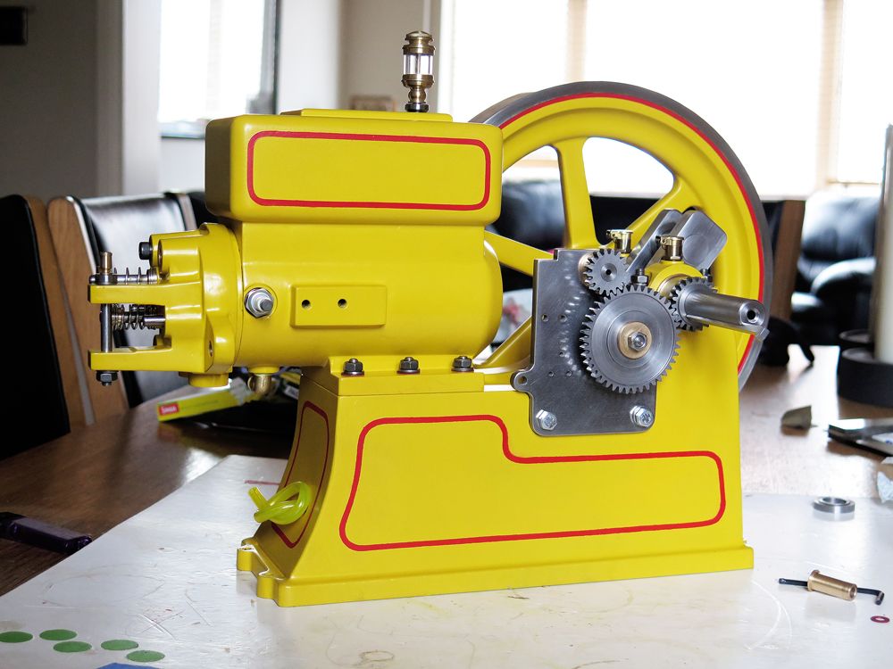

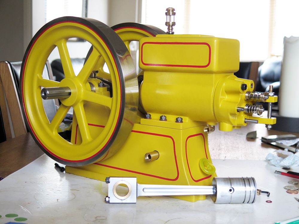

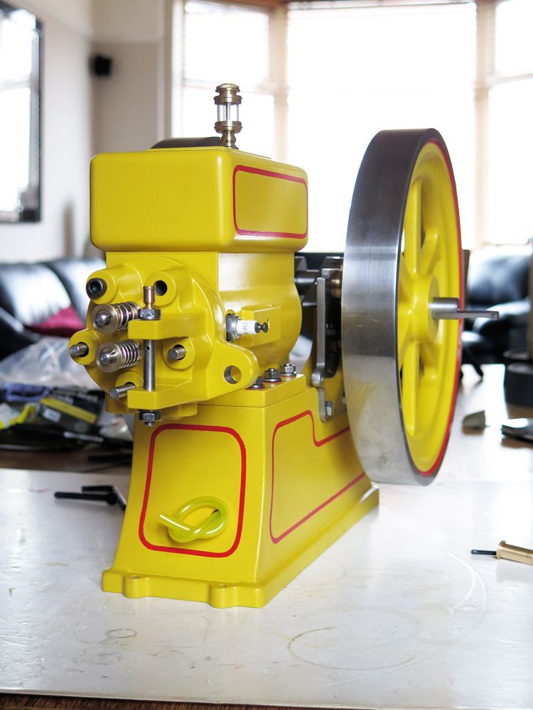

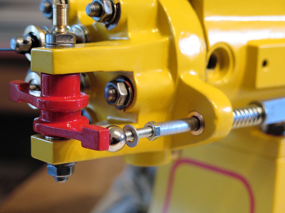

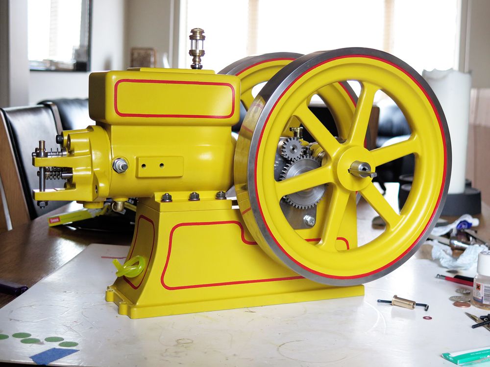

                        Some self explanatory progress photos.
                        Have a good weekend folks.
                        Nick

                          With a fear of sounding repetitive, it looks amazing! You can certainly be proud of this, no need to be so humble.
                          #295542
                            I'm sure that would be in with a good chance of an award finished to that standard!

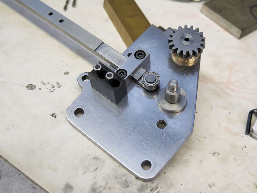

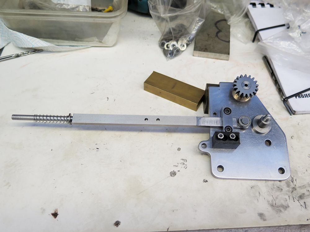

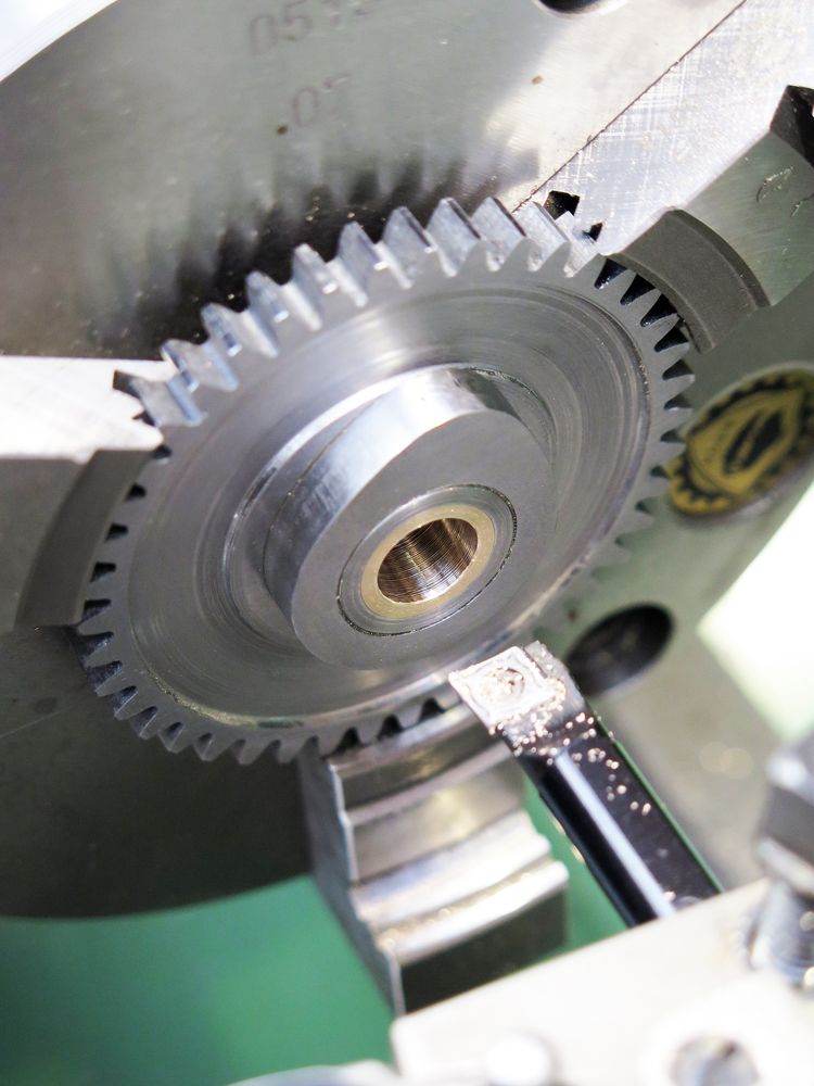

                              Did some work on the timing plate and made the push rod and contact block etc. Still need to remove tool marks and the end of the push rod where it meets the rocker is not final.
                              And a little video overview.
                              Nick
