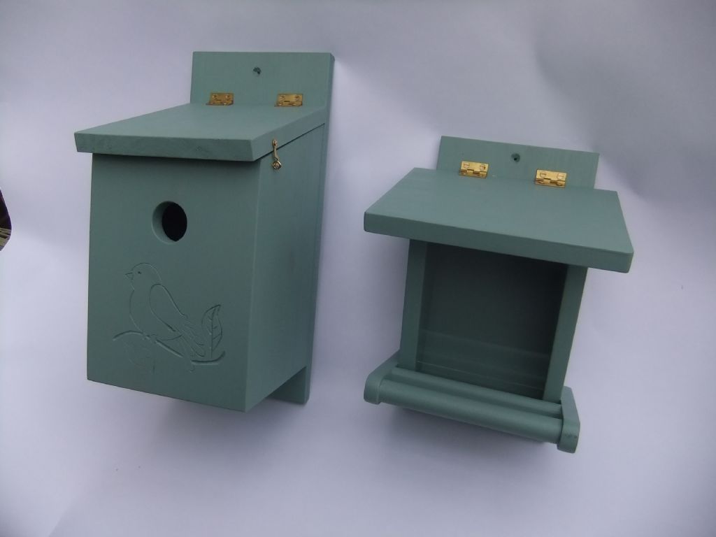

                            I have made bird nesting boxes but have only ever used untreated pine then sealed the outside only with a stain/preservative finish, I did however paint the hole which I should not have done. This one and the feeder have lasted from when I made them in 2014 until last year not sure if they are still going as my Mum passed last year and not sure what happen to them after that2014-11-11 001 006.jpg

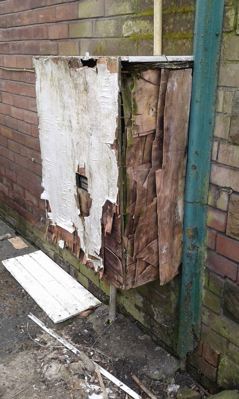

                                              I'm pretty sure this Meter Box was not constructed from Marine Ply
