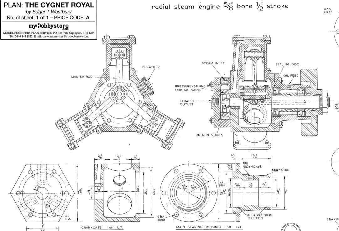

          It will not run on air.  I am a little confused as to the sequence of the conrods.  I have the Model Engineer issues from Oct 2002 to Dec 2002 which appear to show the rear conrod going to the cylinder on the lower right as you view from the flywheel end, the master rod to the top, and the front to the lower left cylinder.  I also have the Motor Boys plans which appear to show the reverse of this.  To my mind, one of these will be incorrect in relation to the orbital valve and air/or steam will not be admitted correctly.  Can anyone who has built this model tell me which it should be, before I dismantle for the nth time.

          #780146
            The Drawing that I seems to show both.
            The end view which is from the flywheel end shows the lower right at the front but the section shows the rear going to the lower right.
            Short of drawing it all out in cad I think all you can do is take of the rear cover and watch the movement of the valve to see which cylinder has it’s inlet uncovered at or just after TDC and which has it’s exhabust opened at BDC.
            Also watch the drawing projection on th ereturn crank to make sure the eccentric pin is correctly positione drelative to the crank pin.
            cygnet

              Have taken it apart again to check the valve position and the rods.  The only way I can see it running is if:
              a) it runs counterclockwise and
              b) the right hand cylinder (viewed from flywheel end) uses the front con rod and the left hand cylinder uses the rear conrod.

                If there is any consistency to the drawing above, the section top left is looking from the flywheel end (not the modern way, ie since 1970s in my experience). I can’t see why swapping the conrod round affects the sequence of the pistons. Can you elucidate?

                  If you swap the conrods doesn’t it upset the sequential phasing of events? i.e. as illustrated, one of the lower pistons is already over BDC whilst the other hasn’t yet reached it?
                  #780256
                    Conrod position front or back should not affect the timing. As I said the return crank and the position of its pin is what times the valve disc. Just like setting a slide valve engines eccentric to lead the crank, 100deg in this case
