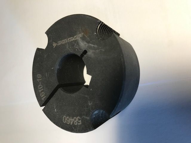

      I am looking to fix a home machined pulley to a motor shaft using a Dunlop taper bush.
      It is possible to purchase a bolt-on hub (female) to afix to the pulley which will mate with the bush (male) perfectly.
      However, the dimensions of the hub are too large for my pulley – I think they are meant to be used on a fan etc.
      Does anyone have experience of this machining task? I am happy with measuring and reproducing the exact taper but the location of the half-holes seems more problematical.

            Fenner produce adaptors beyond the bolt on style for Taper Lock Bushes, their 'hub adaptors' may be worth a look.

                They also are known as taper lock hub bushes. Google for suppliers and the many various sizes available, they are not expensive..
                A point to be aware of is that the two holes that accept the clamping grub screws are NOT across a diameter, they are displaced at 5 degrees below centre on either side to enhance the collapsing action of the bore onto the motor shaft. The hub cone angle is 8 degrees

                  That is yet another type.  The 'hub adaptor' is a split bushing (with or without a keyway) and sits in a cylindrical hole.

                      I do have a drawing showing all dimensions somewhere. Remember there are two holes to hold the taper lock in and the threaded to act as an extractor. Will dig out drawings and get back unless someone beats me to it.

                          http://www.dunlopbtl.com/downloads/Dunlop%20BTL%20-%20Taper%20Bushes.pdf

                                Found my dimension sheet for bores to accept taper lock bushes, rather than post found the same on the above link.
