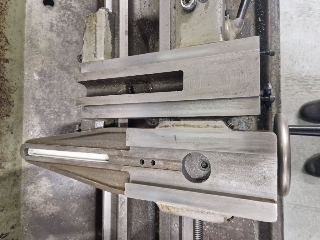

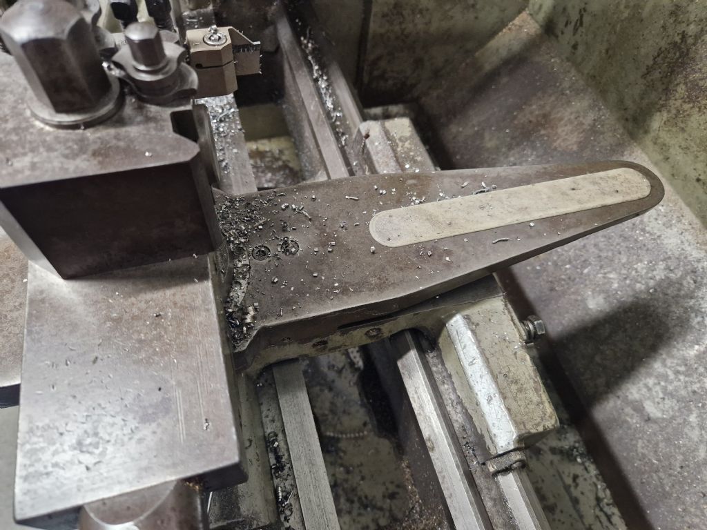

                  I have looked at fitting it inside the cross-slide, I can't see where I would fit it, there is the slot for the taper turning attachment & holes where the cross-slide feed bolts to, see the pictures, without the attachment fitted. Sorry for the mess, I was mid production of a batch of nuts.20230722_140004.jpg
                  The underside looks like this, taken later, when I had finished the nuts.
                  More details of it are to be found at lathes.co.uk.
                  The Machine DRO attachment for the normal cross-slide extends the cross-slide out the back, you then machine a slot in the main casting & extension for the magnetic tape, this would interfere with the taper turning attachment.
                  Mounting the scale on the side would probably mean 1" of lost travel towards the tail-stock, I already find I am often against this as I try to keep the tailstock in as far as possible so it has the support of the body.
                  It may be that what I am trying to do is not practical.

                      Is there any possibility of fitting a "bare" magnetic strip system to the taper turning attachment?
                      I'd envisage a steel or alloy plate fixed to the top of the attachment overhanging one side yet narrow enough so as not to interfere with the nut or bolt that holds the attachment slider when in use. The magnetic strip being fitted under the plate so as to be adequately protected with the reader mounted facing upwards on suitable bracket overhung from the saddle. I'd imagine 3 mm or 1/8" would be thick enough for the plate. Probably need to make your own compact reader case tho'.
                      If such a system could be finagled in you'd probably have to accept that setting the taper attachment would become rather more fiddly.
