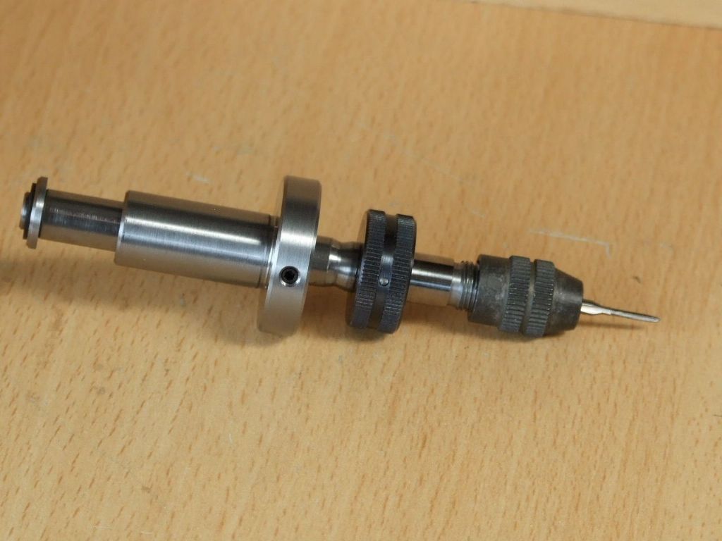

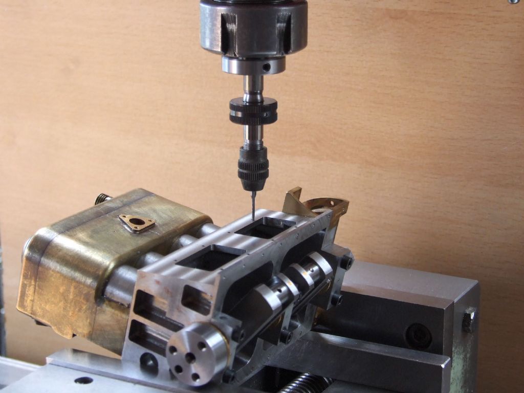

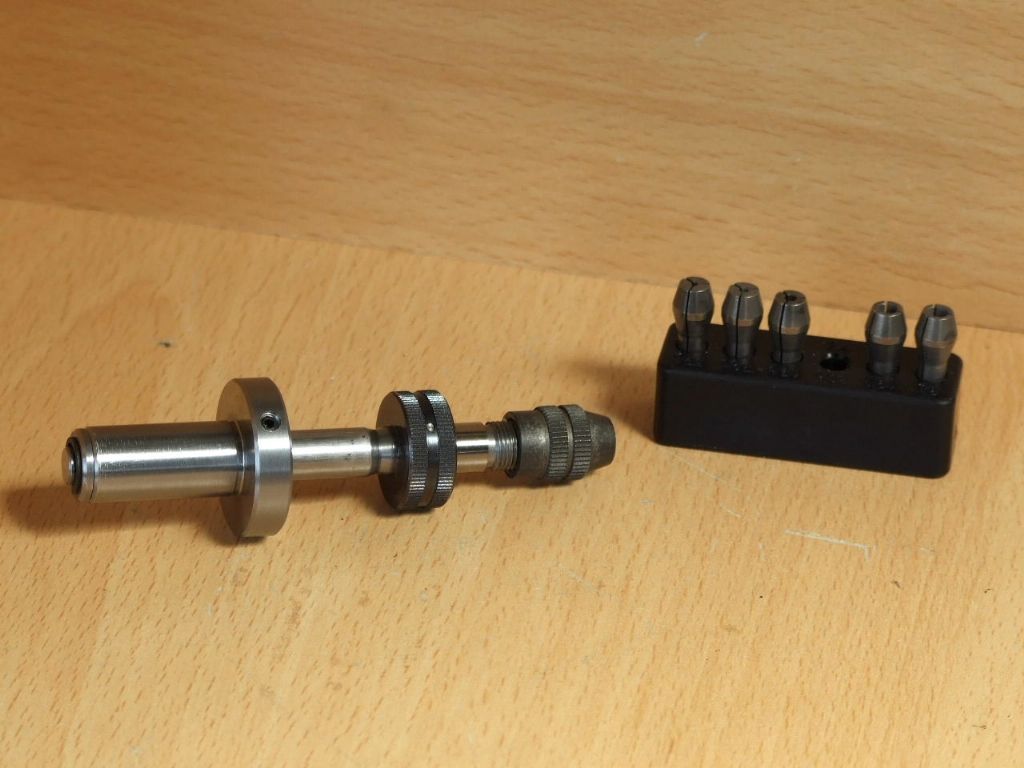

                                      Graham Meek
                                        @grahammeek88282
                                        After breaking several 10 BA taps I decided I needed something to guide the taps, or face bankruptcy.
                                        The design here has the advantage that the collet can be set to allow the tap to spin if the tap meets an obstacle while the driven part, the larger knurled ring carries on rotating. The slider part of the design has a spring loaded clutch which stops the tap dropping when traversing from hole to hole.
                                        The design in full was described in HSM a short while ago.
                                        fig 3 the attachment with 12 ba tap, note the small pin to locate the knurled ring.jpg
                                        fig 4 proxxon small tap attachment, tapping 12ba threads in the fiat 702 tractor engine.jpg
                                        Regards
                                        Gray,
