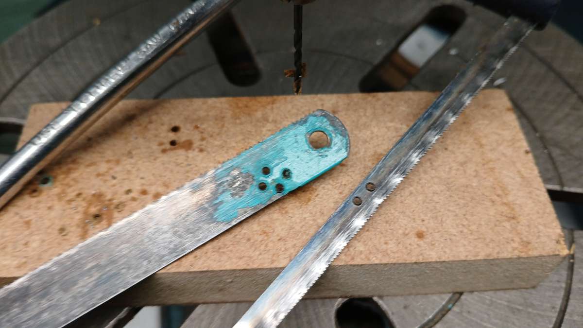

                  Way too much overthinking going on here as usual. There is a big clue in the question “high carbon steel with induction hardened teeth”
                  I would not use anything special to drill a bit of gauge plate or silver steel so why anything fancy or even spark eroders for this bit of carbon steel.
                  Get out the armchairs and give it a go.
                  Bog standard HSS 1/16″ drill that is past it’s best and in the rough work rack and a bit blunt, equally rough Naerok drill press, a bit of Sulphur containing CT90, no punch mark to start it and no skidding about. What could be easier. Hardest thing was holding the springy blade down, holding the camera and pulling the quill down with just two hands. Not even a bit of smoke to make it look like it was hard to drill

                    #800444
                      I did use one on the quill, other held phone and blade.
                      Oh and if anyone was wondering the same HSS drill also goes through Eclipse hacksaw blades.

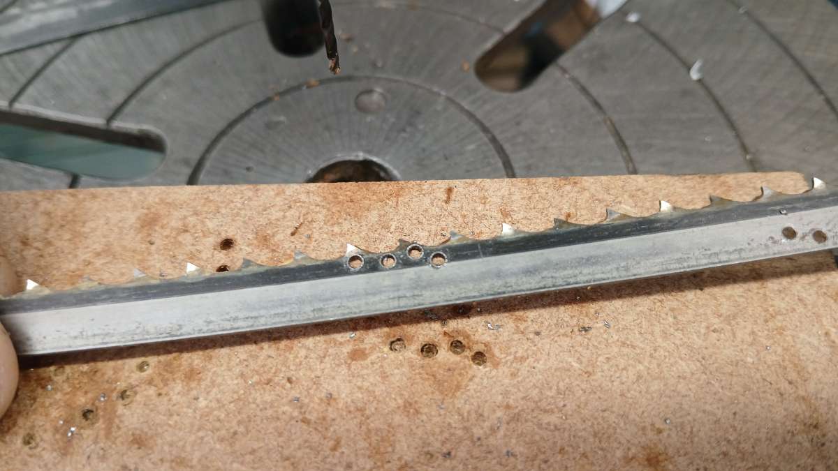

                              It was nearest to the drill press and also illustrates that nothing special was needed. If i’d have picked up a good one then it would have been coated and split point but the example was just plain black steam tempered and normal point.
                              The first hole drilled on the video which is second from the right was quite close to the heat zone so I’d just try a normal drill unless you have a suitable cobalt one to hand rather than buy something that may not be needed.
                              #800545
                                Seems OK near the edge too, that’s an Axcaliber blade of some sort.

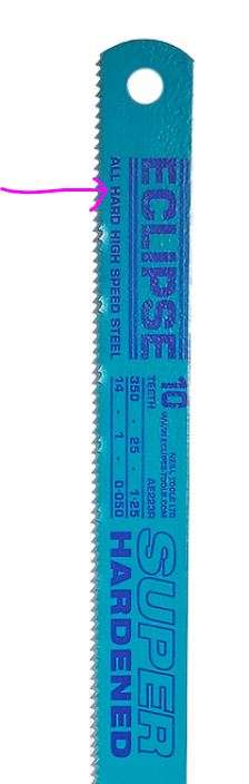

                                    I tried to drill an Eclipse power hacksaw blade a while ago and a HSS bit hardly touched it. I sharpened a TCT masonry bit and that went through ok.
                                    Edit: Not ideal but I’ve also used TCT Glass drills for hard stuff before.
                                    #800567
                                      Quite possibly because their power hack saw blades tend to be HSS not carbon steel with hardened teeth that the OP wants to drill.

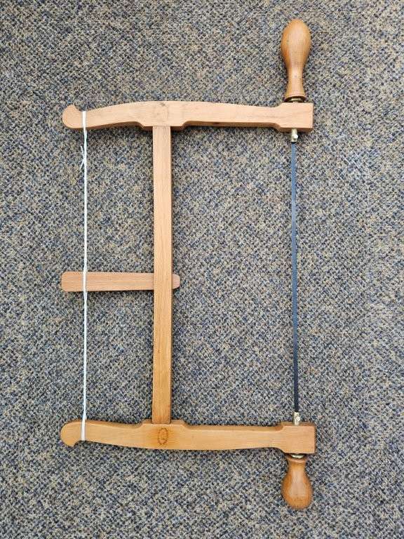

                                          Not sure what’s happened to “TuffSaws”, but e-mails to Ian John have now become undeliverable, and the phone goes to BT Call Minder.  However, I’ve now got some blades from elsewhere.
                                          Drilling with a 1/16″ HSS/Co drill worked perfectly.  Positioning the centre punch was the awkward bit as it kept skidding on the blade.
                                          The image below shows my Grandad’s restored Bow Saw with a new blade and retaining pins.
                                          As an aside, the stretcher is bowed by about 3mm, presumably from being compressed over the years.  I’ve tried to straighten it by supporting each end and sitting 6 engineering bricks on it for a couple of weeks, but to no avail.  Said stretcher has been finished with Danish Oil, so steaming isn’t going to work (unless I strip the finish).  Any suggestions how else I might straighten it?  The stretcher is Beech and about 25mm x 20mm.

                                            You should be able to bend it with dry heat but more like a hair dryer than a paint stripper. Try first what the top temperature the finish can stand – I suspect about 90C.
