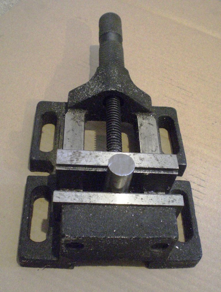

                              Hi Jon, that Harlingen one looks a little similar to a cheapish mill/drill vice that I've had for many years, although it needed a bit of work done to it, to minimise jaw lift. It has a 8mm wide vertical vee in the centre, and two 4mm ones either side of the fixed jaw, plus a 6mm horizontal one. It will hold up-to a 20mm piece of round bar vertically, securely enough for drilling in the middle vee, but not for any milling operations, the two smaller ones each side would probably only hold about 12mm, but I would put a piece of bar the same size in both the smaller vee's, if I needed to drill just one piece, as the moving jaw would tend to twist otherwise. The only thing they don't seem to say, is how big the vee's are on that Harlingen one.
                              I've only ever used this vice for very light milling, but very infrequently though, but it does do well for general drilling operations.
                              Regards Nick.

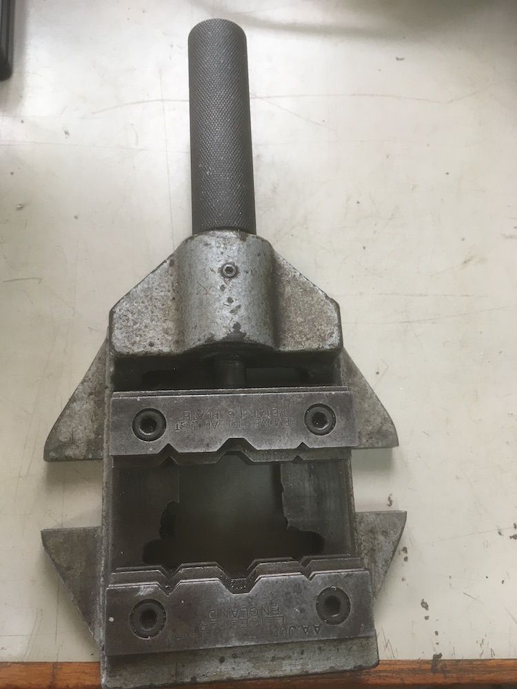

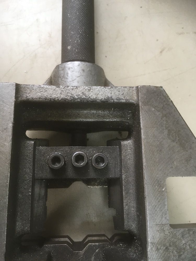

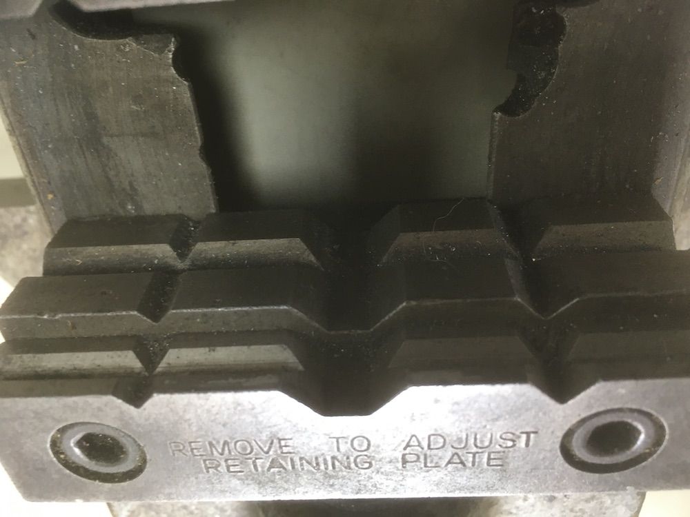

                              Clive Foster
                                @clivefoster55965
                                In my view the Nippy is the gold standard for small drill press vices made to hold adequately true stock and parts accurately. Not so good as a vice with more floaty jaws with mis-shaped things tho'.
                                Capacity is 3 1/2" width by 2" opening with an extra 1" of opening for things that can be held via a shallow surface by removing the top jaw plates. If they can still be bought new they will be too expensive but they do turn up second hand at not too silly prices.
                                Making auxiliary jaws with a suitable selection of similarity proportioned slots for your vice would solve the issues you have.
                                Pictures
                                Jaws close up
                                Underside.
                                3) nippy underside r.jpgNote the relatively substantial guide plate needed to improve jaw stability so it can cope with the side V slots. Jon probably did something similar to his vice to minimise lift and making it stable enough for very light milling. Something I'd not do on any drill press vice however well modified although the Nippy might well be up to work on the end of round stock held in the substantial centre V.
                                Hope this provides some inspiration.

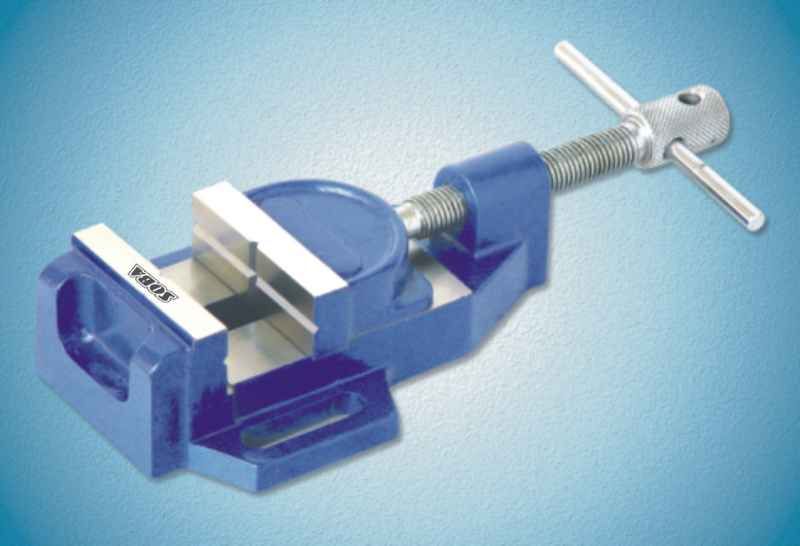

                                            Chronos have this vice with soba printed on it that looks like a record 414, it as soba on the vice but shobha in the description,**LINK**

                                              That Soba vice is a decent design but the jaws are essentially free floating in swivel. So it can only securely hold things that are pretty much centralised across the jaws. Put something on one side an it will tend to be pushed out unless you have a matching spacer the other side.
                                              It's arguable that vices of that layout have too much swivel capability on the moving jaw, something approaching 30° each way I think, so significantly tapered items can be held. But with only limited frictional grip so things can relatively easily be spat out. Aluminium or soft fibre jaw covers are desirable when holding something with significant taper. But it will hold such tapered things quite easily, unlike other styles. I've seen a blank end morse taper held in a vice of that style so a cross hole could be drilled. That would have been a major pain with other types of vice.
                                              As ever there are always compromises involved so its important to understand the strengths and weaknesses of what you have and work in an appropriate manner.
                                              Bottom line is that designs for securely aligned jaws are the province of milling vices which are much heavier, more expensive and need higher jaw forces to hold things. Despite all the extra cost they don't hold uneven or tapered companies as well as a relatively inexpensive drill press vice having some jaw float enabling it to self align on whats being held will.

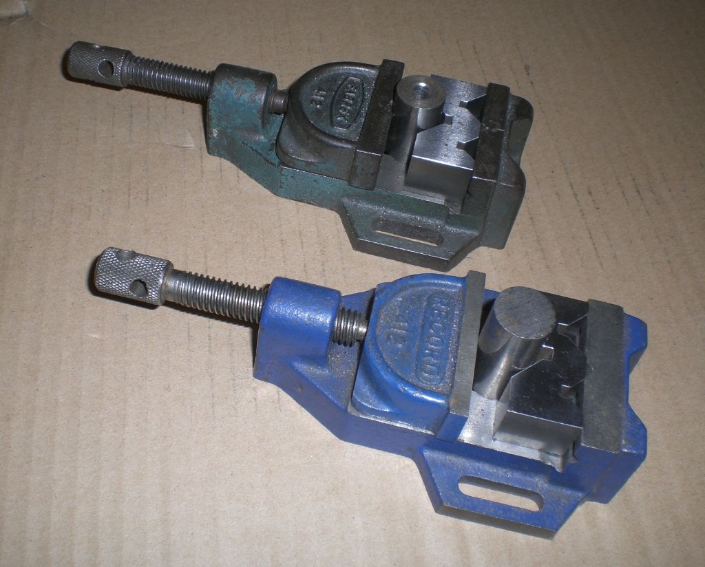

                                                  Hi Jon, don't get too concerned about the name on these things, the style of these vices hasn't been limited to Record. I have two No. 412 vices, one of which is a Record, which a previous owner had modified, the other one is a Fabrix one, of which there is an advert in Buck & Hickman's 1964 catalogue, but I don't know if it was made before, at the same time or after Record was selling their version.
                                                  A while after I made my last post, when out in my garage, I had the same idea about using a vee block in your vice as JasonB has suggested.
                                                  As you can see in the above photo, both the Fabrex and Record vices have used the same castings and are the same style as each other and the Soba one.
                                                  Regards Nick.
