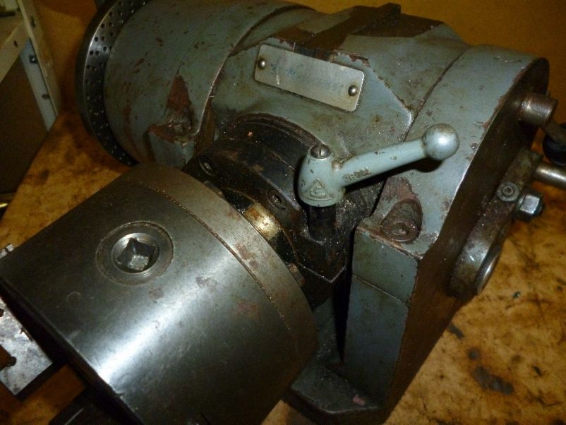

                                        Steve Garnett
                                          @stevegarnett62550
                                          Posted by Tony Pratt 1 on 06/09/2011 17:24:51:
                                          The spindle lock is hydraulic and I had no problem with it in again 20 plus years, I have one purchased off Ebay stripped down in my garage as another project when I get round to it.
                                          After all these dire warnings about grease, etc I fished out the one I got – and it doesn’t appear to use the same locking system as any of the ones I can find pictures of. It just has a straightforward clamp around the edge of the shaft. Yes it looks original, and yes it definitely says (and otherwise looks like) a Hofmann. It’s not a particularly large one and it’s only semi-universal (no external drive shaft input).
                                          Ever come across one of those?
                                          #74650
                                          John Stevenson 1
                                            @johnstevenson1
                                            That one of mine in the picture above is a Hoffman with no external drive shaft.
                                            Not sure what mine has as the lock lever ? has been replaced with a lifting eye.
                                            The book I have on mine does say though that it needs hydraulic oil type BP HLP 50 or similar.
                                            John S.
                                            #74651
                                            Steve Garnett
                                              @stevegarnett62550
                                              Needless to say, mine doesn’t have a book. But if yours has a lifting eye instead of a lock lever, is that what you have to lock it with? Seems a bit weird, that!
                                              I’ll do a couple of photos.
                                              #74652
                                              Steve Garnett
                                                @stevegarnett62550
                                                I think that just the one photo will suffice…
                                                ‘Standard’ clamp ring… nothing hydraulic about it at all.
