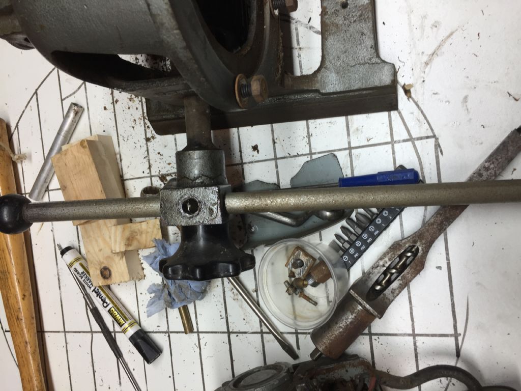

The knob is a left hand thread.
Do you know that for a fact Martin, or just speculation? If true, it would certainly explain a lot – I have actually moved the plastic knob a scant 1/16th of a turn by bashing and in my past experience (unless going the wrong way!) that's enough to free seized threads. I did wonder, but can't see any reason why it should be LH other than perversity on the part of the manufacturer?
Thanks for other suggestions.
Bazyle, you are quite right – the bar goes straight through and the threaded hole carries a locking screw, but the screw has a brass slug on the end so is unlikely to have raised a burr. I think it's just corroded in place. The saw-tooth union is clearly intended to separate to allow adjustment of the angular position of the bar when the plastic knob is undone.
Consensus seems to be a good soak in oil/solvent, followed by attack with more intelligently applied brute force (I like the chuck idea Ady1!) and heat so that's what I'll do . I'm not sure what the plastic knob is made from – Bakelite possibly, but It's tough stuff, and I remember Bakelite as being quite brittle. If it dissolves or decomposes it's not the end of the world – the machine isn't a museum piece, I can probably make a functional replacement, my concern is to get it working.
