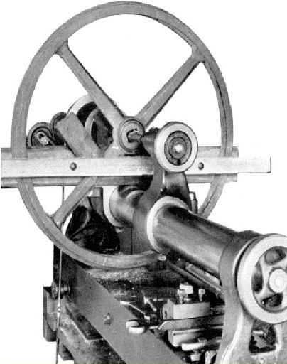

                • If you do have a mill then the size of object you want to bore is virtually limitless
                • V bed lathes can be limited for method 2 compared to a gap bed lathe
                • T slotted boring tables are not always provided on smaller lathes making method 3 difficult, even though it would be most useful on these machines (but see Neil's article on mini lathe abuse!!)
                But there is usuallydrummond.jpg a way as this image from an old Drummond catalogue shows!! (Method 3 taken to an extreme)
                Edited By Nick Clarke 3 on 14/07/2019 10:37:31
