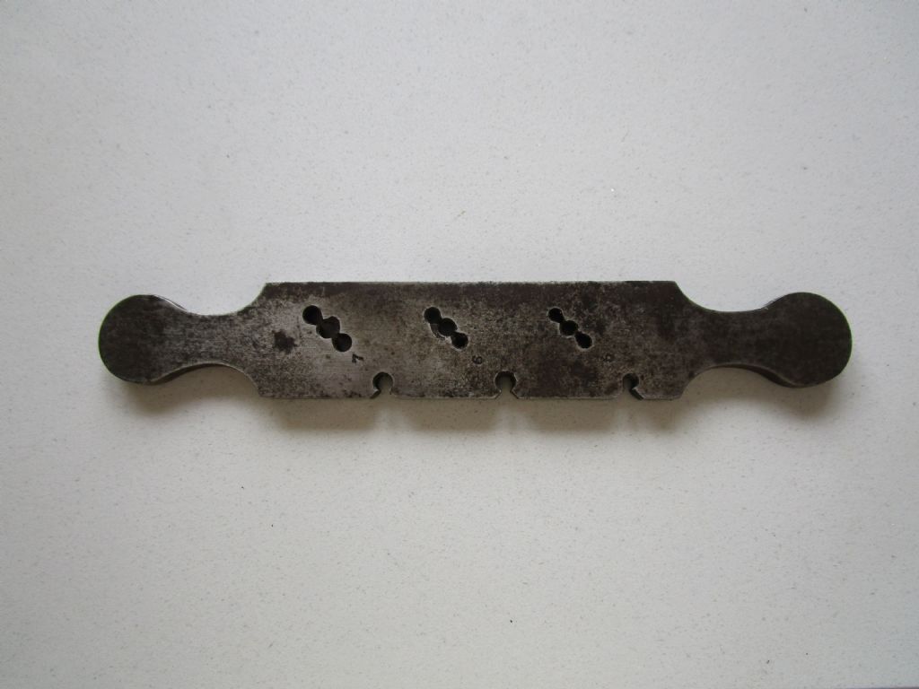

                    Here is a picture of one type of threading plate. This has holes in the centre and also partial holes at one edge.
                    I don't know what the threads are, and never bothered to find out.

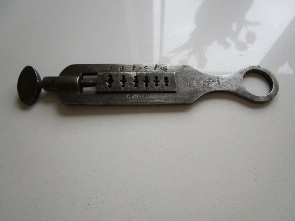

                    Not exactly a plate but a different type of threading tool is the next one, which is adjustable, Whitworth and made in Germany.
                    It cuts from 1/16 Whit to 1/4 Whit.

                      Thank you Howard,
                      Please excuse me for being a bit dim, but I couldn't find how to access pages on the Ausie website.
                      Thank you Brian H,
                      It looks like it's basically a die with a built in stock. Next stupid question. How were the internal threads cut in the die plate?

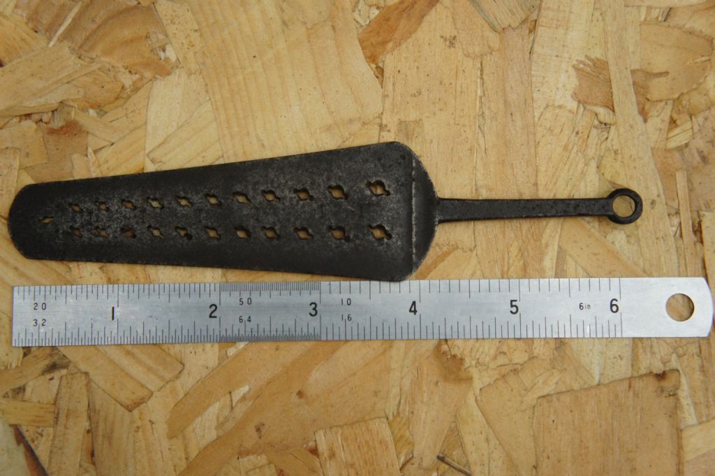

                        Interesting thread….
                        I have never seen any die plates like those, all of mine are of the "trowel" type…..found three yeaterday while rearranging the clock club workshop for post virus activity.
                        I have a 70's reprint of a gunsmithing manual, undated but obviously originally printed in the hera of the percussion lock,…so, about 1830, which mentions taps and dies but also the need for a "plate and ten taps for English and German nipples"…..
                        #491450
                        Bob Stevenson
                          @bobstevenson13909

                            Quote: It looks like it's basically a die with a built in stock. Next stupid question. How were the internal threads cut in the die plate?
                            Not a stupid question at all but I would imagine that the holes are drilled and tapped as normal, then plugged with short lengths of thread and then the 2 small holes put in to produce the cutting edges followed by hardening and tempering.
                            I say that the holes would be plugged because otherwise the drill would just run off.
                            It's a good way to make your own die if you only have a tap.
                            Brian

                                    Bob Stevenson's picture is almost the same as the device shown to me, apart from the mine had a "blob" on the end of the handle instead of a ring.
